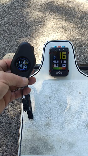

I bought a usplit to do just this and with the Bluetooth module and remote connected the tilt seems to not want to go full throttle… only tilts minimally and the remote shows the wrong voltage when connected to usplit as well and jumps around… I’ll try and rip it apart this weekend and get a video to show
Its is very interesting that the voltage jumps around. That sounds like the data from a different message is getting forwarded to the remote than the one it is expecting. That could only happen if the IDs are the same but the data is different so my guess is the selective COMM_GET_VALUES request is used by both devices and the responses are getting misdirected.
Can you try plugging only the remote into the uSplit? Then only the bluetooth module? That will tell me which issue is caused by the uSplit alone vs the interaction of the packets sent / received by the devices.
Also, can you tell me which bluetooth module your using?
