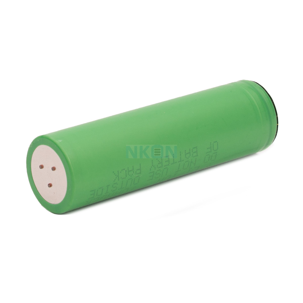

Cell two’s tear at the top exposes the the cathode, quite scary.
Idk what nkon were thinking those cells have a lot of added risk.

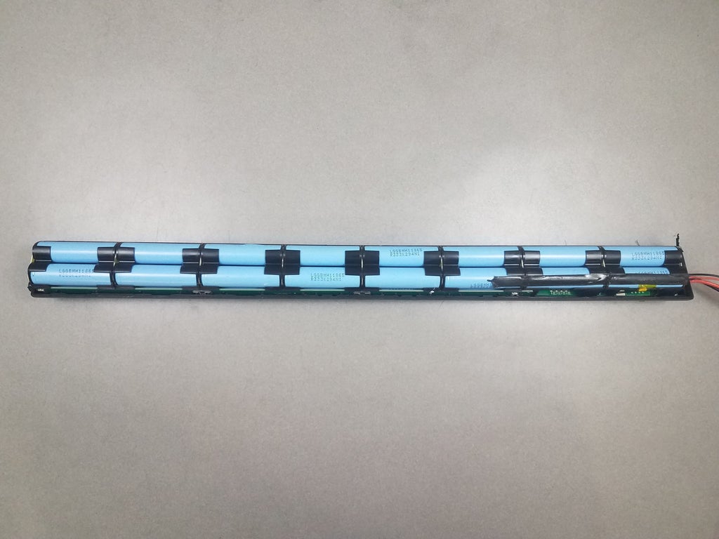

I purchased 9 of these and stripped out the cells.
It was a lot of work to pull them out and rewrap them all.
Then I did a capacity test on all 240+ cells.
It took forever but in the end I had a huge pile of good cells for about $.75 each.
I ended up with a very solid 72v 36ah triangle pack that is currently powering one of my ebikes.
I couldn’t guess at the time I put into cleaning and testing all the cells.
But the good cells for that cheap in the end made it worth it to me.

I’m considering these cells - I have a decent offer for them. Now I’m wondering the proper process:
  • should I polish the old weld remainings flat? any safety advice?
  • the black insulation - can I leave it or should I replace it with fishpaper circles? Or should I put fishpaper circles on top of that black insulation?
  • how should I test all cells? To put the at the same voltage, that’s for sure, but what else? Capacity?
This will be my first battery pack so I want to be sure with every step.
Yes
Use a dremel with sanding / cutting bit and VERY light pressure
Or hand file, but that is very annoying
Personally I have no idea what that black stuff is, I’d probably just put rings on top if it’s not too thick

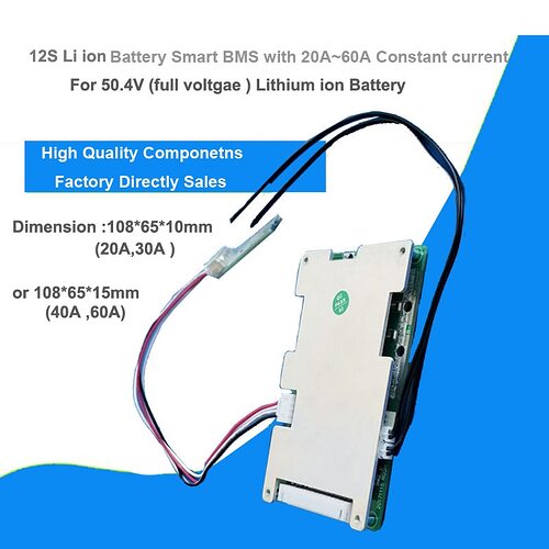

Last thing concerning the BMS - I have realized I want to bypass discharge. I see most builders do so, moreover, high-amp BMSes are pricey. So - what other BMS parameters should I look into? I have no pressure for a quick charge, it can be slow for me.
For example, would this one do the job? (12s 20A)
And in consequence, how to choose the proper charger for it?

That and/or a dumb daly is what most people here use. I’d recommend ordering from their own webbsite though (www.lithiumbatterypcb.com). For a charger just search for any 12s charger on ali, thats the cheapest (and slowest, the cheap ones charge only with 2A or something) option.
I’ve stumbled upon this website, but there I only see … 10S 13S… no 12S at all(for li-ion)? Or am I blind?
This should be it.
