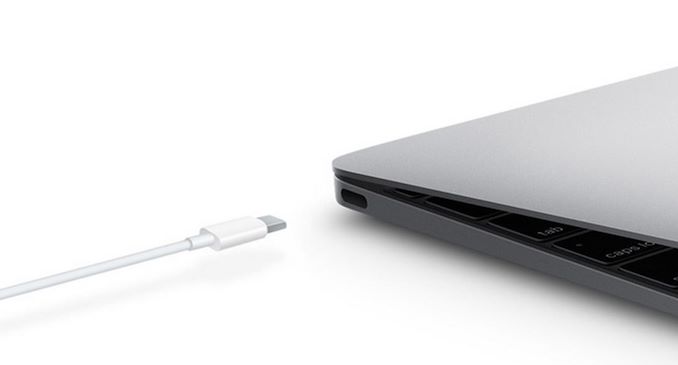

USB-C for charging

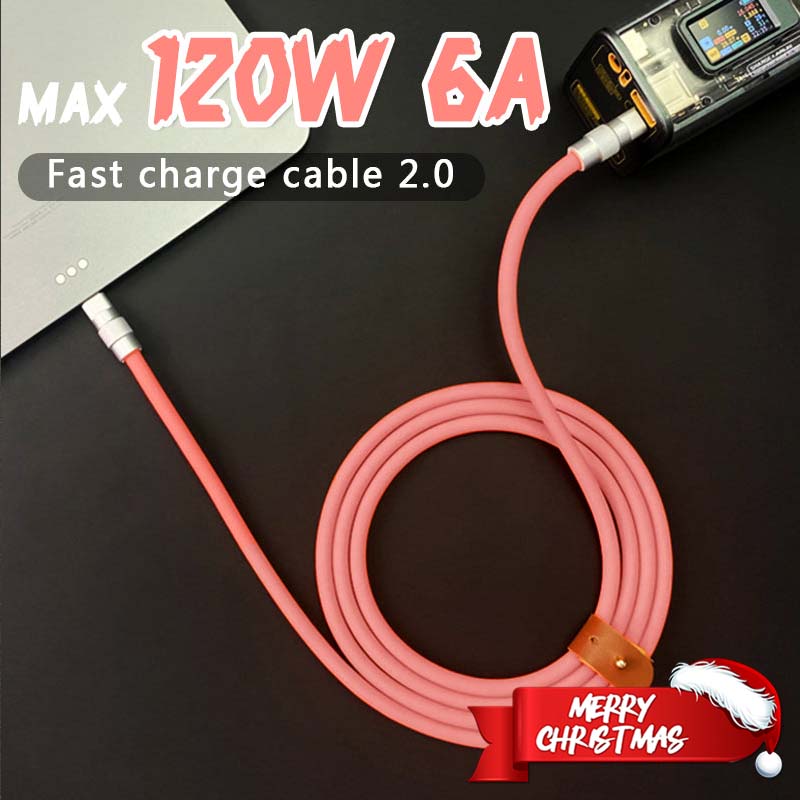

Would a cable like this help?
Help with what?
We aren’t really limited by the cable here, there are plenty of cables capable of carrying all that USB PD has to offer
This cable can do 6 amps. I guess their are other cables out there that can do the same thing.
In this case it’s about watts not amps.
Let’s say a hypothetical wire can safely carry 5 amps at 5 volts.
Breaking out the old p=vi gives 25watts.
To a point that same wire will happily do 5 amps at 10 volts so 50 watts.
But if you try and shove 10 amps through it at 5 volts it will get unhappy and burn up even though it’s only 50 watts which in the previous example it was fine with.
This is effectively how fast charging and EPR (the link I posted) get more power(watts) through the same wire safely)
EPR boosts the max voltage of the power delivery spec to 48 volts which at 5 amps is 240watts.
**Please correct me if I’m wrong. It’s been a long time since I decided that coding was better than that scary electromagnetics class and I bailed on the ee degree.
