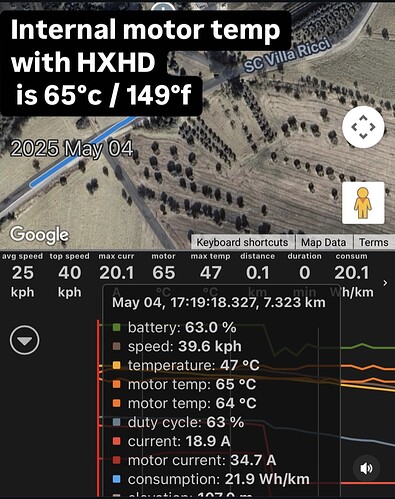

              Oh yeah, saw this during esk8con. How was your temps during it?
              I was trying to use the new megan with metr app and wasn’t able to record any temps there. As soon as i get my batteries and charger i will go to a track with the voyage app.
But i stayed under 55°c  from what i was able to see on my display during the races. On my Apex mountain board and vesc based Bajaboard I see a consistent 6°c improvement, for my riding style and environment.
