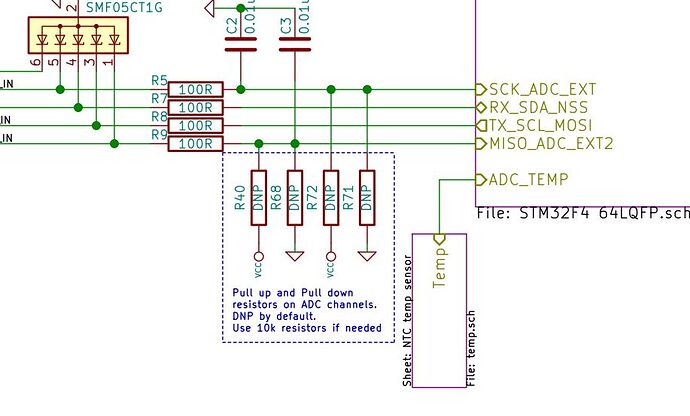

By the way, here’s the part of the schematic from the v0.9 board that covers the pull-up and pull-down resistors. It suggests 10K resistors. We used 11K (probably the closest thing I was able to find on Ebay). But I worry that 2K will be a pretty stiff pull-down.

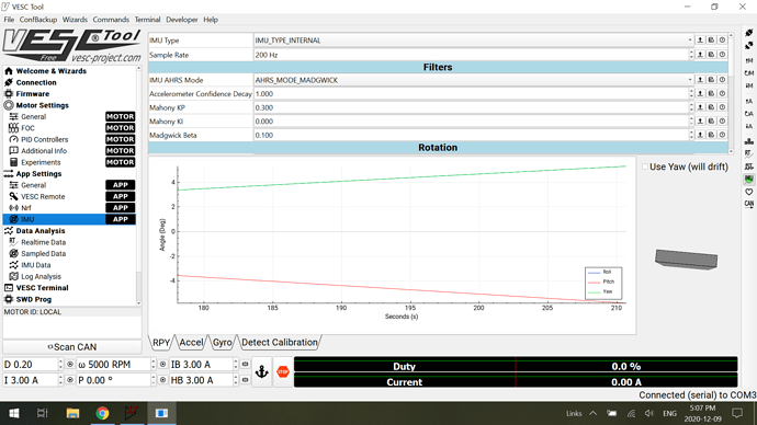

I have been connecting to the VESC turning the app config to no app.
On the IMU page I select internal IMU. And then after writing the config I turn on imu sampling on the right hand side.

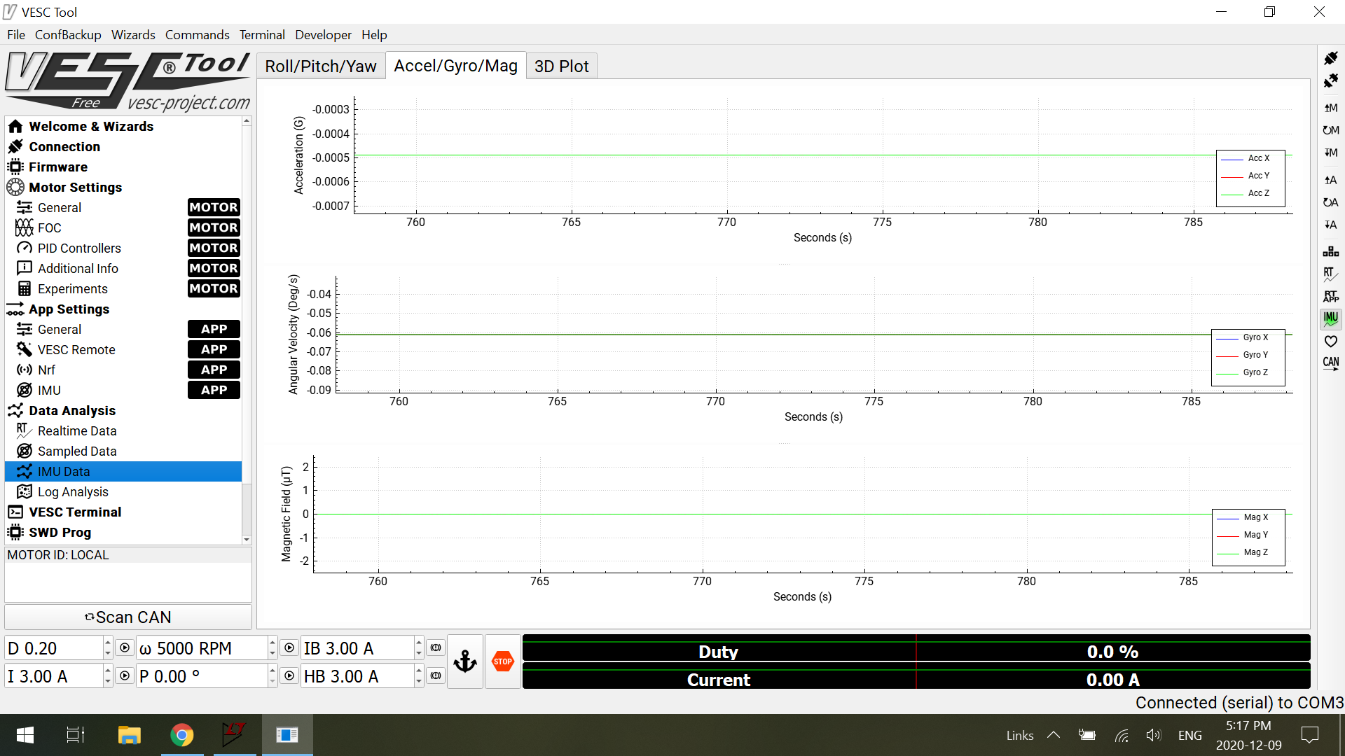

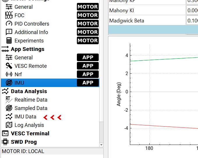

Can you try clicking on the “IMU Data” button here?
Pretty much the same thing.

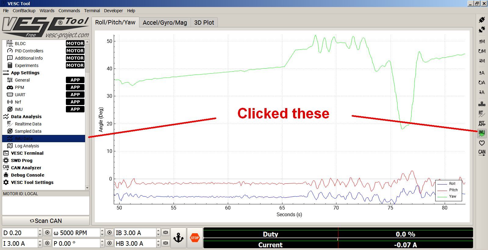

OK, I just tested an IMU on one of my v0.9 boards. I plugged the CFOC2 into the laptop via the USB cable. Powered the CFOC2. Clicked “Connect” in the app, and then clicked the two buttons shown below. I see yaw, pitch, and roll values streaming when I do that. If you’re doing the same thing and not seeing values streaming, I guess the IMU is not working. I hope it’s not a problem with V1.0 vs. V0.9. Do we know if anyone has built a V1.0 and used the IMU?

How critical are the values for the pulldown resistors?
Typically pull-up and pull-down resistor values are not very critical. It’s common to use 10k to 20k ohm. The schematic for v0.9 calls for 10K. I installed a couple of 11K resistors for him, but then the USPS disposed of his package. :frowning:
He mentioned 2K, but I suspect that might have been a typo. Jonathon, did you want 2K resistors for some reason?
