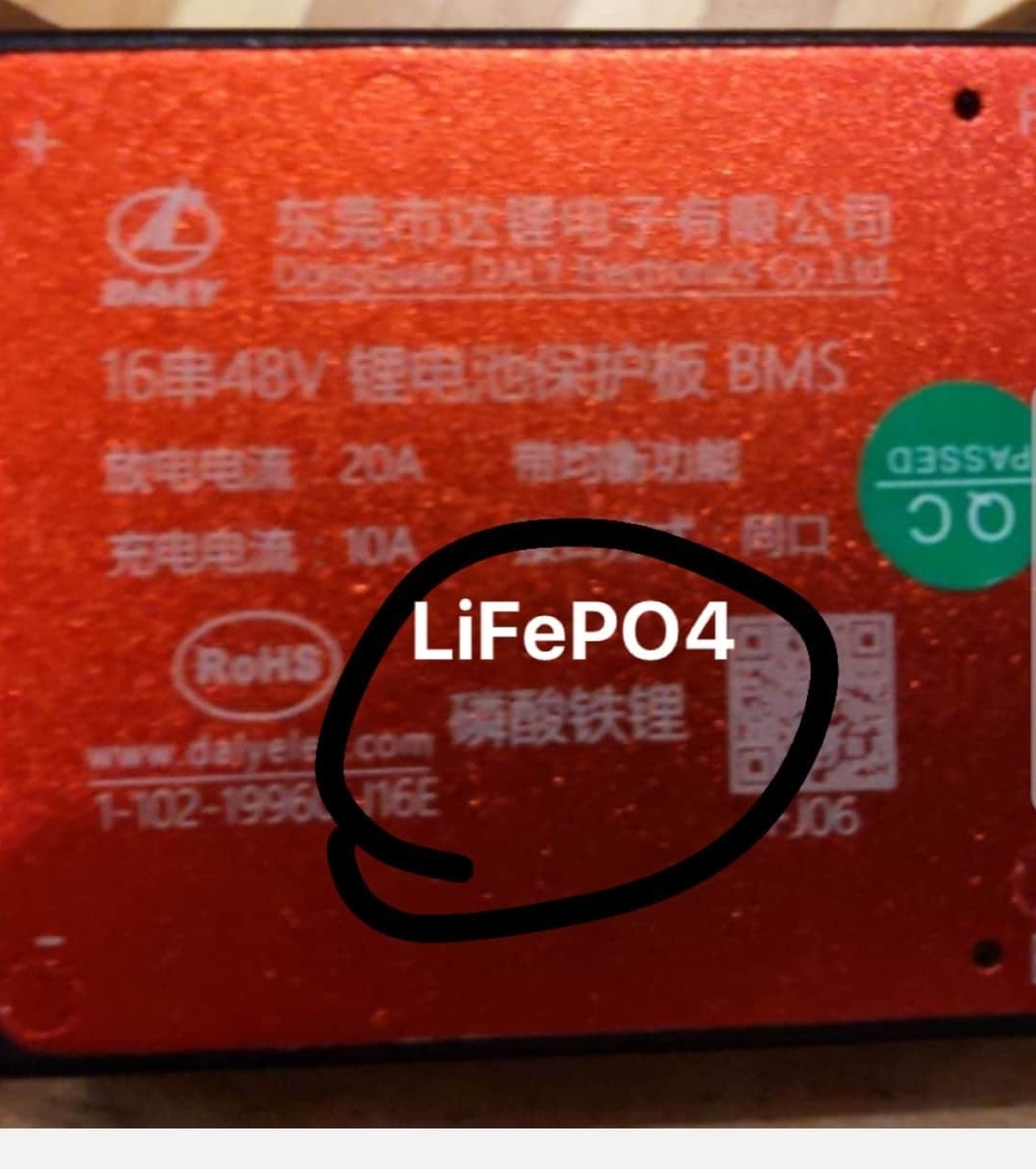

Out of the many dozens of Daly 10s, 12s, 13s,. And 16s I’ve imported in the last months, I just received a batch of 16s BMS and failed to realize they were liFePo4 3.6v max.
Do not plug in or use if you have lithium ion cells and charger. You will let the smoke out :grimacing:
All other BMS I have are perfectly safe.
Look for these Chinese symbols below
Reach out to me asap. 415 341 2281. Immediate refunds and I’ll come up with a plan b to get your project back on track

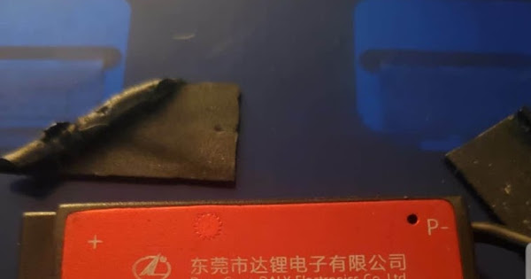

Only 3 went out so far. Only one person received. I tested on my bench and let the smoke out.

I’m for transparency. A good public service announcement. Cause i don’t read Chinese. Now I know what to look for.

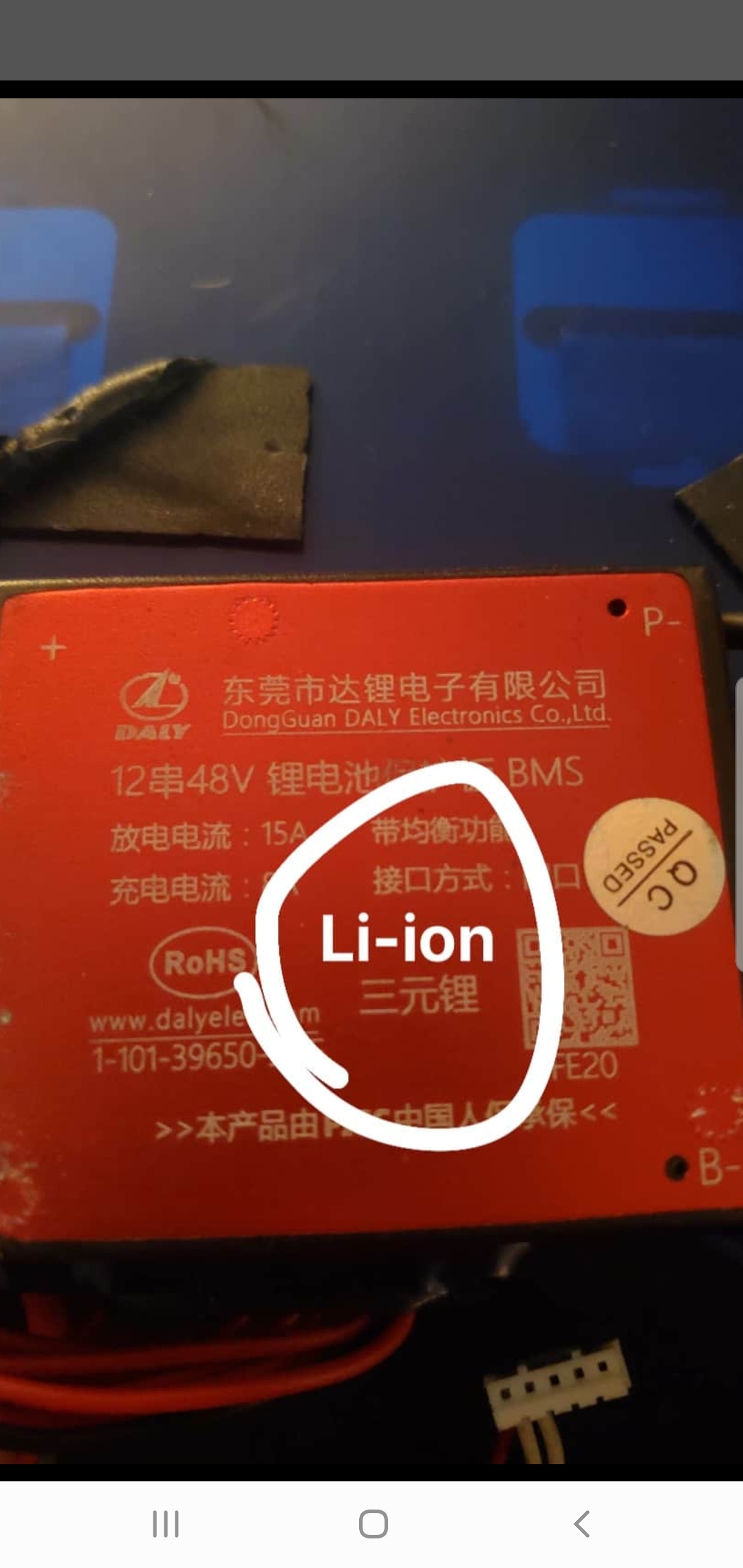

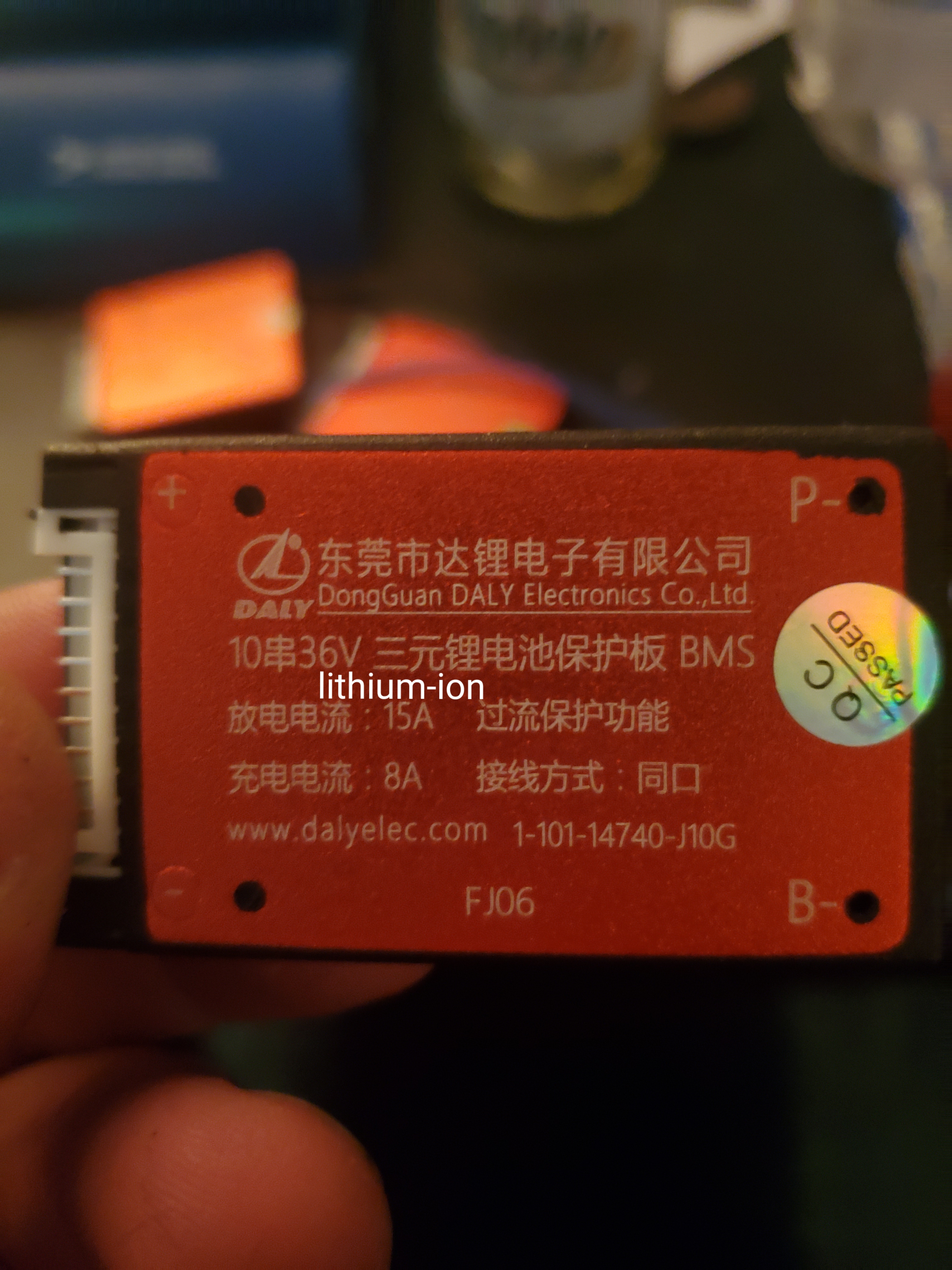

technically 鋰離子 is the correct word for Lithium-ion, but in china they call it 三元鋰 for whatever reason.
磷酸鐵鋰 = LiFePO4, that one they got it right

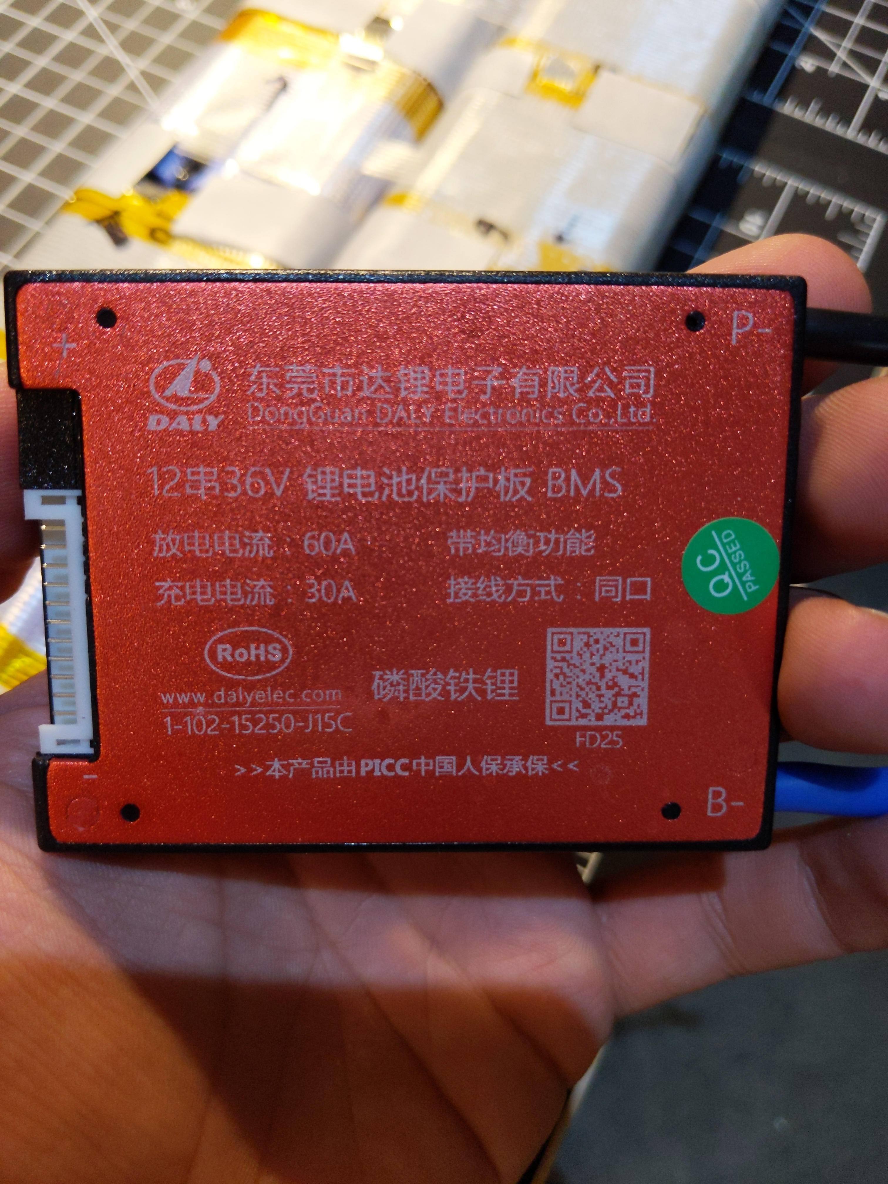

Okay so I have this 12s Daly that has the same Chinese writing as your 16s LiFePo4 Daly. The AliExpress listing says Li-ion as well as LiFePo.
