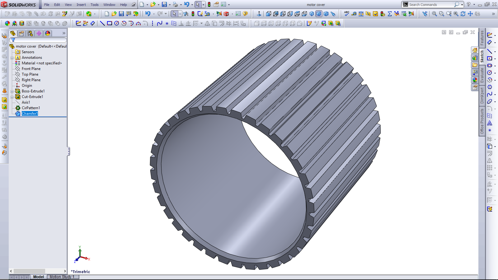

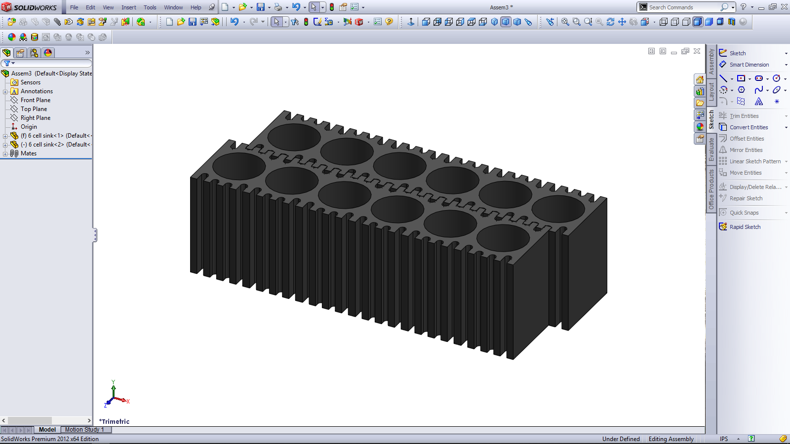

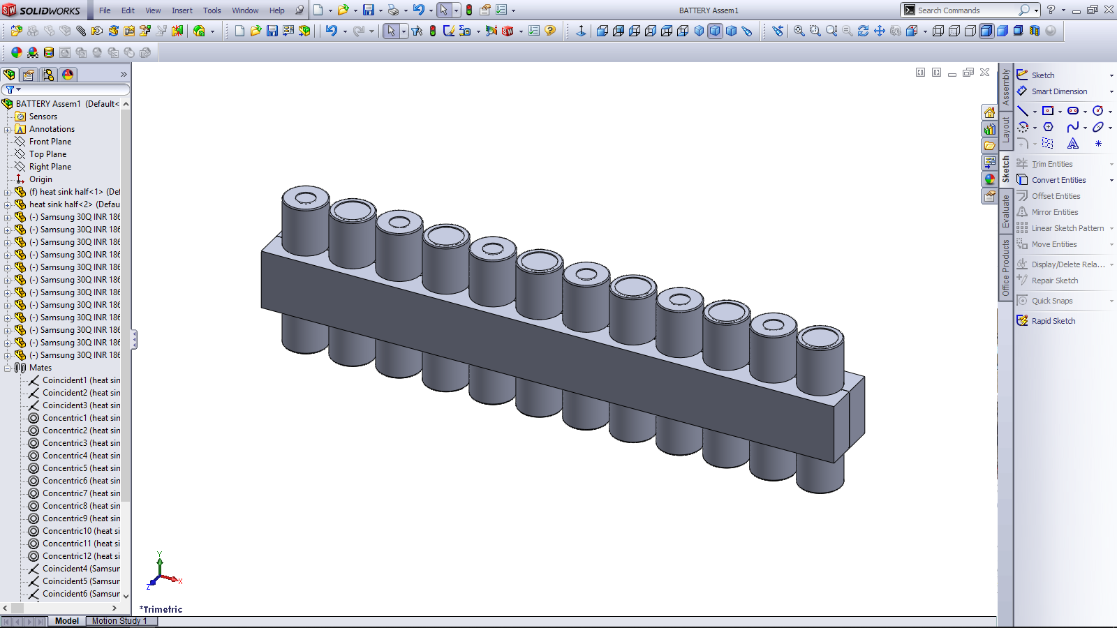

RipTide Sports has come up with a way to make Urethane conduct heat without conducting electricity. The compound is almost as heat efficient as Aluminum at half the weight and can be molded! We are looking for applications, any ideas? A couple of concepts we are considering are outrunner and direct drive sleeves to protect and bleed heat off the motor and battery holders. Conceptual photos are shown.
This is pretty cool
Heat conductive UT? Astonishing great esk8 applications. Your doorbell should get broken soon
Would normal UT used in direct drive sleeves mold to it without epoxy & shore? I.e. mold this as a sleeve then a thinner typical UT mix overlaid?
I can mold a wide variety of durometers and i think a interference fit of 1 to 2 mm will be adequate to keep it in place so finding the right duro may be the key

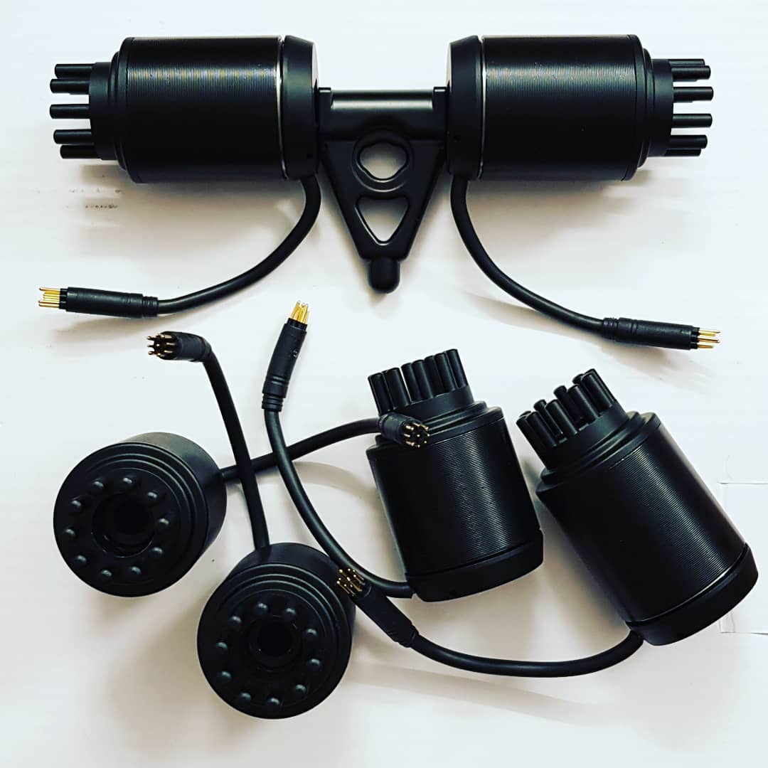

Only advantage of that application is on hub motors, not sure Brian uses them. No point of having cool belt driven wheels…
Cheap chinese hubs are not really relevant given their lower power and general crapness,what’s the point
Best aftermarket and relevant application of hub motors is on
- Hummies
- R-SPEC DRIVE KIT
^ that is what you make
CoolThane™
Edit. What I am I talking about?

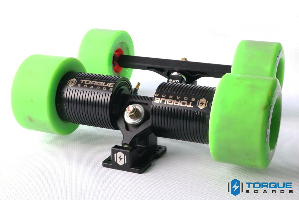

Not sure how to improve heat rating on hub which mount the wheel to end of the motor such as the TB or Swissboards or Elofty ones, presumably no advantage to the alum motor bell on a kit like this
Plus would have concerns over the ability to deflect any knocks or bangs and not have the whole unit come blow apart
There seems to be a general movement towards hub motors having the wheel on the end rather than over the bells, I’m guessing a lot has to do with getting the heat out of the motors. The problem with this is that the total width of the axle gets longer which means a much wider turning circle
So this application has legs, I’m guessing there is some R Spec owners who would love to have cooler ergo more efficient motors
