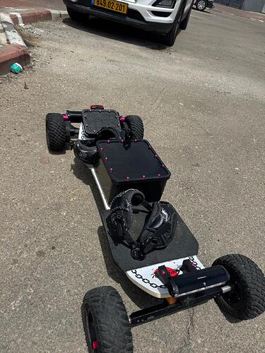

I’m currently building a 16S DIY mountainboard and considering a motor upgrade. Before I buy, I wanted to get your thoughts on making the jump from my current 6384 motors to the Flipsky 63100 140KV (with the 10mm D-shaft).
My Setup:
Battery: 16S4P EVE 40Q with Smart BMS [cite: User Correction Ledger: The user corrected the model’s general designation of their electric skateboard battery cells, specifying the precise use of high-discharge EVE 40Q cells., Dated Events, Projects & Plans: The user built a custom 16S4P lithium-ion battery pack with a smart BMS for their electric skateboard, later preparing it for long-term storage balancing.]
  • ESC: MakerX Go FOC D100S (200A total phase current / 100A per motor) [cite: Description: The user participates in DIY electric rideables, specifically designing, assembling, and maintaining a high-performance custom electric mountainboard., Evidence: The user outlined a complete hardware profile including an MBS deck, custom Matrix trucks, Newbee tires, and a MakerX VESC controller system. Conversation Date: 2026-06.]
  • Current Motors: 6384 140KV
I know Flipsky rates the 63100 up to 14S, but since the 140KV variant keeps the ERPM safely within the VESC’s limits at 67.2V, I plan to run them on 16S.
A few quick questions:
  1. Performance: How much of a real-world difference will I feel moving from 6384 to 63100 on 16S? Is the extra torque and better heat dissipation noticeable?
  2. 16S Reliability: Has anyone run these specific 140KV motors on 16S long-term? Any issues with heat or magnets?
  3. Battle Hardening: Do they hold up fine out of the box, or should I open them up and apply epoxy/loctite before the first ride?
Thanks for the help!

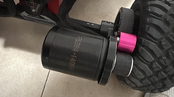

How hot are your 6384 motors during operation?
I haven’t had the chance to check the exact temperatures in the app log yet, but touching them by hand right after riding, they just feel warm to the touch. I’ve never felt them getting burning hot.
If they don’t get too hot, there’s no need to upgrade the 63100 motors.
That’s a fair point, but I’m looking into the 63100s mainly for the torque upgrade and to fully utilize the capacity of the MakerX D100S. With 100A phase current per motor available, I feel like the larger stator and longer magnets in the 63100 will translate that power into much harder acceleration and better low-end punch, especially on a mountainboard setup.

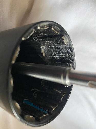

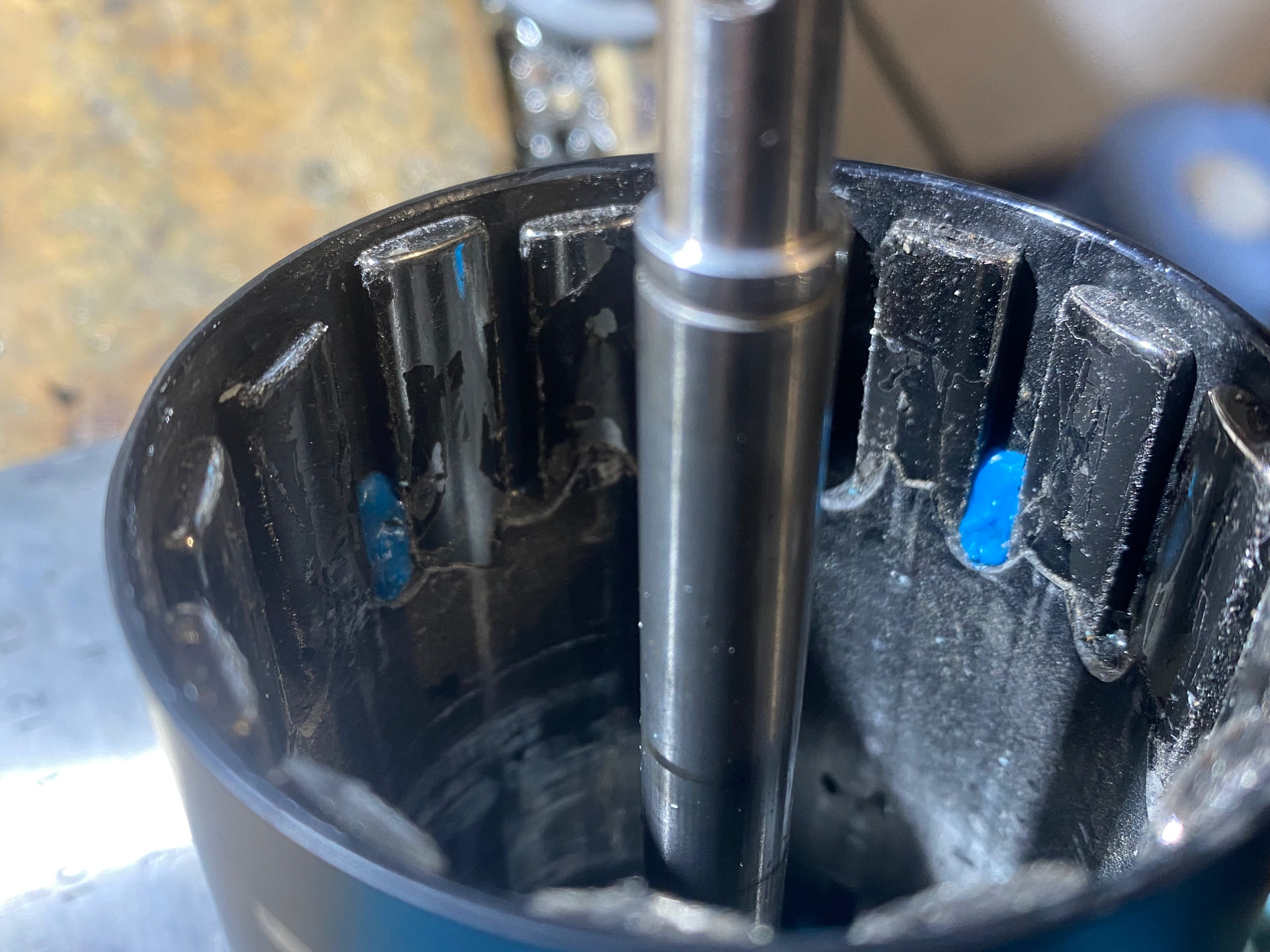

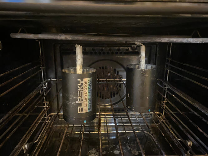

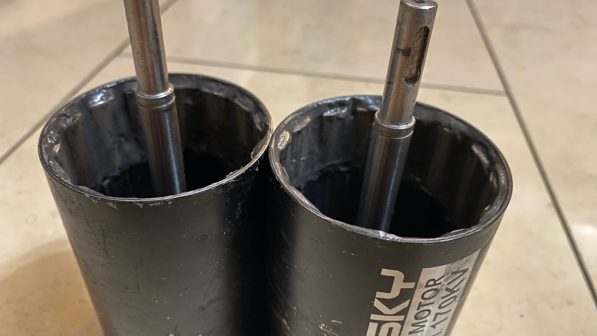

They are very prone to breaking magnets if the magnets aren’t fully battle hardened.
One snapped a magnet just above where the battle hardening stops. I used araldite 2014 and baked in the oven and it has been fine, proof to 150A per. edit I recommend battle hardening the top 1/3rd of magnets
Now it could be just because mine are damaged, but I had oscillation issues at like 70% rpm. They would actually shake so hard at one exact speed it would brake hard. I found out which side the can was off centre, squeezed with vice grips, tighten motor mount brace and it’s noisy at that speed but not catastrophic.
I think it’s worth upgrading from 6384 to 6300 with Flipsky for the heat dissipation alone. I can’t get back up the second half of our usual ride without overheating their 6384s and having to stop to cool down. Using the 100s eliminated that. Like @CarelessAquarist said though, the magnets can break. I know they can on any motor but I’ve broken a lot of the Flipsky 63100 ones. Another option would be to just get Radium or SKP 6485s. They cost a little more but breaking Flipsky motors was at least once a year for me and the better quality motors from Radium and SKP really are saving me a bit of cash in the long run. They’re also rated to run hotter. I’d probably pick them over Flipsky 63100 if budget allows.

Did you buy the official “Battle Hardened” version from Flipsky and the magnets still failed, or was it their standard non-hardened version? I’ll definitely make sure to check the magnet insulation and maybe add some extra epoxy before mounting them. Thanks man!
Yes I think I got the battle hardened ones but the magnets aren’t fully done.
It’s likely they are now fully battle hardening but
this is what mine were like

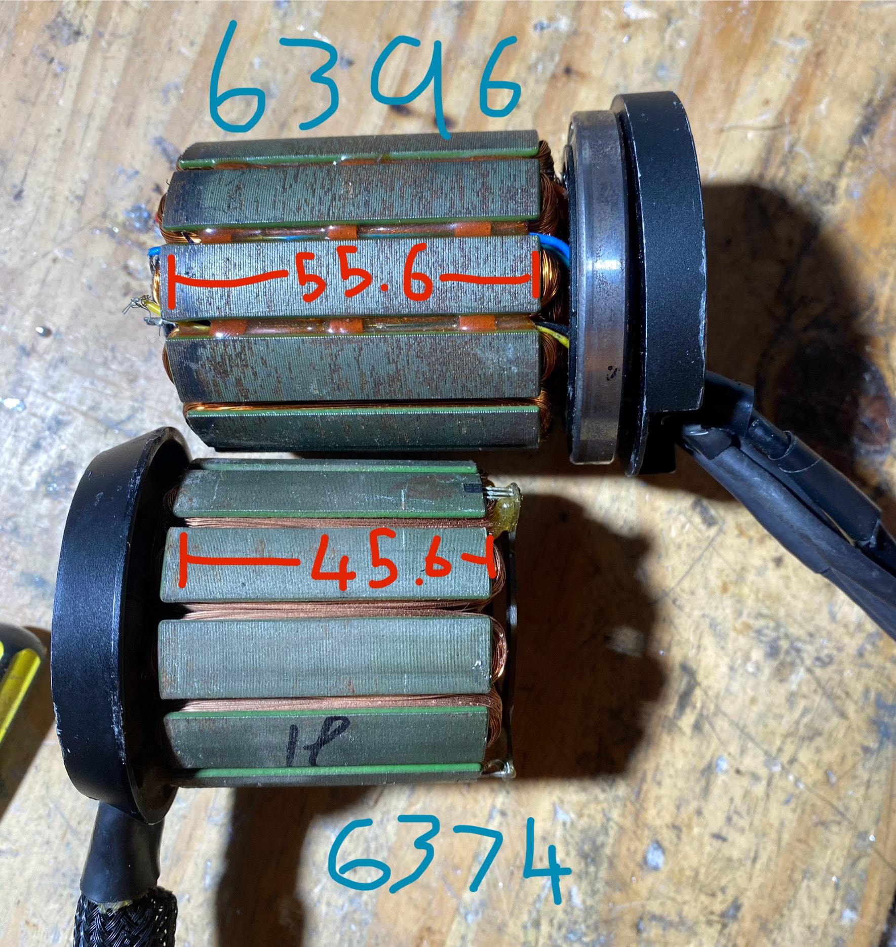

Also you can choose a custom kv for not extra cost so you could do like 155kv or something if it suits you better.

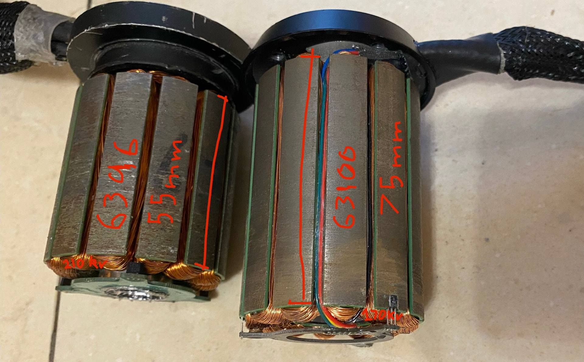

Here is a size comparison of what you actually get inside the motor, and I presume 6384 is 10mm more than 6374 so same as 6396.

To answer your question, changing the size of your motors will not change the torque/power of your build. The torque/power that a motor outputs is based on two things: motor current and the kv value of the motor. Replacing your 6384 motors with 63100 motors of the same kv value, and giving them the same motor current, will produce an identical power output.
If your existing motors are not getting more than warm, you can most likely safely increase your motor current (as long as your ESC can handle it) and get a torque increase for free.

Did you guys notice the custom stomp pads on this build? Love the DWIII deck but I’m getting older and my feet hurt sometimes. This looks like an amazing QOL upgrade.
Printing stomp pads with TPU is cool cos you can tweak the cush with the print settings
Gyroid infill around 20% feels nice, but my printer plate is too small so the pads aren’t wide enough to fit my entire foot. @nehoray123 was kind enough to share the files, just need to upgrade to a better printer.
