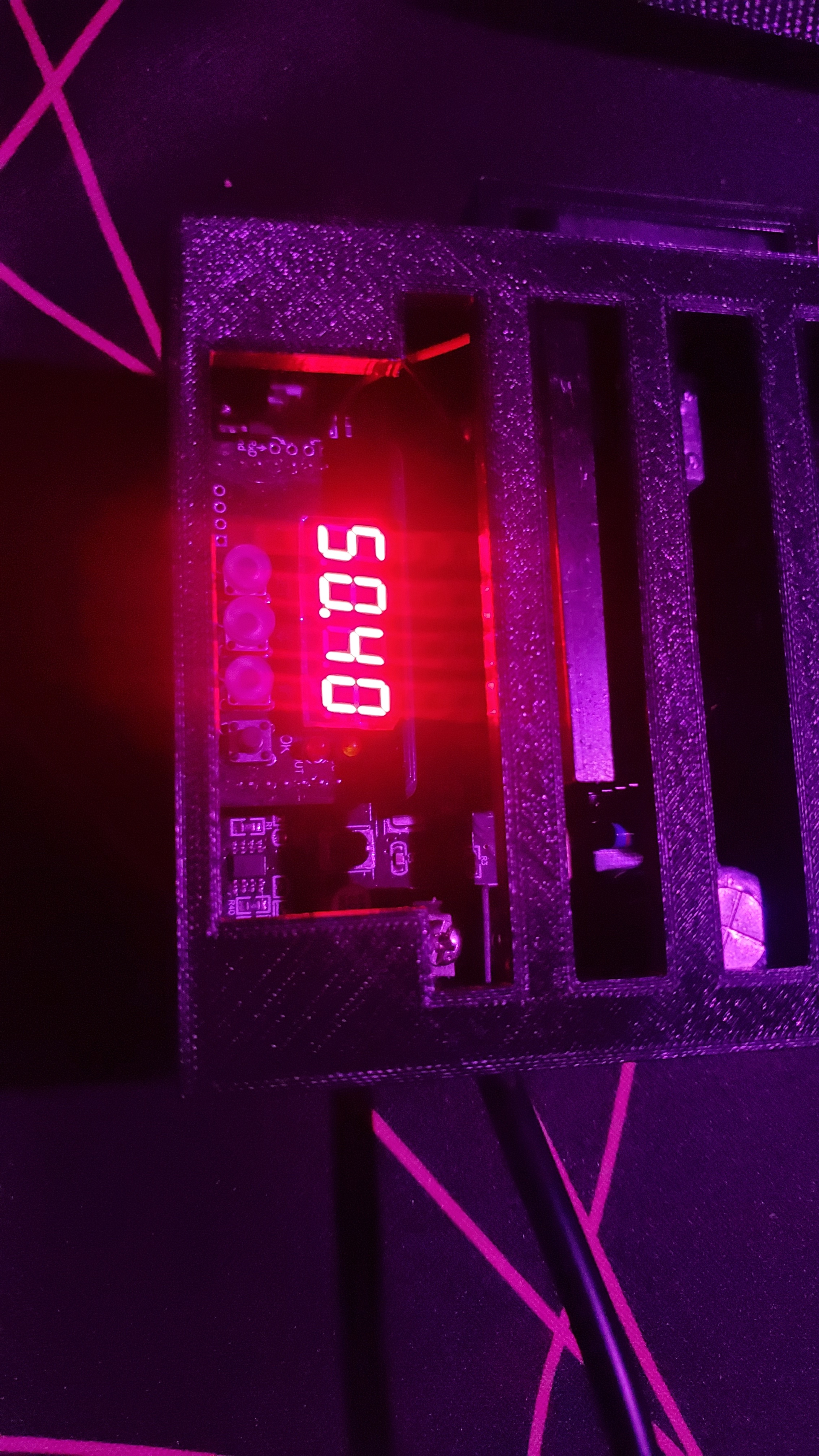

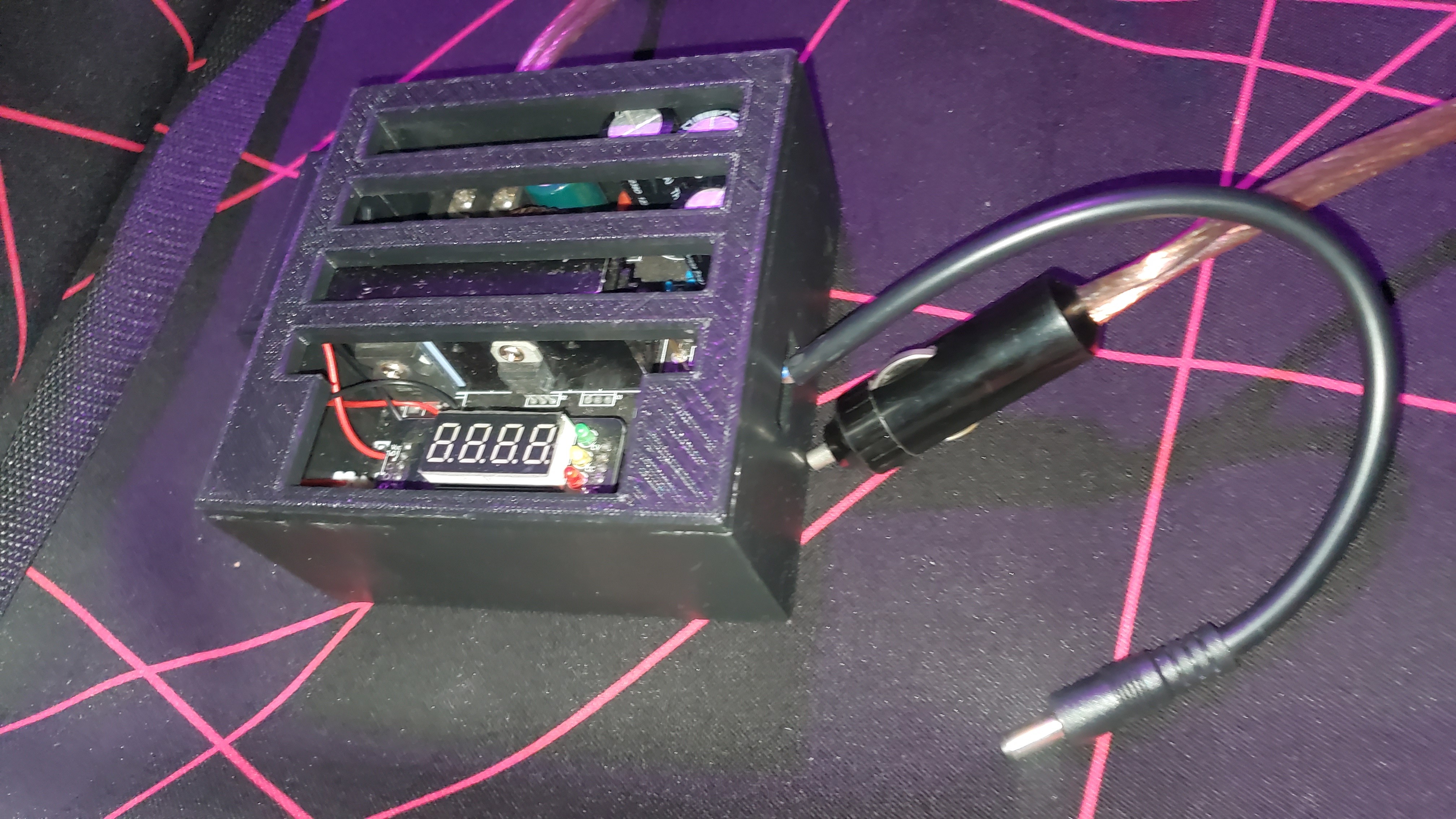

Boost converter that can take 12v car power and push it to whatever s your battery is. CV/CC, set your voltage and charge current and off you go.
Screw terminals on the unit, grab a cigarette plug off amazon and whatever charge plug your shit uses, solder some wires or nah.
I’ve been using it for about a year now, can push about 3-4 amps to 10s 42v and 2-3a to 12s 50.4.
Top off your board on the way to a group ride or shock your nipples in the car, very useful.
*Can draw max 15A from the input side so shouldn’t pop any fuses but I’m not responsible if it does.
**PM for the STL for that 3D print enclosure or make your own, its square.

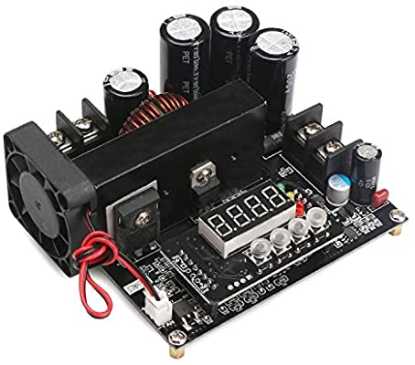

ayy my BST-900W got here a couple days ago!
$26.96 on ebay after tax with 4 day shipping.
I’m very excited to see all the things I can do with it.

How hot does it get? i boosted to 42v 5a from a 5s lipo once and my boost unit got so hot it melted itself… or I had a dud idk

You get more power from this because less conversion = more efficient. And compact.
i think people do it straight with a boost so that you’re not converting to 110/240v and then back down to 42v. the losses there are quite big

It has a built in fan, I’ve pushed it until it couldn’t sustain the voltage I set it to. It gets really warm but never shut down or even affected my PLA enclosure. Screams like a banshee though when its at full power.

This is the model, same amazon seller in fact that all the Onewheelers I know get for charge and ride.
They put it in a small plastic case but have to cut a vent hole for the fan or it will overheat. I leaned this the other day when we were talking about waterproofing one of these for use in the rain.
Fuses n crap. Most 12v ports are fused to 15, if the inverter is wired directly to battery then you can draw more, but that’s a hardwire solution, where as this thing pulls the maximum 12v 15A from any cigarette jack with minimum loss.
I just got mine today. So far it works great with my 10-14.5V shop power supply and a 19V 6.5 A laptop power supply.
