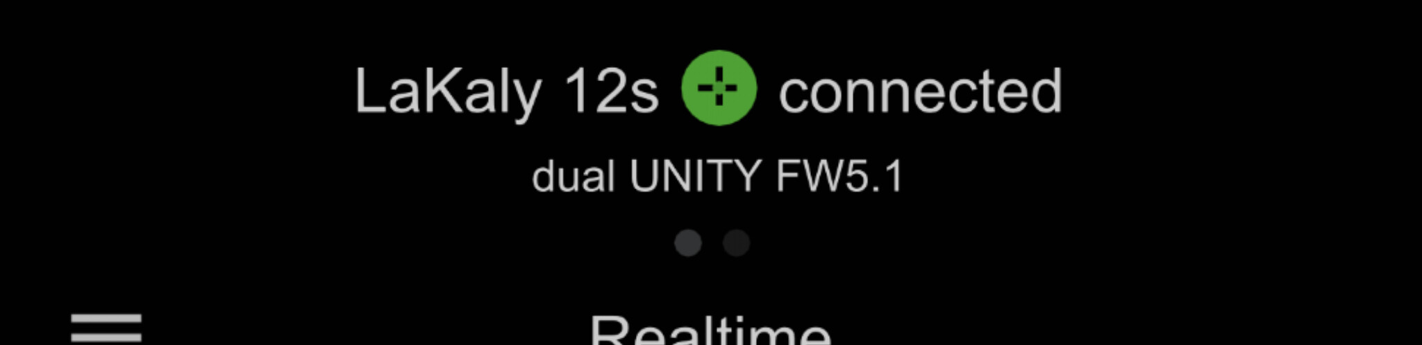

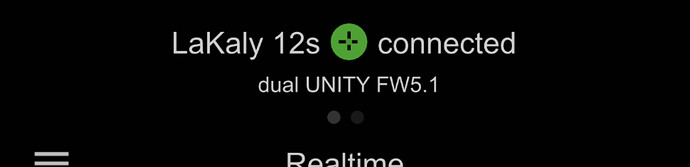

Unity with master side bad detection
I think it wasnt always this bad actually, i just uploaded this video and noticrd that it worked better, not good at all still but i think it was better?
Im having this exact same issue with two Trampa VESC6 MK3’s that are known-good. I just updated them from fw4.2, where they were working perfectly, to fw5.2, where I am now getting issues detecting the proper motor values and sensors.
I have also now heard from a previous customer that his Xenith is having the same issue.
I think it’s a problem with FW5. I will be doing more testing on my setup to try to figure it out.
This could very well be true,because that film was them running on unity firmware i think
I can confirm that the customer of mine had his issues resolved entirely by switching to using the Unity app and firmware.
@Trampa, I think we found a bug.
5.1 unity has been flawless for me. I think the issue may be 5.2. But I have no clue.
