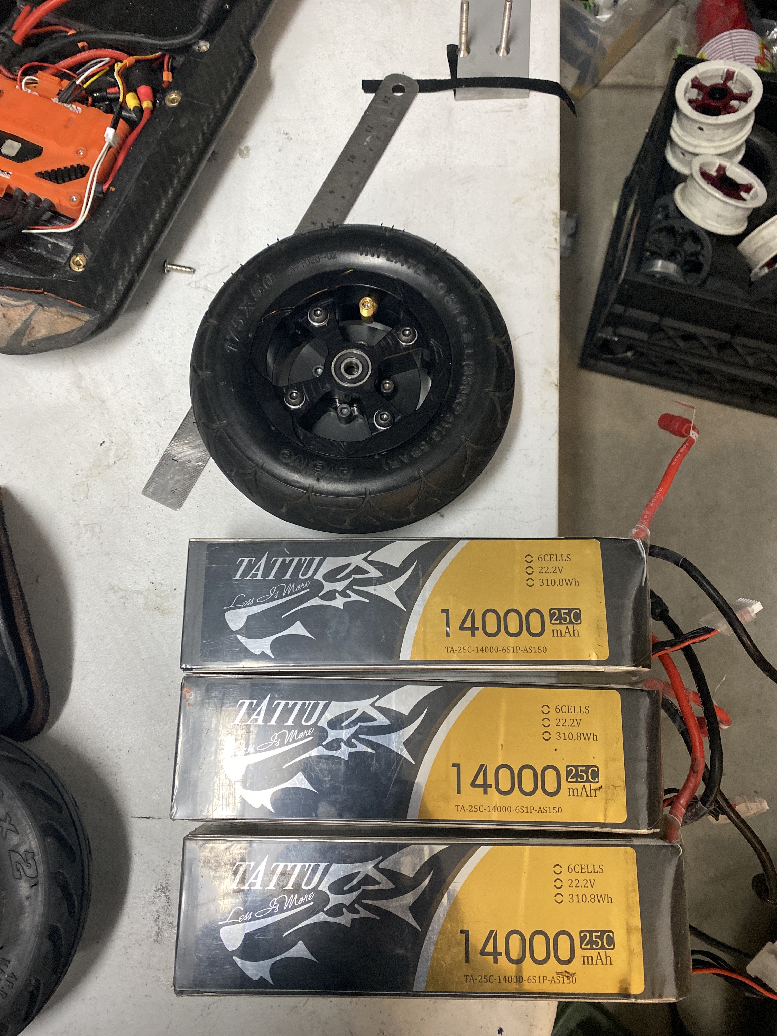

My wishlist? @blasto, especially @Deodand,
  • I would like to run 18s,
    -dual unity-replacement in 48 hours at Barrett Junction. It’s just 30 miles from San Diego
  • and I already have a build that could fit the lipos with heatsink space for days. (13.5 x 14 x 3 mm) x 2
Also tomorrow is my birthday and I haven’t been fighting with cars, … lately. :grimacing:
