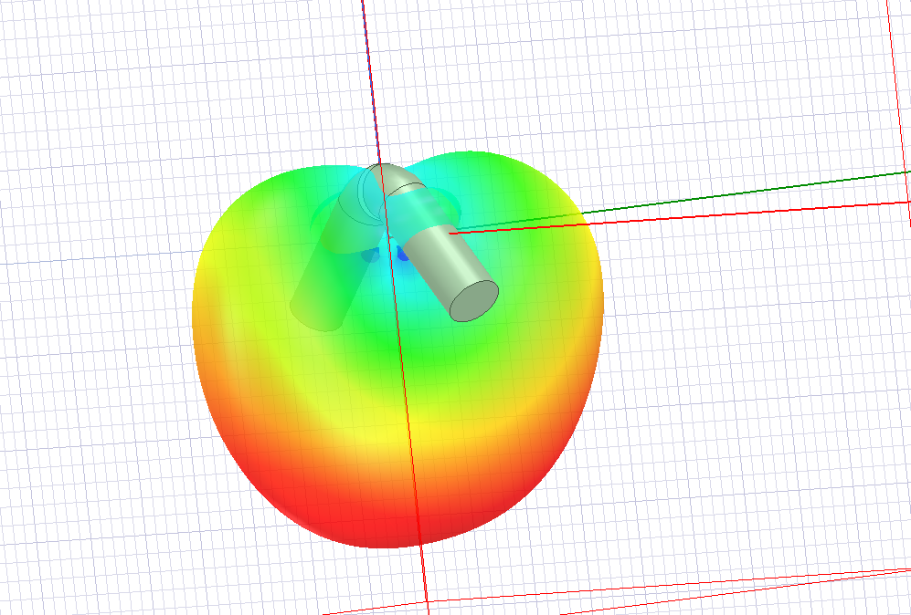

Lol, what the fuck do I know. Im not an antenna designer. let me ask my buddy. He makes antennas that go boom.
what’s the straight dipole radiation look like?
EDIT: this is entirely incorrect, the model is broken
UGH, you gonna make me model that too? lol
gimem a minut. I know its been done
Im guestimating the bend makes it more directional and reduces maximum gain
This is wrong but I left it here anyway
this is a dipol bent in half, roughly

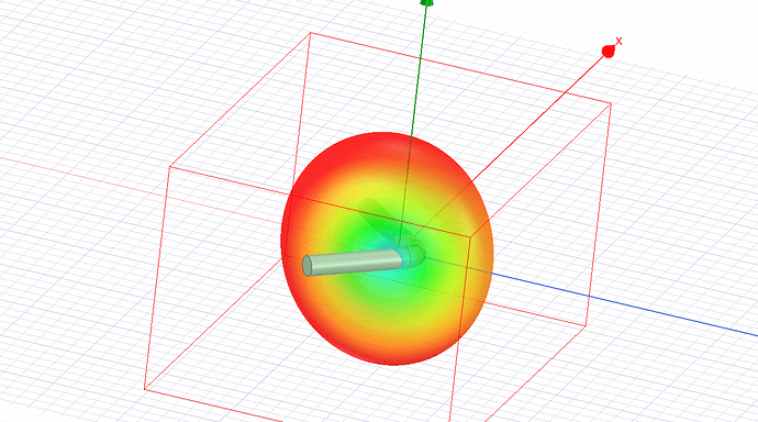

THis is right
here is dipol ( extends along Z)
that’s my shade-tree thoughts as well… is that modeling the radiation of a 1/4 wave or a 1/2 wave antenna length?
I just did 15.5 mm for each half of the Dipol. Figured that would more represent a bent Dipol
so let’s call it a “stock” antenna, but more directional and less gain… kinda like upping the power and 1/2ing the antenna length?

in laymans terms if your board receiver antenna is aligned north/south your remote antenna should be aligned east/west for maximum performance
Well then you were right about them being perpendicular.

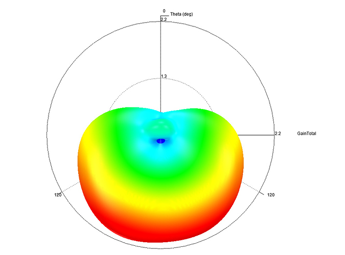

Im running the propper sim now.
I used an old setup for a patch antenna, so nothing matched.
Ultimately it is slightly more directional. But in order to compair actual gain, I would need to straighten this model and I dont have time for that lol
My guess is the maximum gain is also down. so its probably just a shitty bipol lol
