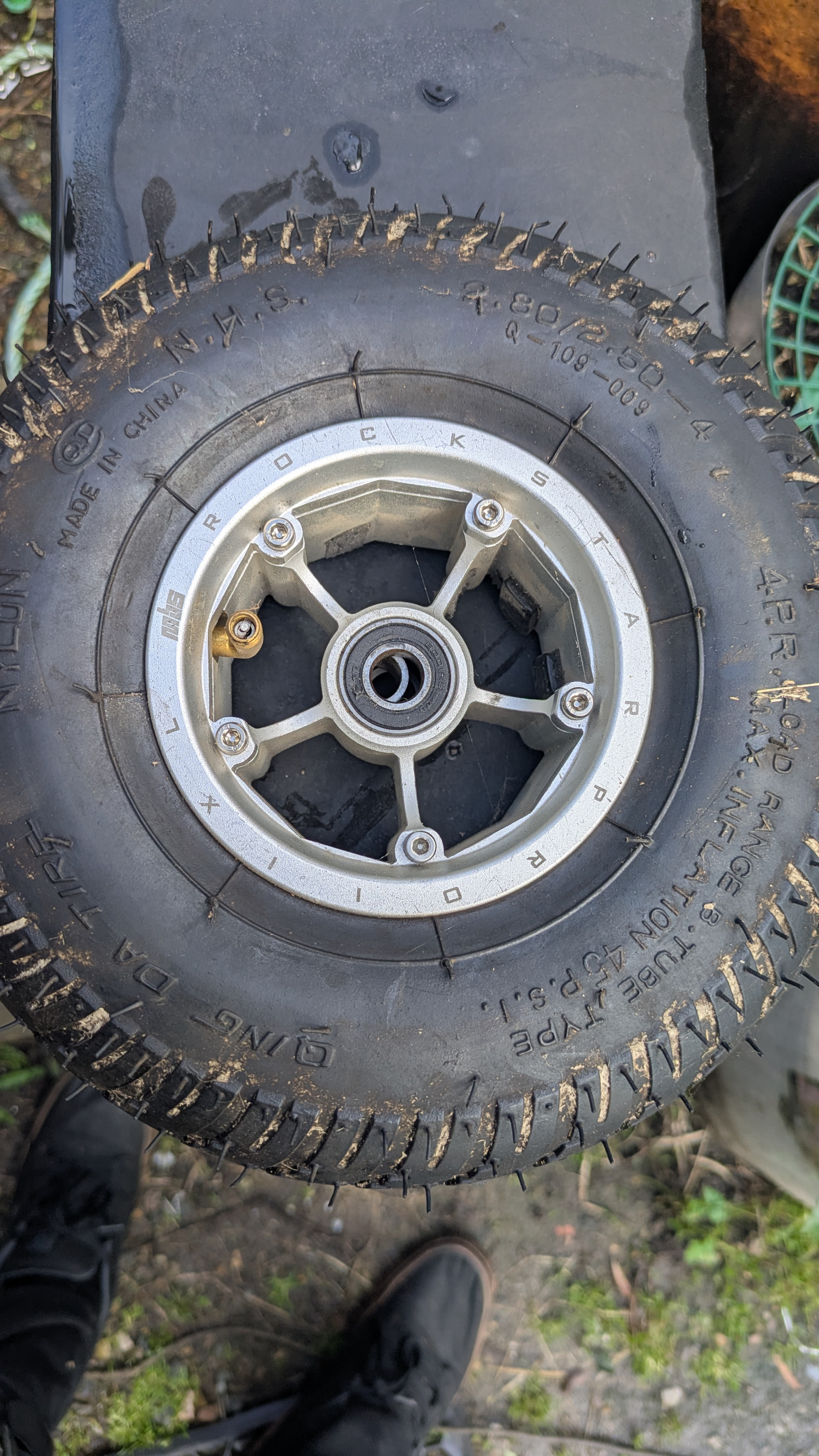

For major wheels, a large axle is needed; will Tito’s truck offer that?
Tito’s has 12mm axle option. Plenty strong.
The issue is the length; I’ve had that board before, the Major, and when I wanted to use those wheels, I also needed to change the axles.
Lol
Bout to find out :rofl:
Yep, totally works. I’m running Lorentz wheels on Tito’s right now and they’re awesome. Highly recommend the rims and tires as well, super balanced and very durable so far. I’m running the street wheels, but I think the axle spacing on the off-road ones are the same? Would have to check with @ChrisLips
Nothing is the same. These wheels you’re using now, I’ve been using them for over three years. I know exactly what you’re talking about, and I’ve had this whole skateboard and these wheels. The Off-Road wheels are extremely wide, the hubs won’t fit, the axle has to be much bigger.
Maybe you can DM Tito, see if yall can work something out.
I’ve hit up lorentz to see how much axle space is needed. I haven’t had a shipping notification yet, I may just switch to the street wheels/rims if i have to, i just prefer the look of the offroad hubs
