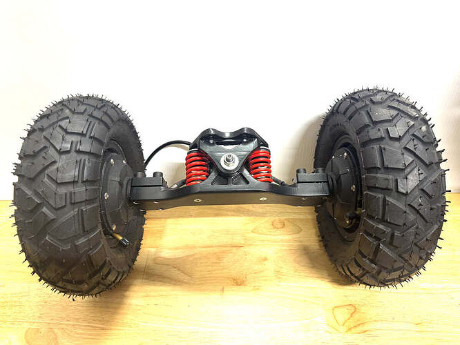

Honestly 4x 10in scooter hub motors for this build makes a ton of sense. Silent and lowest chance of a mechanical failure. You can even buy a 5th and keep it in the trailer haha. Issue is getting them to mount on esk8 trucks
I vote for gokart tyres :smiling_face_with_sunglasses:
I think this only happens with uart remotes, they have different logic than ppm.
Hub motors inside pneumatics is kind of my holy grail.

@SternWake i’ve tried those tranzite trucks/hubs, they’re wobbly as all hell.. probably just crap tires, but i’m not thrilled about the cheap trucks either. Crazy cheap drivetrain though at that price!

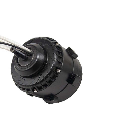

Id go with these if you’re willing to engineer an adapter to esk8 trucks. The specs are insane lol
Makes me wanna build a board using them
Hell yeah, they look awesome.. not really keen on destroying a set of dualities in an attempt to make them work though :sweat_smile:
What say you @Titoxd1000? Can you see any viable way to get these to work?
I could design an adapter and you could order it from JLC or whoever. Id use the most narrow option tito sells and go from there
Haha i just ordered the 300s.
I love the idea but i don’t wanna go experimental with this build, much rather stick with tried and true methods.
Bit boring I know, but this is gonna be a huge time and financial investment as it is, would rather just stick with a basic bitch plan
