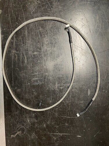

I did some testing today with a selfmade shielded cable (which was not touching the Davega Display housing) The shielded cable is the original Davega cable with a braided shield wire which is not connected to GND.
When I was riding I just used a bit of current, not super high values.
The issue video shows how much EMI is affecting the UART signal. When I let roll out the kart without applying current, the „V“ was green as it should be. As video quality is not so good and there is a reflection on the display, the red „V“ appears often and the speed is slowly changing on the display.
I was able to replicate it with a different unshielded cable. I will use a different cable later, which will look better.
I have no idea why this problem did not occur on Vesc 100/250 with an unshielded cable.
This is great news. Thanks a lot for the info @Oliver. So the solution should be as simple as using a copper sleeve on the DAVEGA cable.

I have a hypothesis about this. On a CF deck, there may be an electric connection between the motor cans and the DAVEGA baseplate. The current may travel: motor can → motor mounts → trucks → deck → DAVEGA baseplate.
Also, raw aluminum parts may be more susceptible to this than anodized parts since anodizing makes aluminum nonconductive.
Ok this make sense. The board with the issues is a kaly xl deck and all parts are raw Aluminium from trucks to motor gears and DavegaX. I have some isolating spray so when I have time I will coat the baseplate with it and test if this will work.
