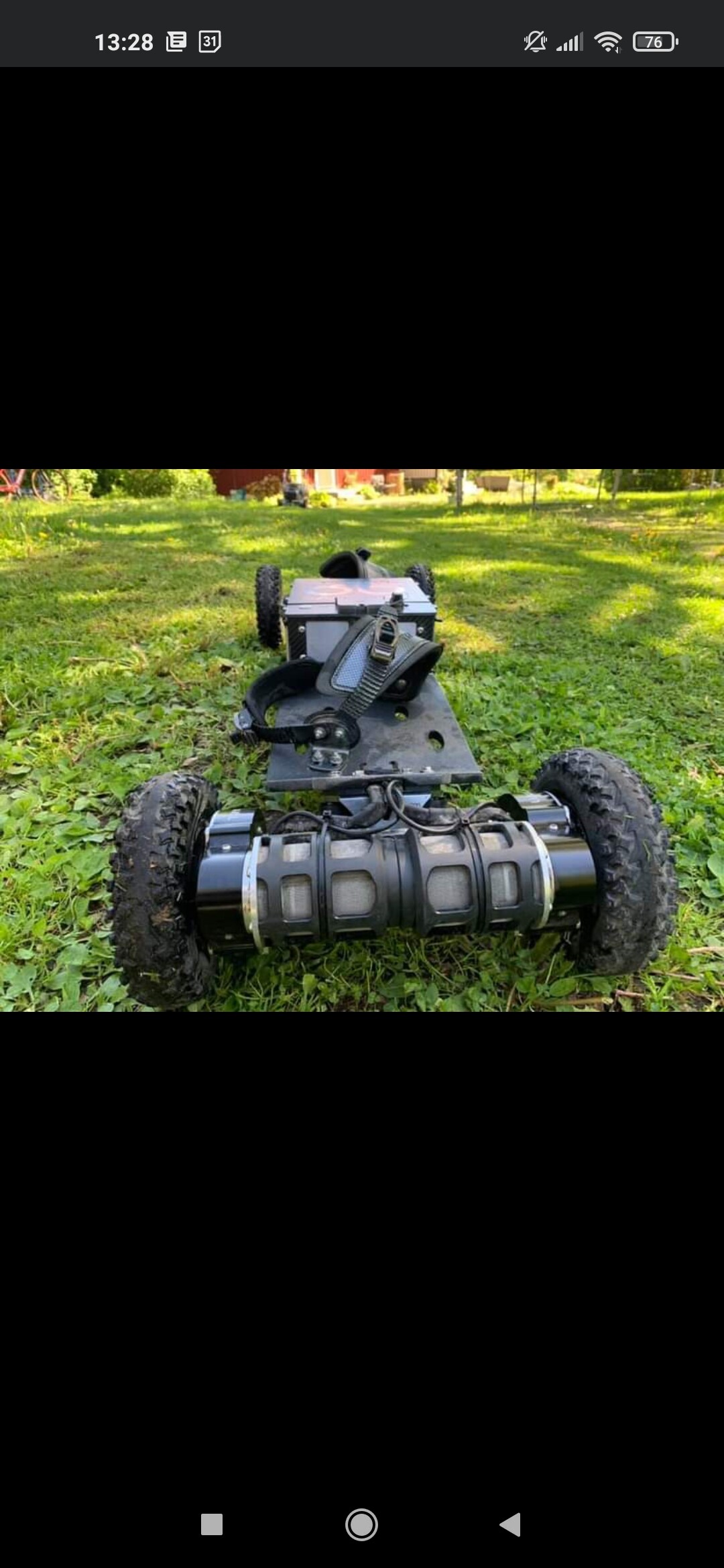

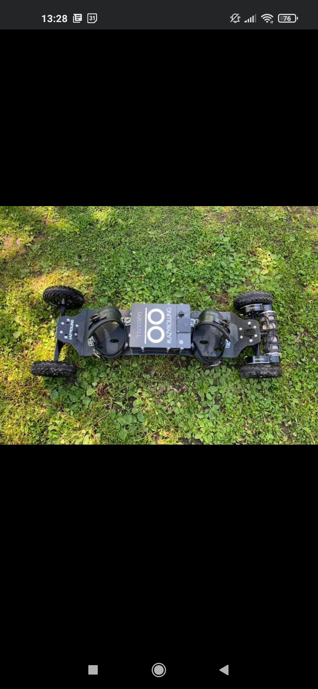

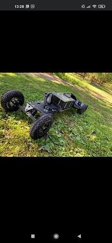

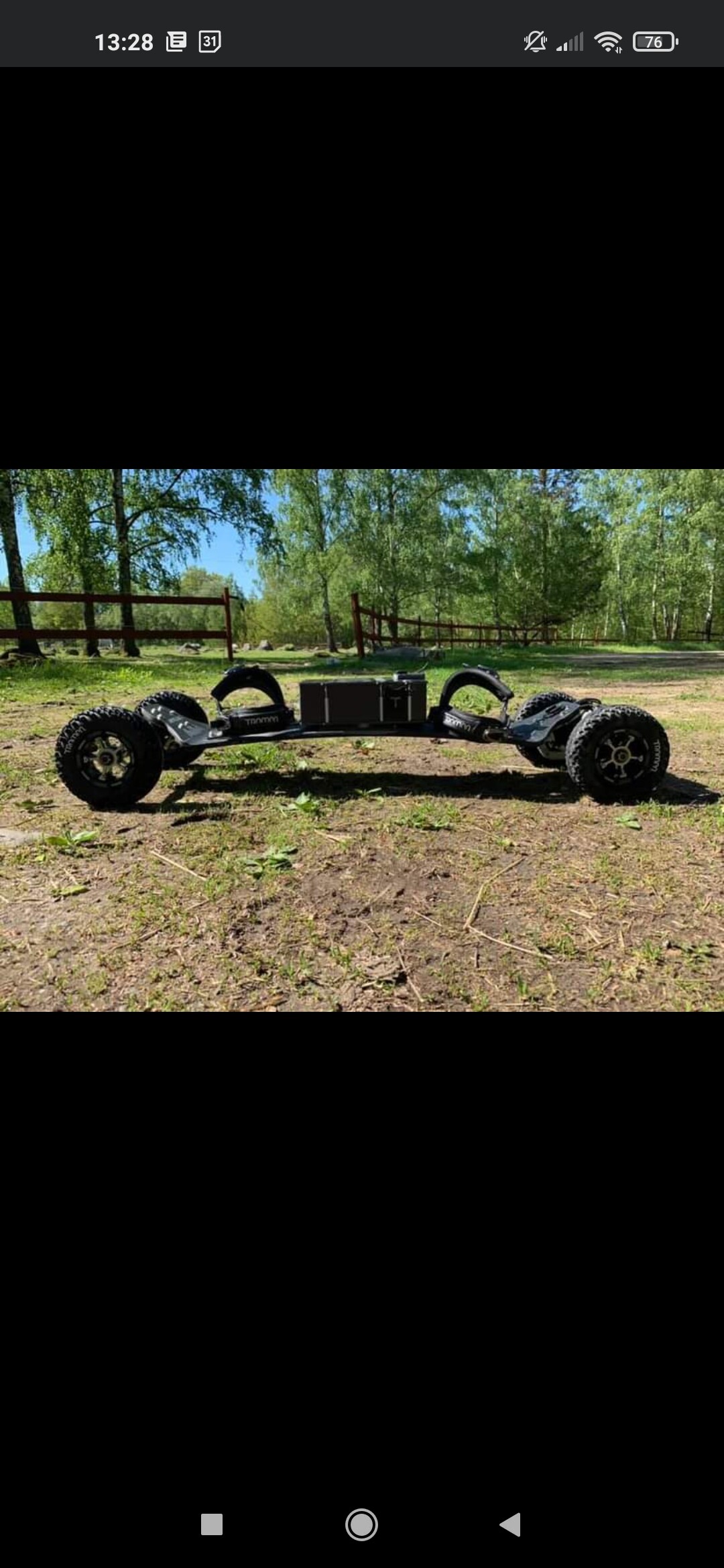

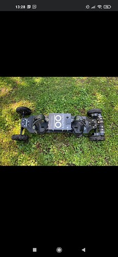

Bought this piece:
1 x Electric Mountainboard SPUR GEAR DRIVE 9-69 -
: 17ply 35º 9-69 ELECTRIC Deck - VERY STIFF
- Double drilled for Regular & Goofy…
but set up Left leg forwards (Regular).
: SOLID INFINITY ATB Hanger - 12mm Solid axles
: GUNMETAL with Black logo VERTIGO Baseplate
: Barrels
: 5 Spoke 8 Inch MEGASTAR Rims
: CENTER-Set 8 Inch MEGASTAR Rims - BLACK
: GUNMETAL Anodised Spokes
: 8 Inch BLACK Innova MUD-PLUGGER Tyres
: BLACK 12x28mm Mountainboard Bearings
: RATCHET Style Bindings please
- Carbon Print Strap with Black Foam Footstraps
- GUNMETAL with BLACK logo L-Brackets
- GUNMETAL Anodised Ratchet Buckles
: Heel Straps with GUNMETAL Ratchets
: MAYTECH rechargable Remote - Small size Thumb Operated
Battery: 12s9p
Charger: 5A

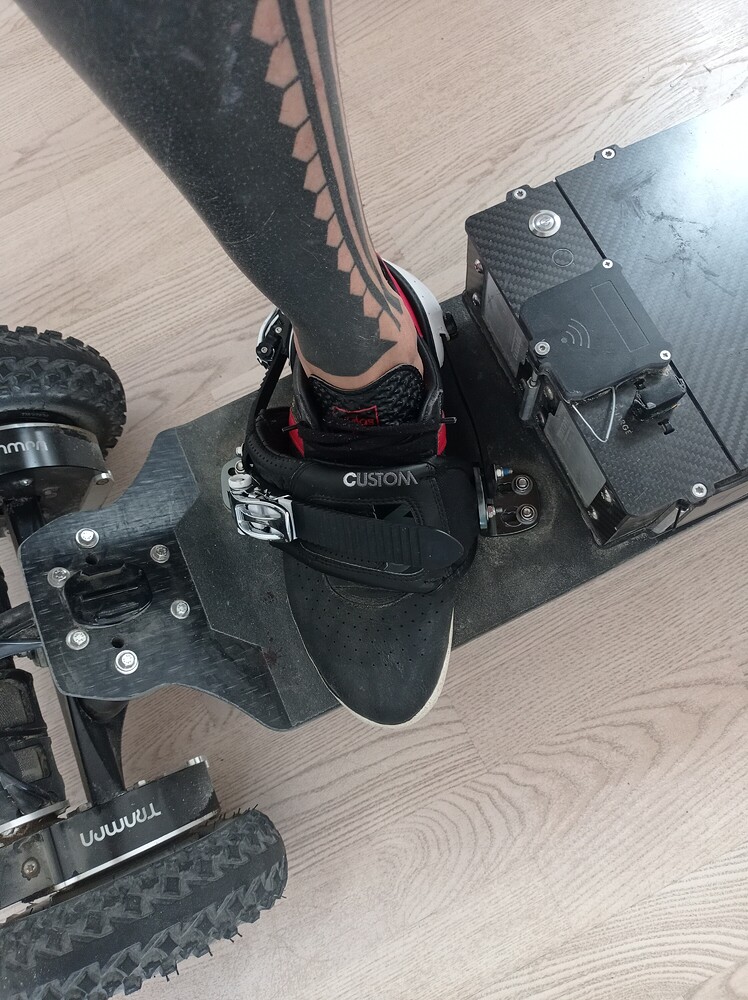

Even though i bought a complete board I can never leave things the way they are.
Wasn’t completely happy with the Trampa bindings so i modified my old snowboard ones instead.
Much more comfortable and a better fit.
@PedroMcJimenez :arrow_up:
Great idea :star_struck: what needed to be modified??
I can tell you love sitting in the ink chair damn son :sunglasses:
I dunno much about emtb’s, but know that snowboard binding strap options are immense and rather untapped by the community.
@Katarsis :ok_hand:
I slid the ankle slider all the way inside the ankle strap and drilled through both of them to attach the strap to the bracket on the board and the ratchet to the strap. I drilled a bigger hole in the tounge to attach it to the bracke on the opposite side.
I used the toe cap as a heel strap and for that I set the slider to the outer hole and drilled the tounge and slider holes and attached them to the bracket.
