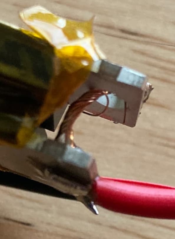

I ordered. Haven’t seen anywhere that explains how these drop the voltage. Please tell me how it works.
Ur schematic looks simple enough to follow as far as wiring it in. The power supply only does 150watts and want to drop from 87.5 to about 85. If I were to use a power supply that did more current would these still be ok to use?
Diodes are basic electrical components like resistors or capacitors. There are different types of diodes, and this one is a Schottky. They are normally used to block the flow of current in one direction up to a certain voltage, but allow it in the other direction. The drawback to the “allow” direction is that you get some voltage drop because they are not 100% efficient.
In this case, we can actually use that voltage drop to our advantage by lowering the charger output voltage. If you wire these backwards, the charger just won’t charge since the charger voltage is well below the 650v blocking voltage of this diode.
The other drawback is that this voltage drop creates heat, and the higher the current, the higher the heat. The datasheet specifies 20A, but that’s only if you can keep the diode at a specific temperature. With the package type, it’s probably best to heatsink these then seal it up in epoxy. Might work, might not. You can calculate it, but would just be easier to try it and see. Just keep in mind if you use two diodes in series, and heatsink these, either electrically insulate one of the diodes from the heatsink, or use two heatsinks that are electrically separated.

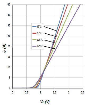

This is the chart in the datasheet that is the most important, and why we aren’t just using the “forward voltage drop” of 1.65v specified on the datasheet.
It shows that at no current and room temp, forward voltage drop is about 0.80v. As current rises, so does the voltage drop (and the temperatures of the diode which also changes the voltage drop). When in the CC charging stage, you might see as much as 1.25v drop on a 10A charger, but once you are at the end of the CV charging stage, with like 100mA of current flowing, voltage drop will settle to the bottom of that chart.

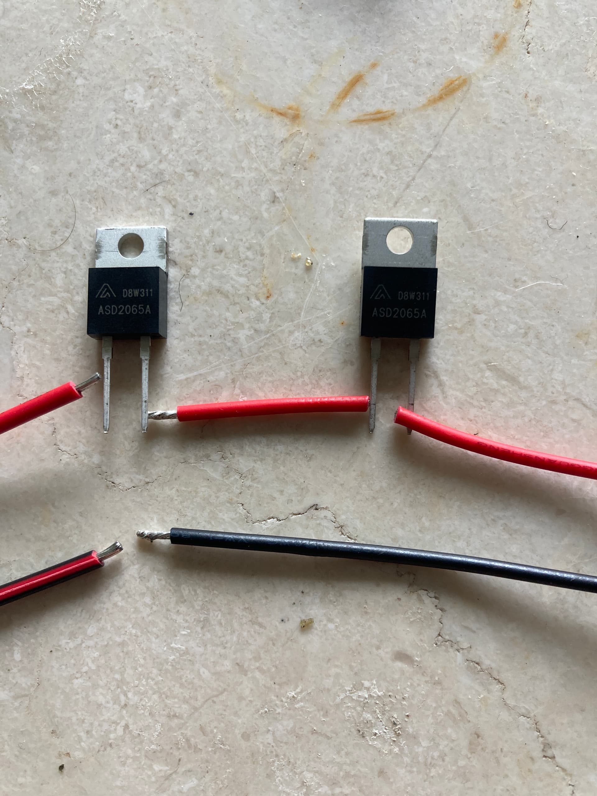

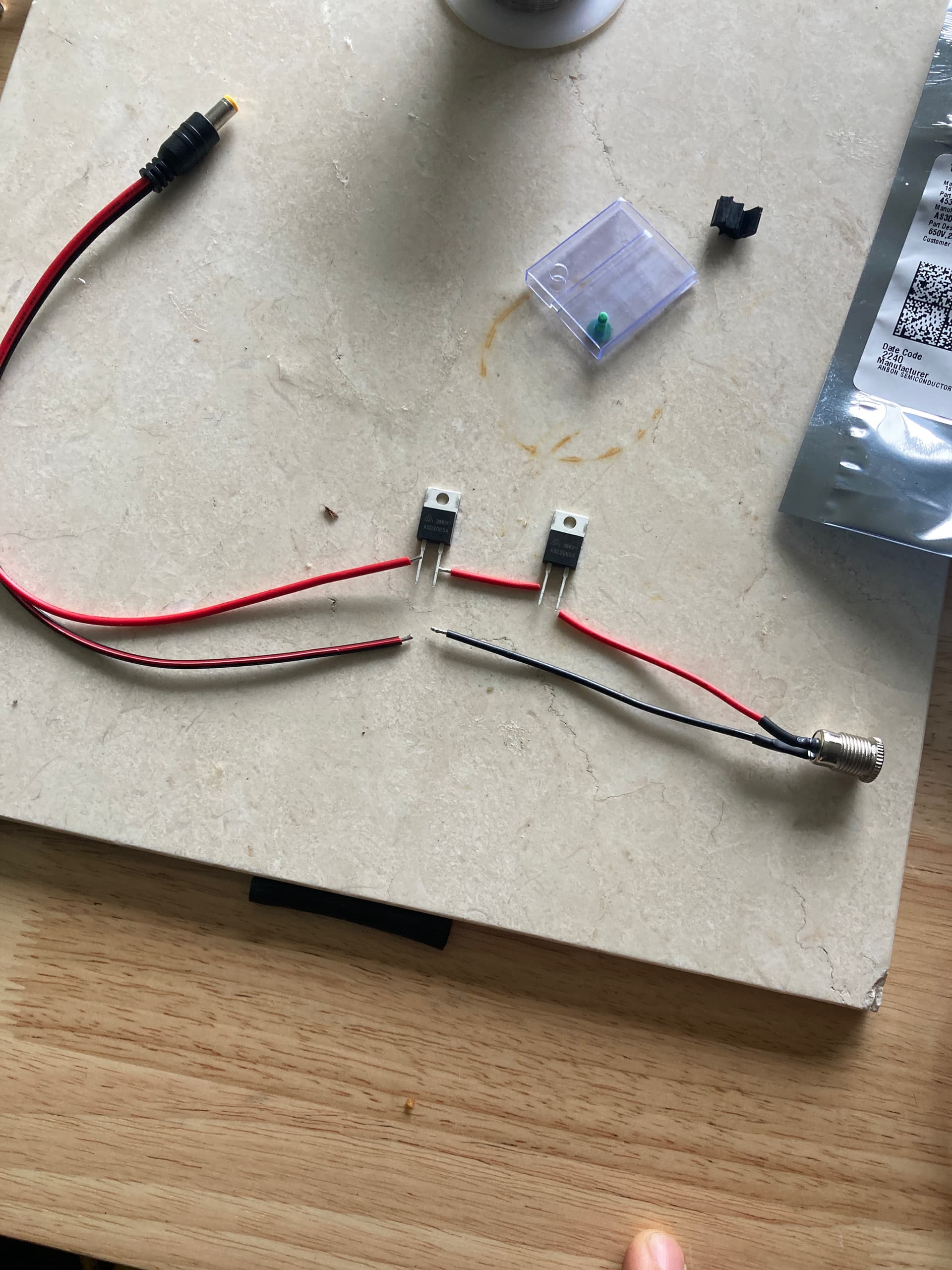

Do I have these diodes oriented correctly? Battery will be on left. I see no markings for which direction current flows in the diode. I guess I could figure it with some experiment but never have.
The diode symbol itself is an arrow that indicates current flow direction. In this case, from pin 2 to both pin 1 and the case. The first graphic in your post also gives you a clue with its references to “in” and “out”.
You can use pin 1 or the case or both. No real benefit in this case to use both.
I’ll leave it to you to now determine whether you’ve got things set up correctly or not. :slightly_smiling_face:
With these particular parts and this particular circuit, it would be really hard for you to break them by wiring them up wrong, so plug it in and go for it.
Looks okay to me.

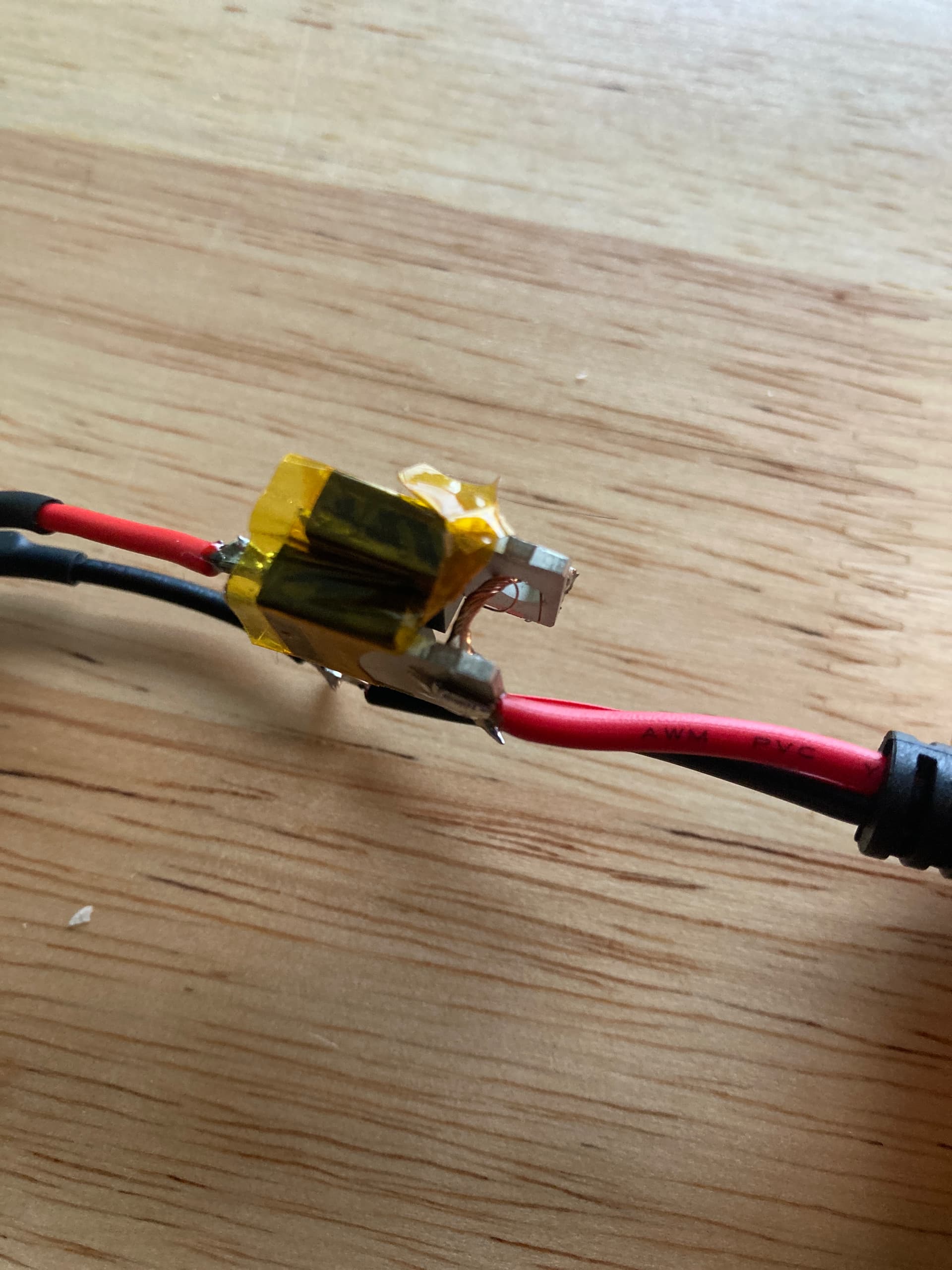

You could place the diodes face-to-face (heatsinks on opposite sides) and solder the two pins together instead of using a short wire between them.
The heatsinks can’t touch.

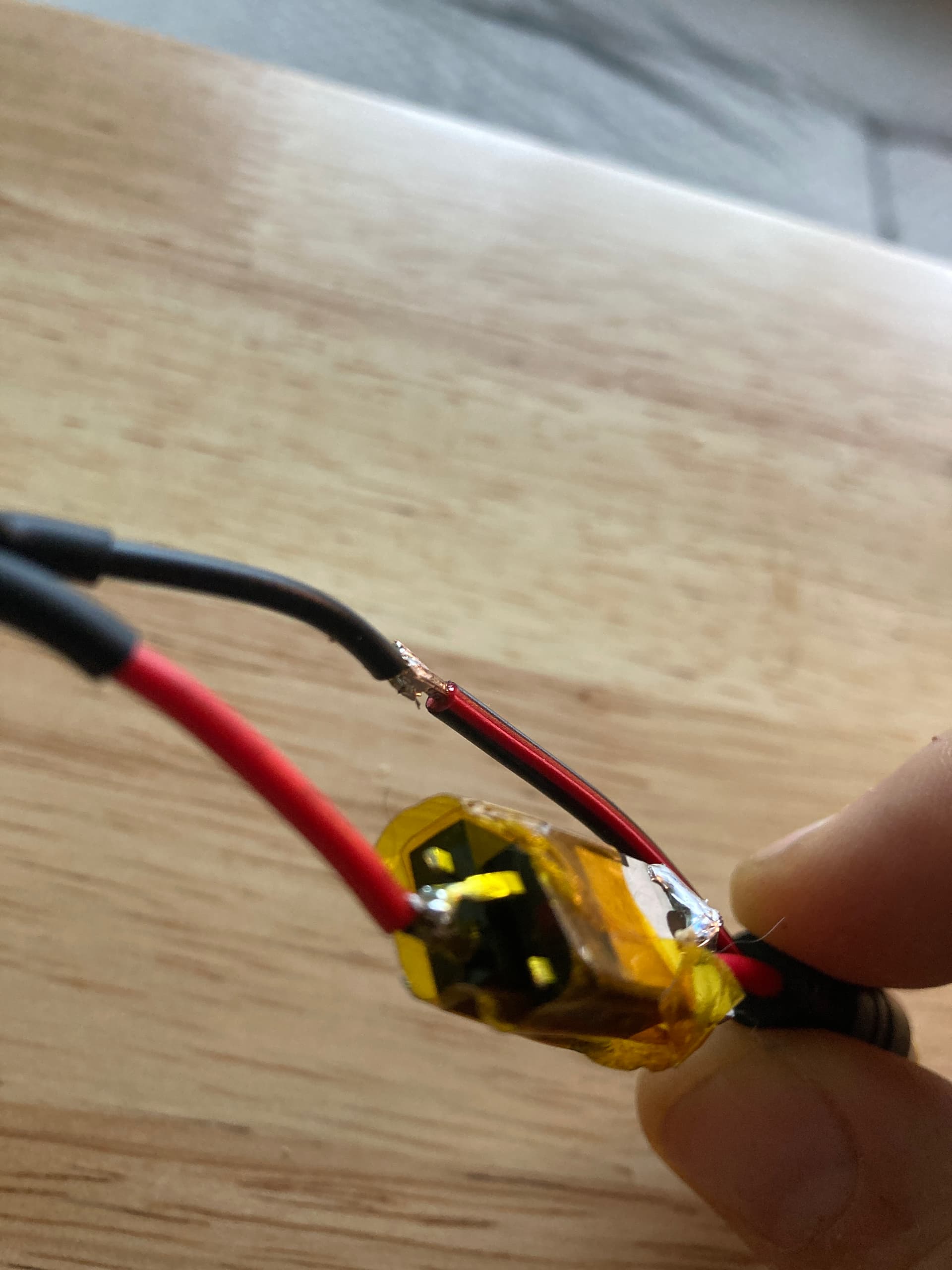

I’ve got both pin 2 connected to red input and both of the case output connected to the output
It dropped only from 88v to 87.5.
Or should I put them in series? I think so n try that
Down to 86.8v in series.
Was that with current flowing?
The voltage drop increases as the current goes up.

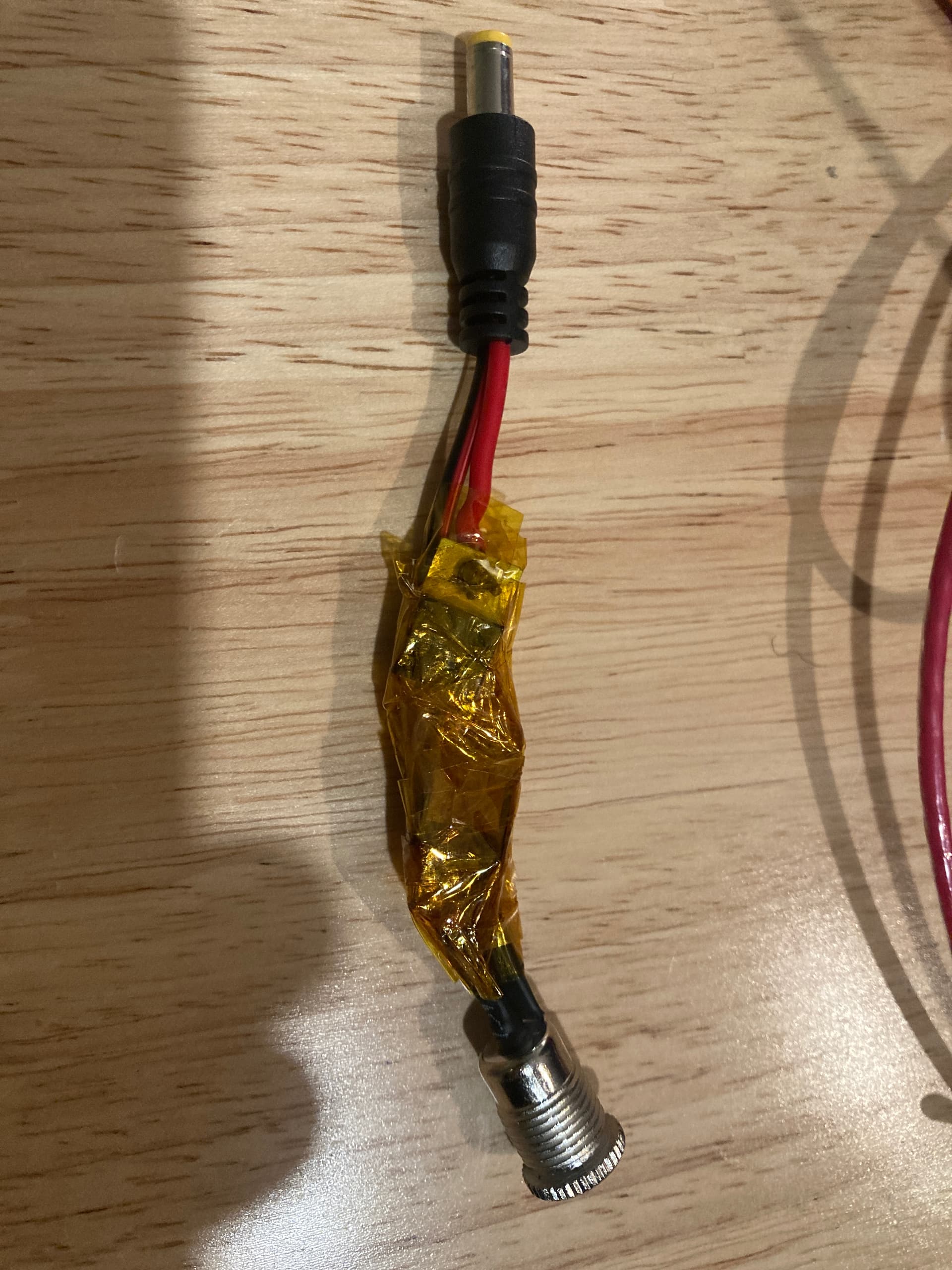

This is with no current flowing it drops 1.4v. I plan to just leave the bike on the charger so it will eventually get to that high 86.8v, which is 3.61 v per cell with 24s
The heatsinks, or metal part of the diode, are on the backside n not touching.
