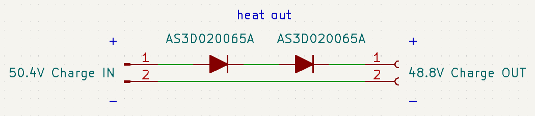

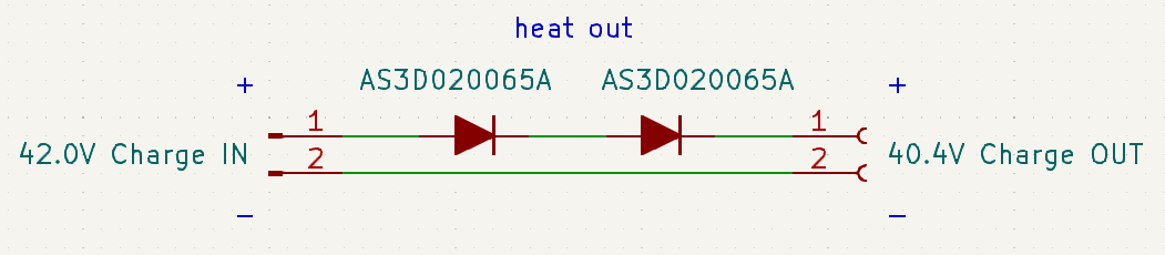

In that case, build an adapter that has a charge port male and female, and a couple giant diodes in it. Cover it with epoxy. Charge through that.
Don’t overcomplicate this.
I would like to see your schematic, and after careful evaluation, I could give an opinion. It sounds like you should be involved in the next generation of high voltage anti spark switches. I only know diodes only allow to pass one way. I dont understand further, till you further explain.

Oo. That’s a nice solution. Could u please do me a favor too and tell me the diodes i need to get my 87v charger down to 85v?

Same ones, they are ridiculously overrated. 0.8V per each.
AS3D020065A

I have done this to reduce the charging end voltage on one of my chargers.
Yes it is as easy as checking the output voltage while adjusting the pot. I personally did 4.05v per cell, 12s = 48.6v.
Not all chargers have an easily accessible adjustment pot though. I used a cheap aliexpress charger.
For my boards, this does not affect the ability to balance.
I have one normal charger, and one tuned down, it’s a nice way to avoid fully charging my batts when I dont need to.
I love you Man. A straight answer to a straight question. Does the voltage dip, when under varying loads?
