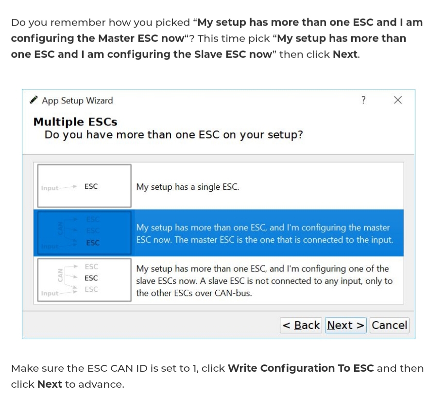

  • Using the App Wizard for configuring both master and slave
  • Master VESC has ID set to 3
  • Slave VESC has ID set to 4

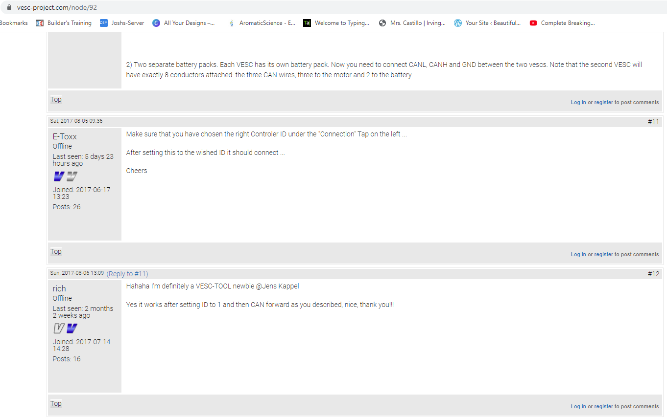

  • Every time I select the CAN forward button the VESC disconnects.
Any suggestions on what I should try next? Thanks for any support that you can offer. Really want to figure this out!

Do I need to enable the CAN forward button? There wasn’t anything in the tutorial about if that is needed. I found this instruction online but it doesn’t make sense to me:
If you configured the 2nd VESC as the slave using the wizard, then can is enabled.
Chances are you either missed a step or at some point you powered one of the VESC’s and bit the other while can was enabled, which can burn out the can chip.
