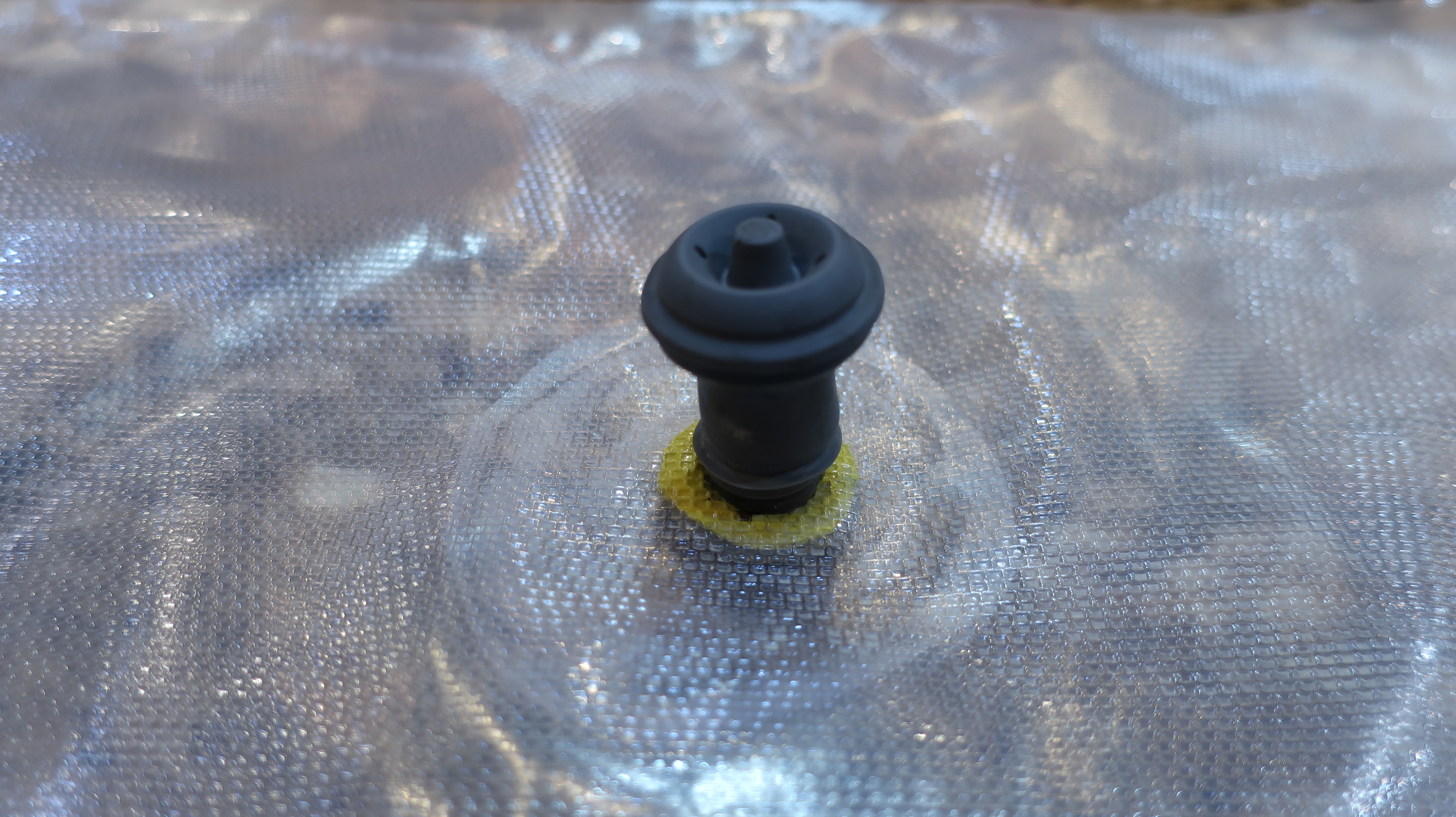

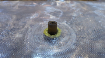

So where I’m at right now is trying to find a way to interface the valve with the bag without having to have people go out and buy something.
Here’s how Roarockit has been doing it.
Stem on a flange sticking out of the bag sealed with sealing tape.
Silicone tube slipped over to both seal and bring the size up.
And finally the valve slipped on top and held on with a zip tie.

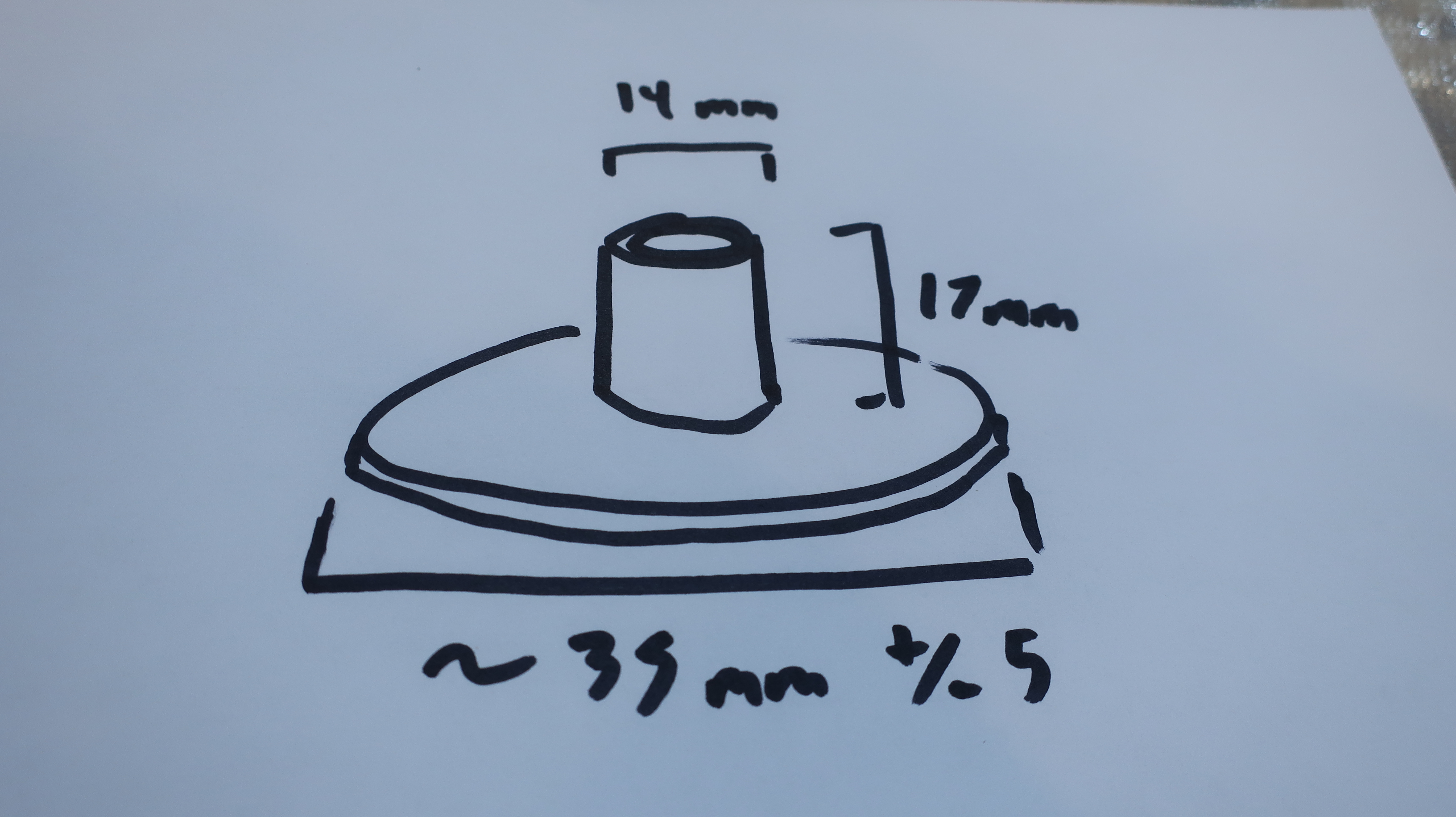

I’d like to be able to bypass the silicone tube step. And I think if the stem is sized right that should work fine. One less thing for people to have to worry about getting, and buying 5’ of silicone tube only to use half an inch of it is super impractical.
What I’m hoping to do is find some part something like this, which can either be sourced off common items that people might already have or can buy super cheaply.
There’s plenty of random plastic stuff thats part of bottles or packaging that may just happen to be a good fit, and it could just be a matter of having enough eyes keeping a look out. So far I haven’t had any luck on my own.
