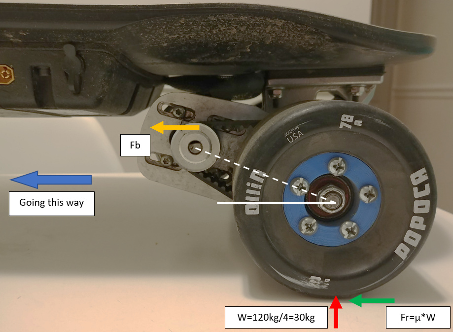

Starting with the loads
Assuming 260lb (120kg) is riding on the deck, rider and gear.
Resulting in 30kg vertical reaction force (W) on each of the wheels.
In order to move, the motor must overcome the friction force (Fr) which is µ times this vertical force. µ being the friction coefficient, ranging from 0 to 1.
To tackle the worst case, let’s assume µ=1.
Now, the motor can overcome this force by applying belt tension (Fb), through the pulley.
The picture is of my own board, note while the mount is at ~30deg angle, the belt is almost horizontal. Your setup can vary, but it’s probably somewhere close.
This force is always tangential to the pulley. The balance between these forces is through different diameters:
Fb*(Dpulley)=Fr*(Dwheel)
My wheels are 90mm
36T pulley diameter is 56.1mm
40T pulley diameter is 62.5mm
For my wheels and 40T pulley we’ll get: Fb=43.2kg
So, the difference between regular truck and truck with working motor is this ~40kg load.
What do you think so far? Is this making sense?

At times, the 120kg is spread on two wheels, or even on one. That’s skating. Bumps and curbs. So maybe we shouldn’t consider the base loads, but the peaks.

Well, the bearings are supposed to take loads. What load will or won’t pulverize them?
There’s a load. (Thought of this a little more) The one I calculated is going from a stand still, during ride it’s probably much lower.
The trucks are much stiffer than the mount, it does more to it than to the truck.
You’re right. It was a clean snap, as fatigue failures are. You never see plastic failure as a result of fatigue. I believe that repeated bending initiated the crack.
That’s a valid point, we’ll add it to the mix.
You need to consider all of them, but this is a bit later
Quite a few people pulverized rear bearings that where ceramic, so there is that.
Probably due to the fact that ceramic is more brittle than stainless steel, and our wheels are under more weird loading than push boards.
I’m also on the train of thought that what really kills them in the millions of cycle that the vibrations impose on the truck, they won’t break it by themselves, but weak to the point that a peak load finally does the job
