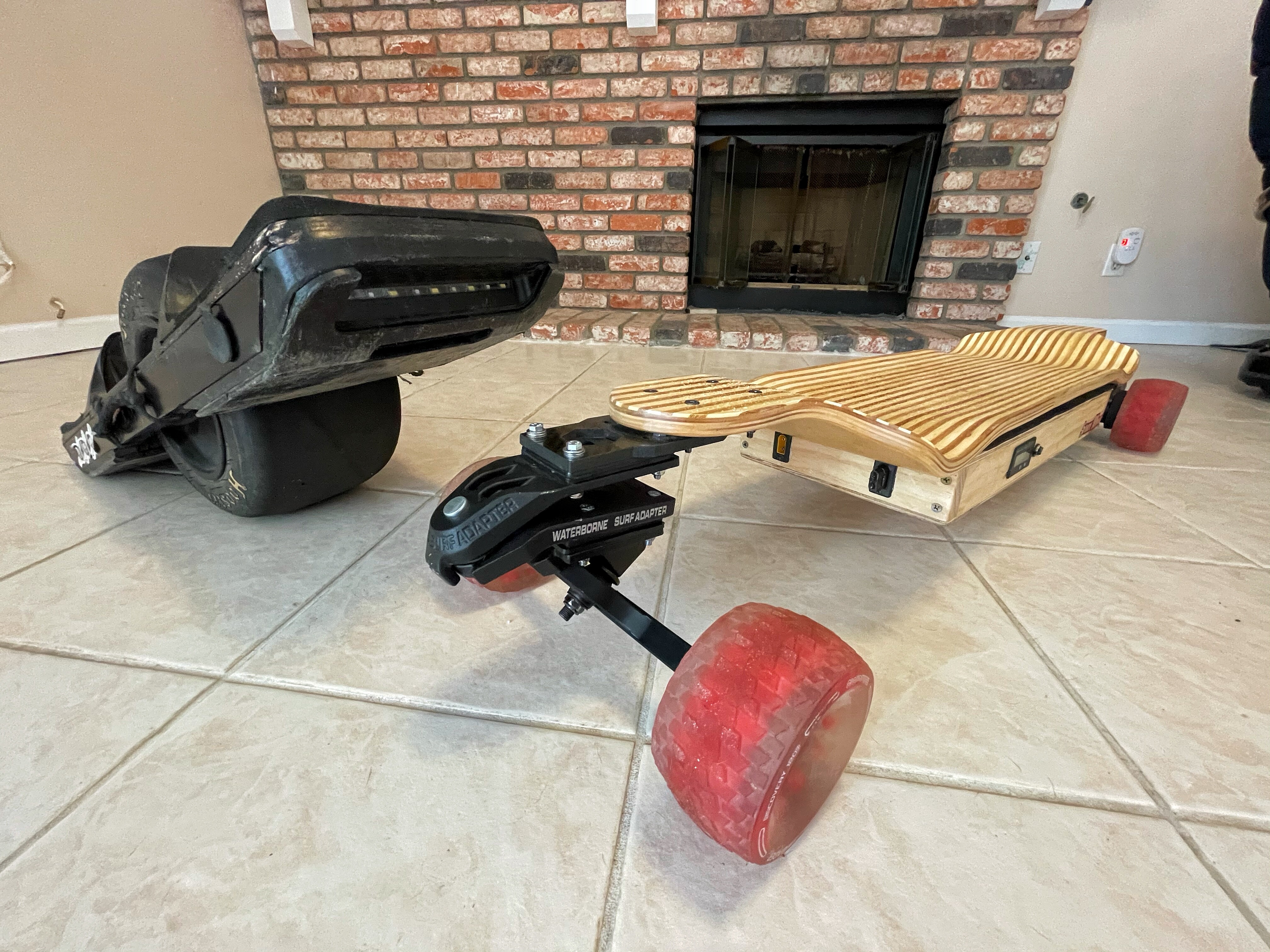

The short rod version of the 3-links. Or see if someone have a set of tkp from the late Phychotiller they would be willing to pass on to you. That could be two options.
Thanks for your input. Is this carbon fiber plate durable enough for riding on the bad streets though? How’s your experience with it been?
Tito duality trucks with their hangers in the long wheelbase orientation might do the trick. Plus, you’d get all the other benefits of duality trucks
Also, the Tito Duality is available in 210mm, 240mm, 270mm and 300mm widths that should put you out wide or long enough to eliminate wheel bite.
ONSRA TKP trucks push the axle a decent ways forward, but they’re really tall if you don’t have a drop through deck.
I used the waterborne extender in the past and it held up fine for me. I’m not sure if I’ve seen someone break one but I’m sure someone has at some point. It certainly looks insane though.

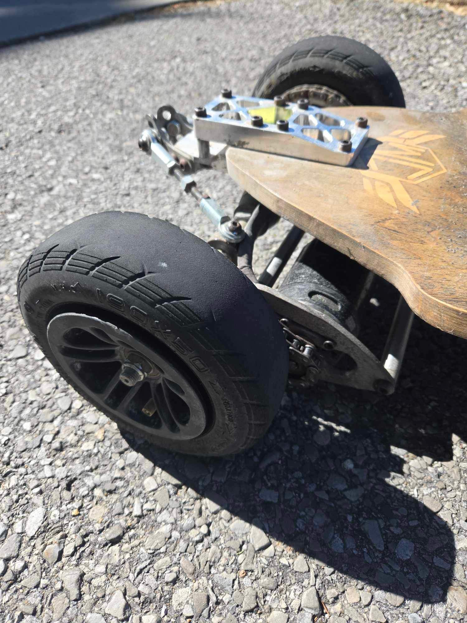

Another options is running the MBoards extenders on the top of the deck if it’ll work with your setup. @rafaelinmissouri hqs a setup like that right now, here’s a picture. This setup doesn’t add the height but gives you the extension.
If you’re on a budget. B-one tkp’s, add flipsky hangers if you want more clearance again.
@dskate Fantastic, I do have the Mboards extender handy. Smart, mounting the extender on the top. Gonna make some measurements to get appropriate bolts and spacers to make that work!

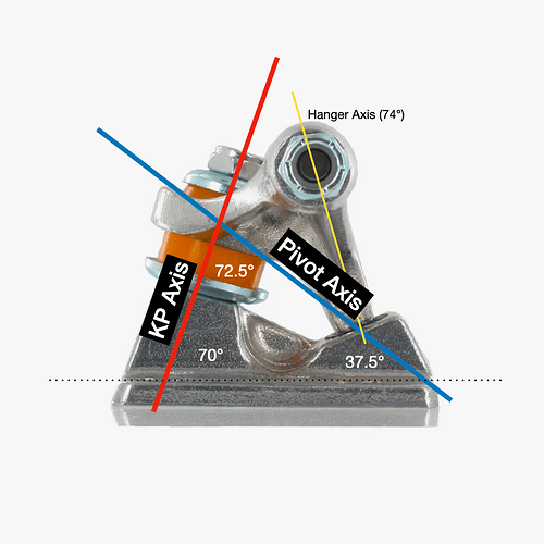

On a side note, I have a somewhat irrational preference of RKPs over TKPs. I’ve thought for a while that the acute angle between the hanger pivot axis and the kingpin in TKP design was odd. In RKP design, the pivot axis and the kingpin are perpendicular to each other, therefore fully utilizing the elasticity of the bushings. Those with engineering/mathematics background and smarter than I discuss this:

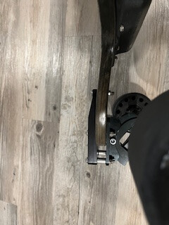

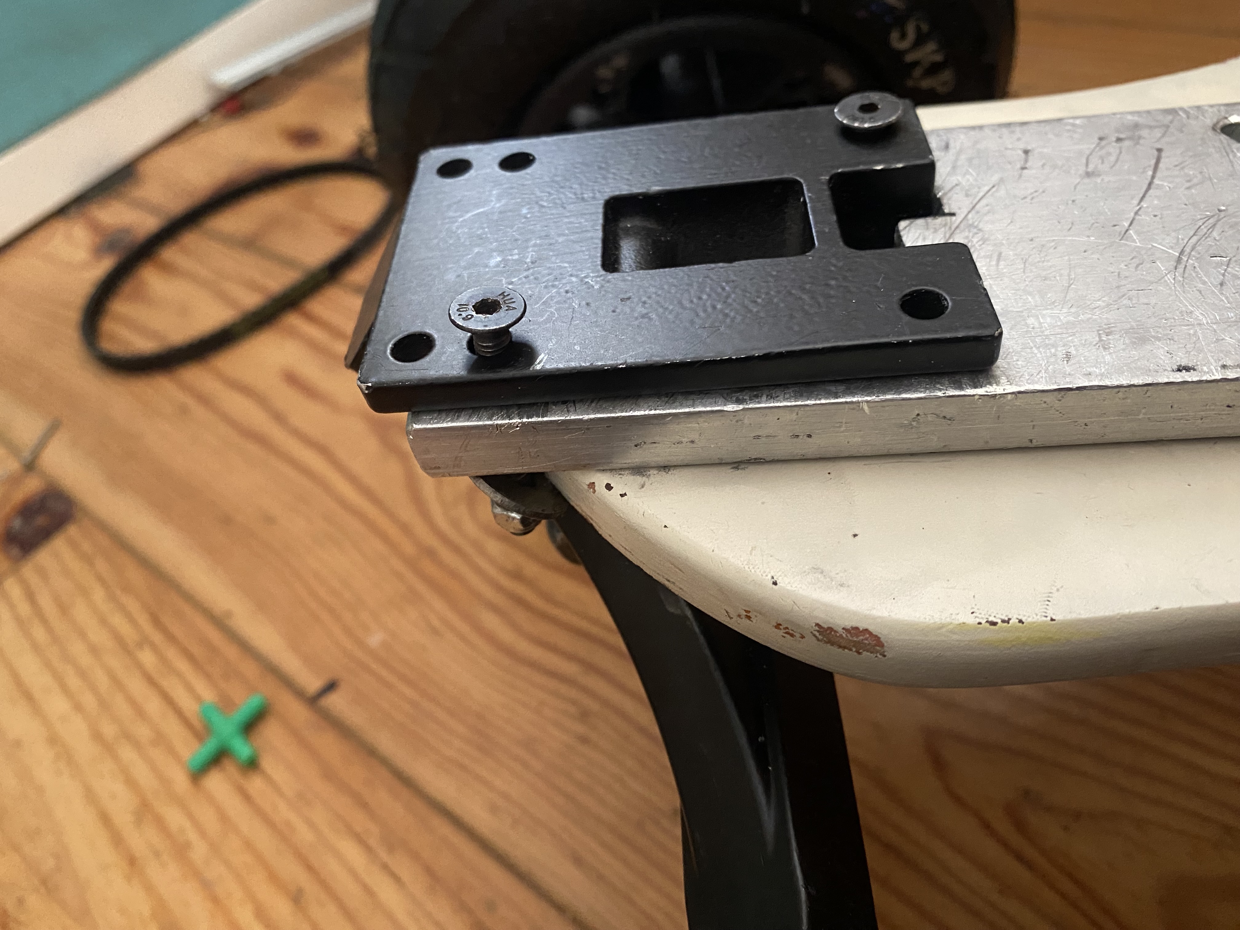

@dskate @rafaelinmissouri Wanted to close the loop and thank you both for the idea of running MBoards extenders on the top of the deck. I had mine anodized black locally.
The truck baseplates already had a couple of additional holes drilled to mount on the MBoards extenders. 3-link truck baseplates that this extender is designed for have a narrow waist so do not require drilling, but my rectangular BN baseplates did.
I reused those same holes but did not use 2 holes per side where the board-side holes are on the baseplate. I could if I drilled additional matched holes on the deck, but did not feel the need to as 1. the current config looks structurally sound and 2. additional bolts would not reinforce the weight-bearing area of the deck anyway.
The rear truck is mounted the same way.

Keep an eye on your deck for possible delamination because extending it out like that really adds a lot of stress.
On a positive note for me, it adds delightful bit of flex too
