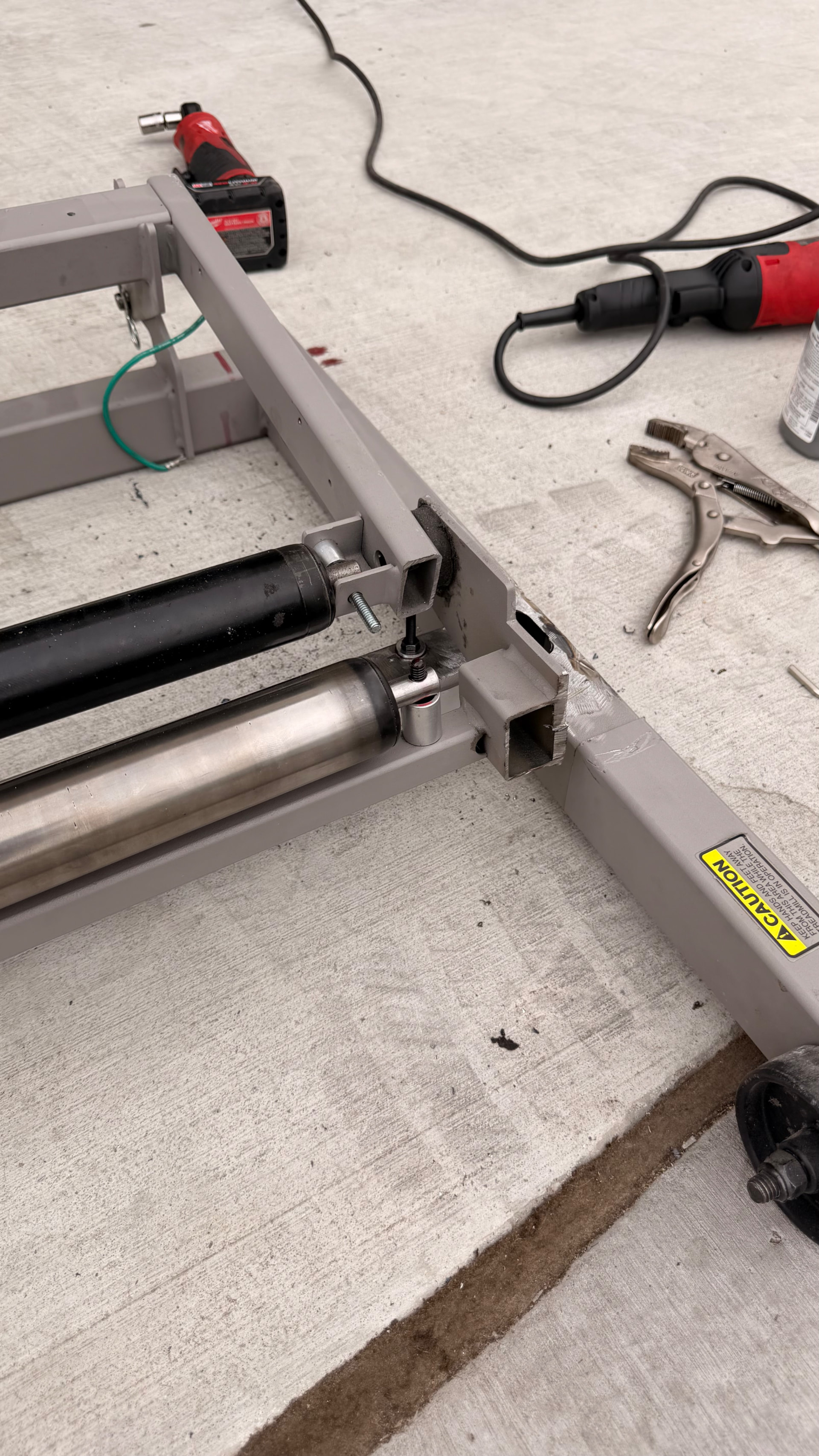

Soooooo, my first thought was to tear down an older treadmill and use the casters. You reverse the polarity on the motor and boom, it’s a generator that increases amps and voltage with higher power output. Plug two multimeters (one for voltage and one for amperage) in and bam you have a makeshift dyno (just video the two together and have AI generate a wattage graph)

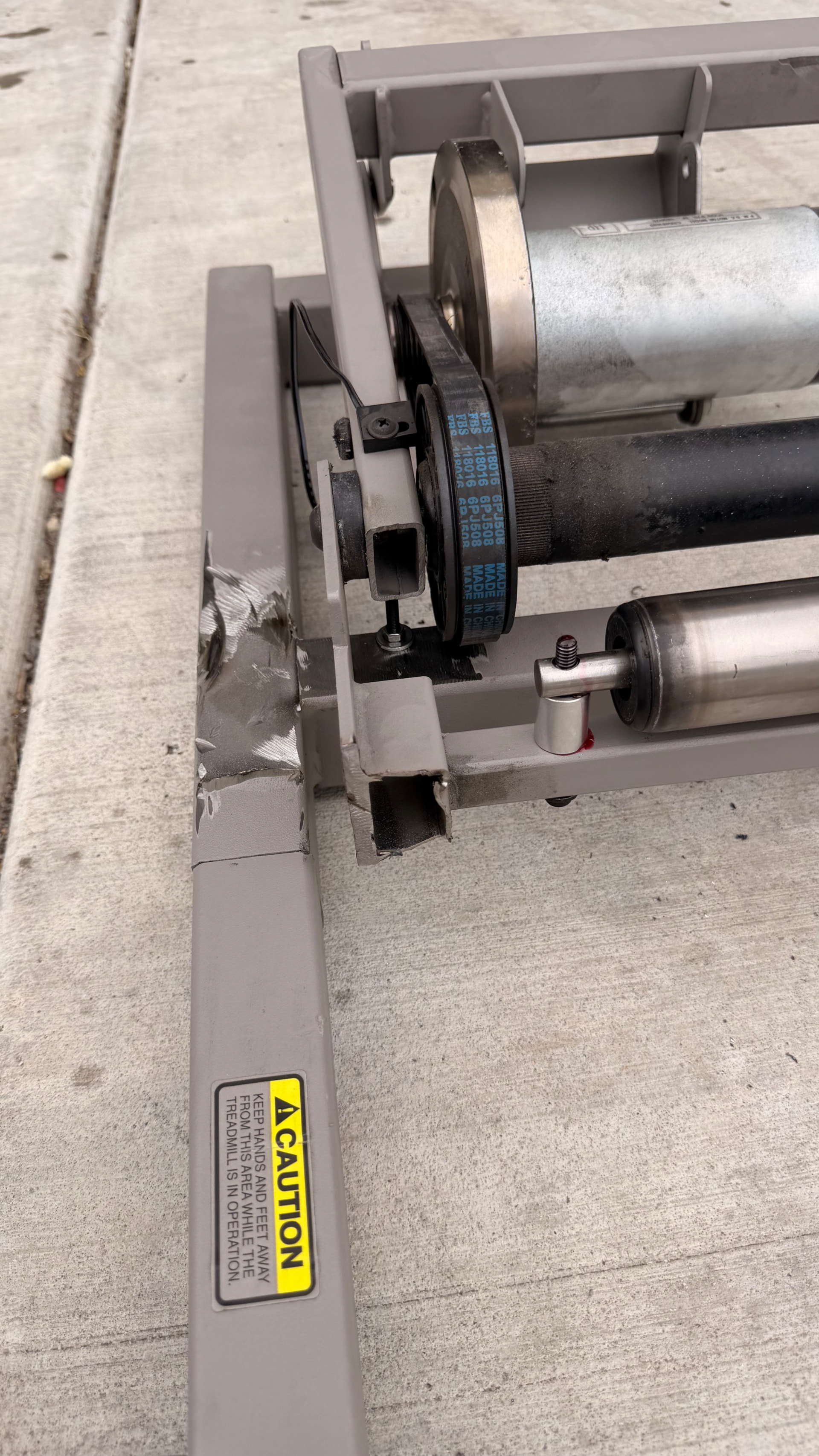

Im currently in the process of chopping up a treadmill to fab it back up together and the cool think is the treads gearing seems like it could potentially work. I might have to add an idler but testing will tell. I got some inspiration from the Hoyt dyno that used a brake rotor and pads but ended up just using the brake rotor because that simulated the acceleration of a 300lb rider.
pics and more info to come

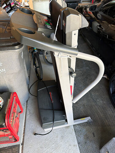

Original treadmill:

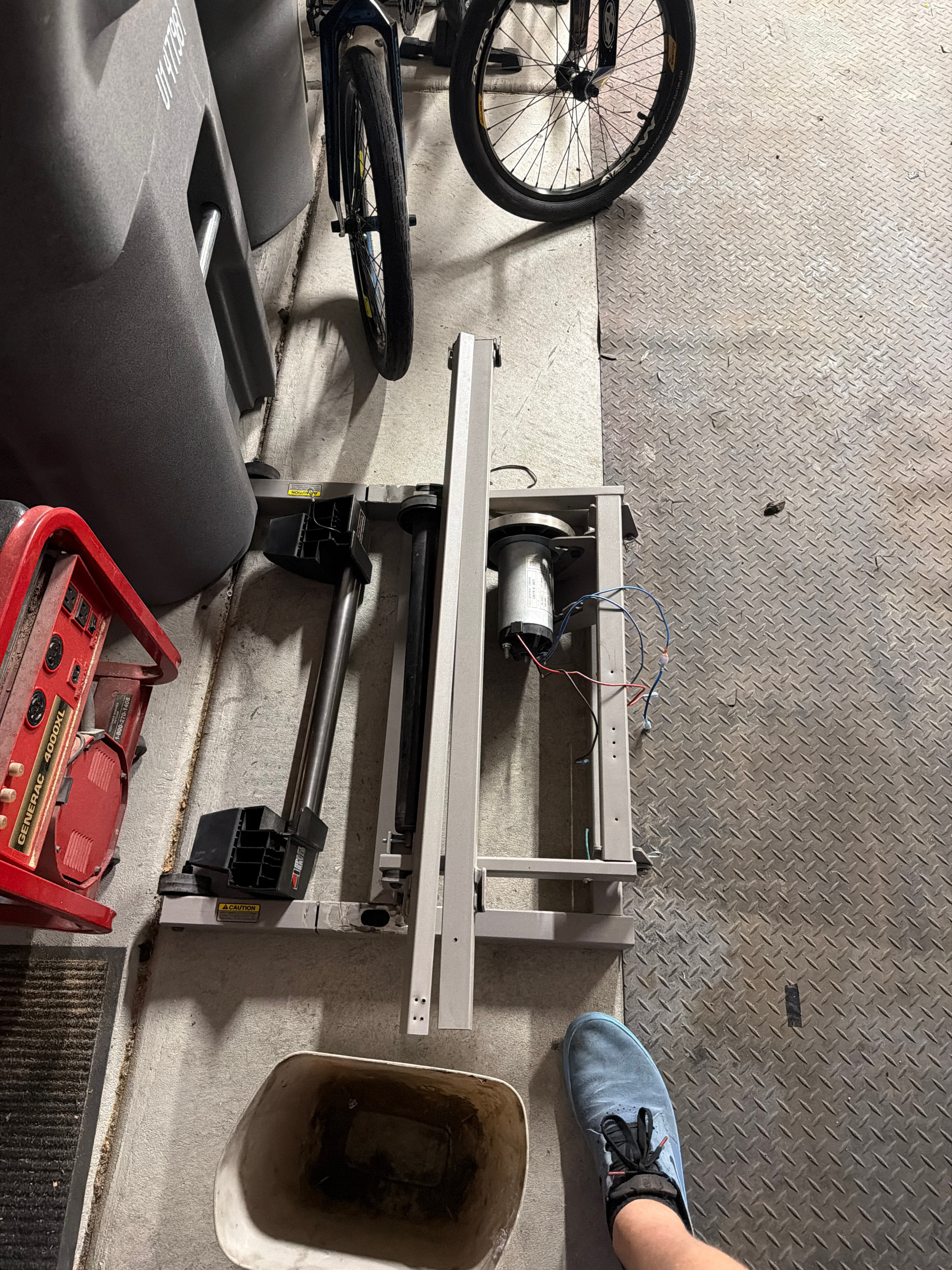

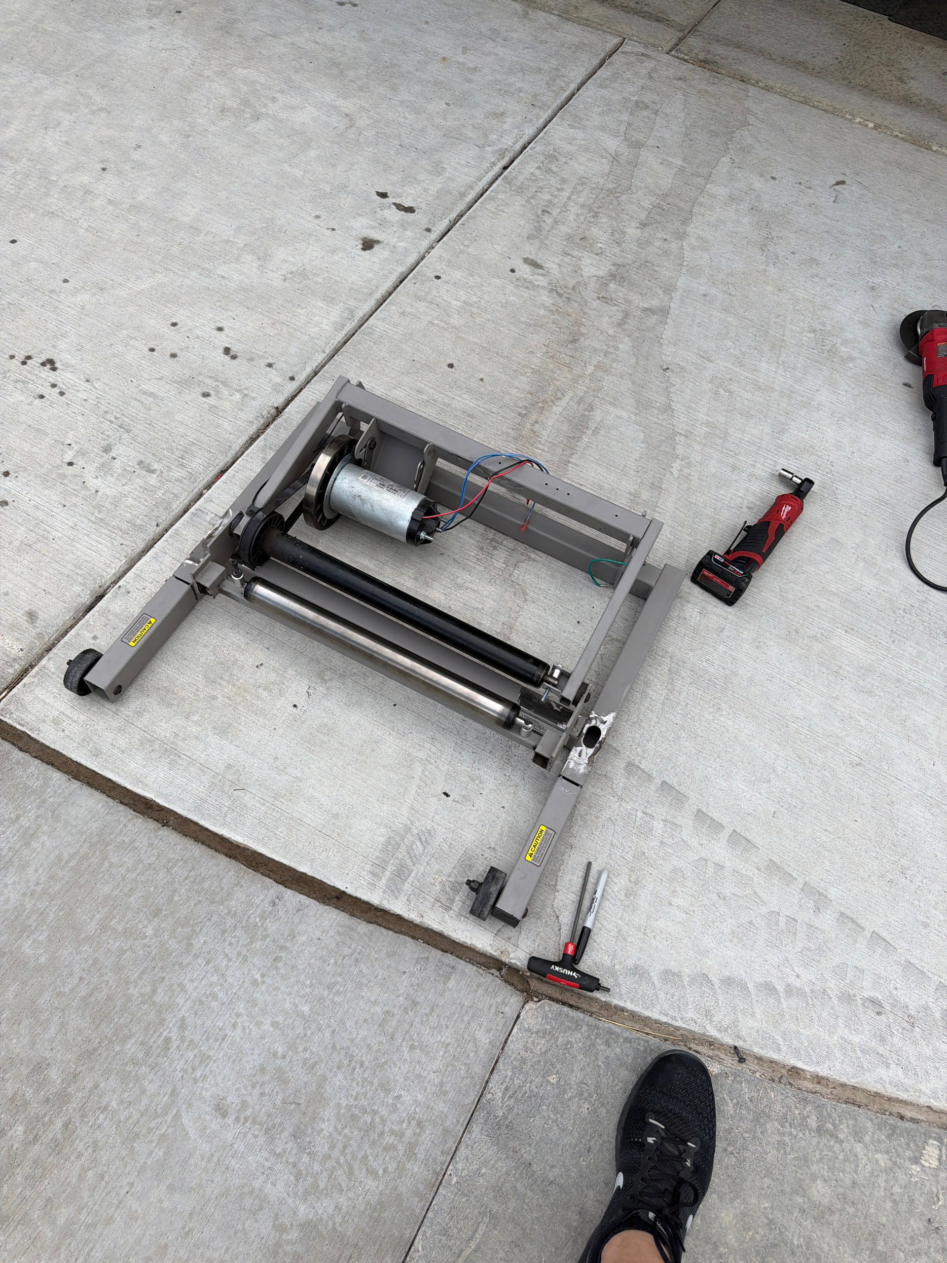

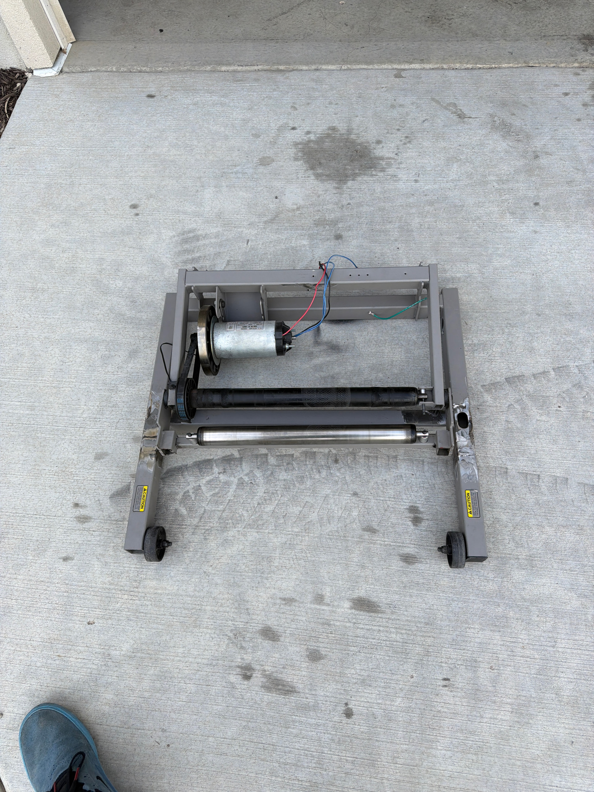

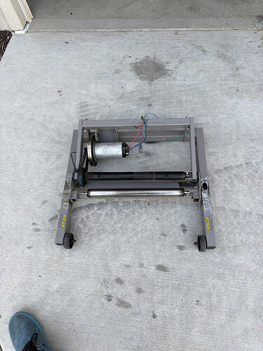

After 2 hours with an angle grinder:
Potential other material I was going to use to build from scratch:
Lmk any ideas, I’m by no means an electrical engineer but I think this is a cool project. I think it’d be cool to use a graphing multimeter but dems expensive.
