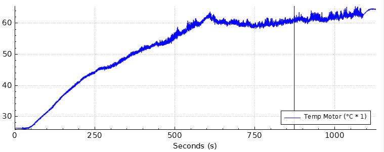

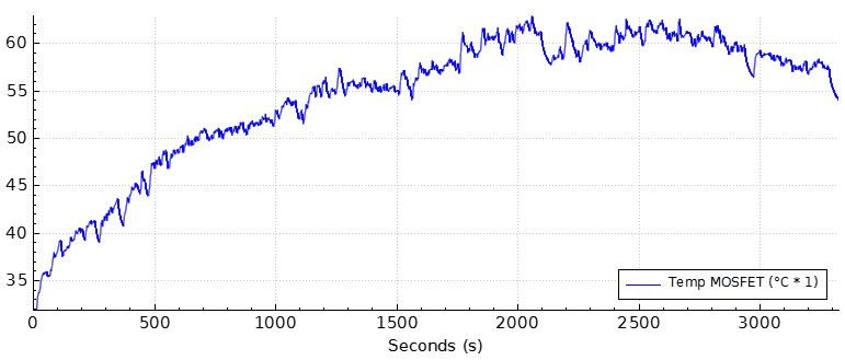

MOSFET TEMP

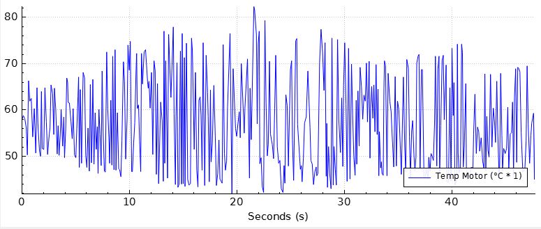

MOTOR TEMP
The motor temps jump like a pro during acceleration like from 42.2° to 82.3°C within a blink of an eye.

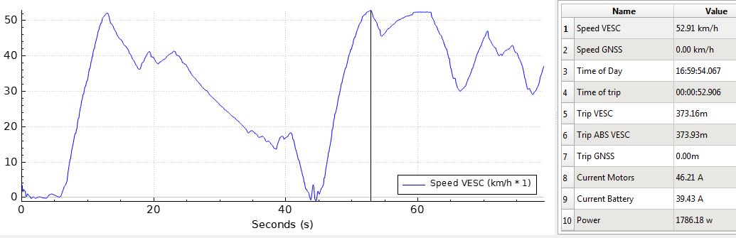

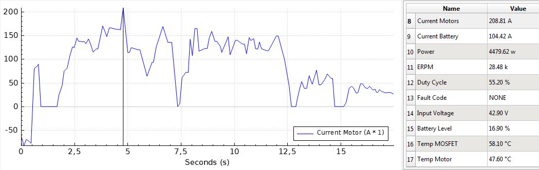

208.81A motor and 104.42A battery (4.48kW), that’s a tad above the set limits (100A/50A each vesc)
New personal top speed 52.91km/h and crazy fast acceleration from standstill with 100A motor amps.

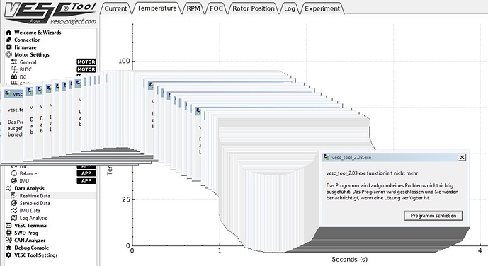

Houston I still have a problem with jumping values but not noticeable during riding today. It was such a sick ride I still can’t believe it. Even Vesc-Tool liked to party
The motor temperature jumping and cutting out it’s a know issue that has been mentioned time and time again by me and others and nothing has been done, it’s pretty simple to solve with a rolling average or another filtering technique. Maybe now that you are on board you could do something @Deodand :grin:

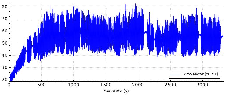

The root of the problem was not the HW it’s every version of the FW4 :flushed: The telemetry data has serious issues!
As mentioned downgrading to FW 3.62 never worked but with FW3.65 it worked to my surprise.

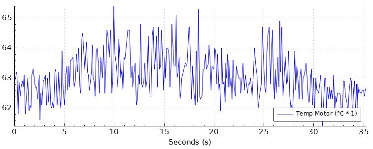

TADA! With FW3.65 the range of jumping motor temp values is 3°C, with FW4+ it is 40°C!!!
