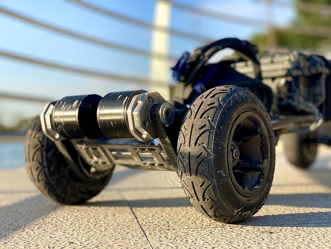

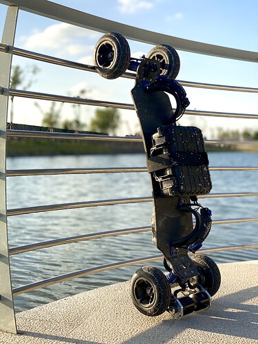

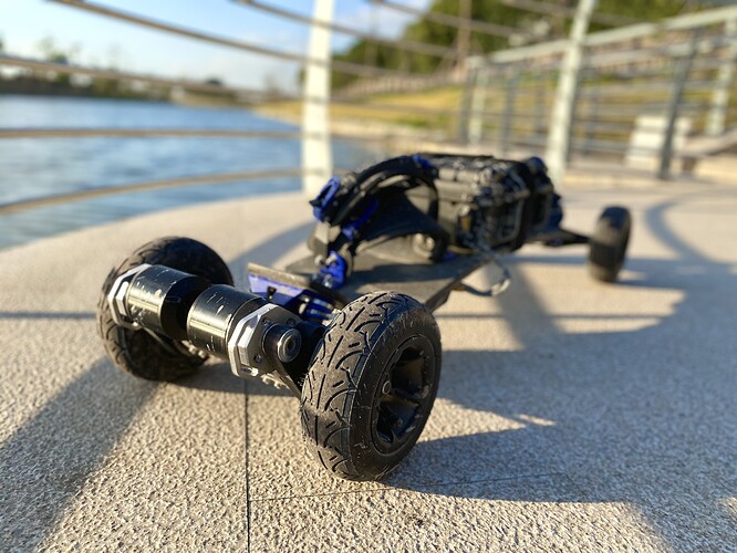

It’s ultimately a street biased MTB build as most of my riding is done in the city, with the occasional track runs, but I also wanted the ability to convert the board to do some lighter offroading on jumps.
Overview
- Trampa Carveboard Deck

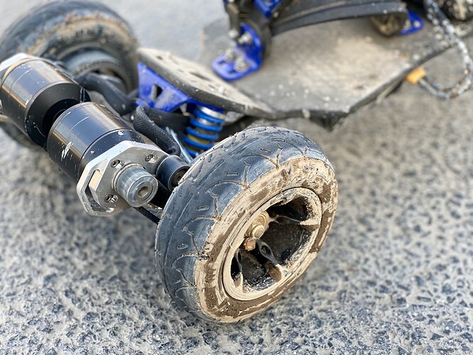

- Mini Spring Trucks w/ Yellow Dampas; Vertigo in Inner Position (F), Infinity in Outer Position (R)
- Trampa Ratchet Bindings + Heel Straps
- Private Batch Etoxx Clones 6061-t6

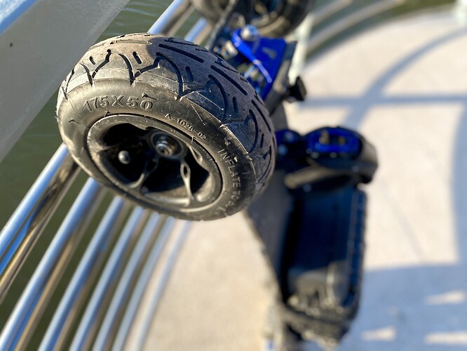

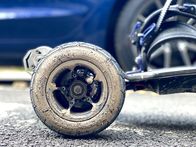

- Evolve 175mm Tyres / Prototype 150mm Race Tyres
- @IDEA Motor Mounts w/ 15/56t Gearing
- Custom Undermount ESC Enclosure
- 12s5p Tesla 21700 Cells w/ ANT 7-16s 40a BMS
- 2x 6s Tattu 12000mah LiPos w/ 2x External High Balance Current BMSs (1a Balancing)
- Focbox Unity
- Flipsky VX2
- 6368 Motors
- Modified Huawei Server PSU for a 40-60v 0-30a Charger (R4830G1)
