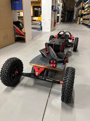

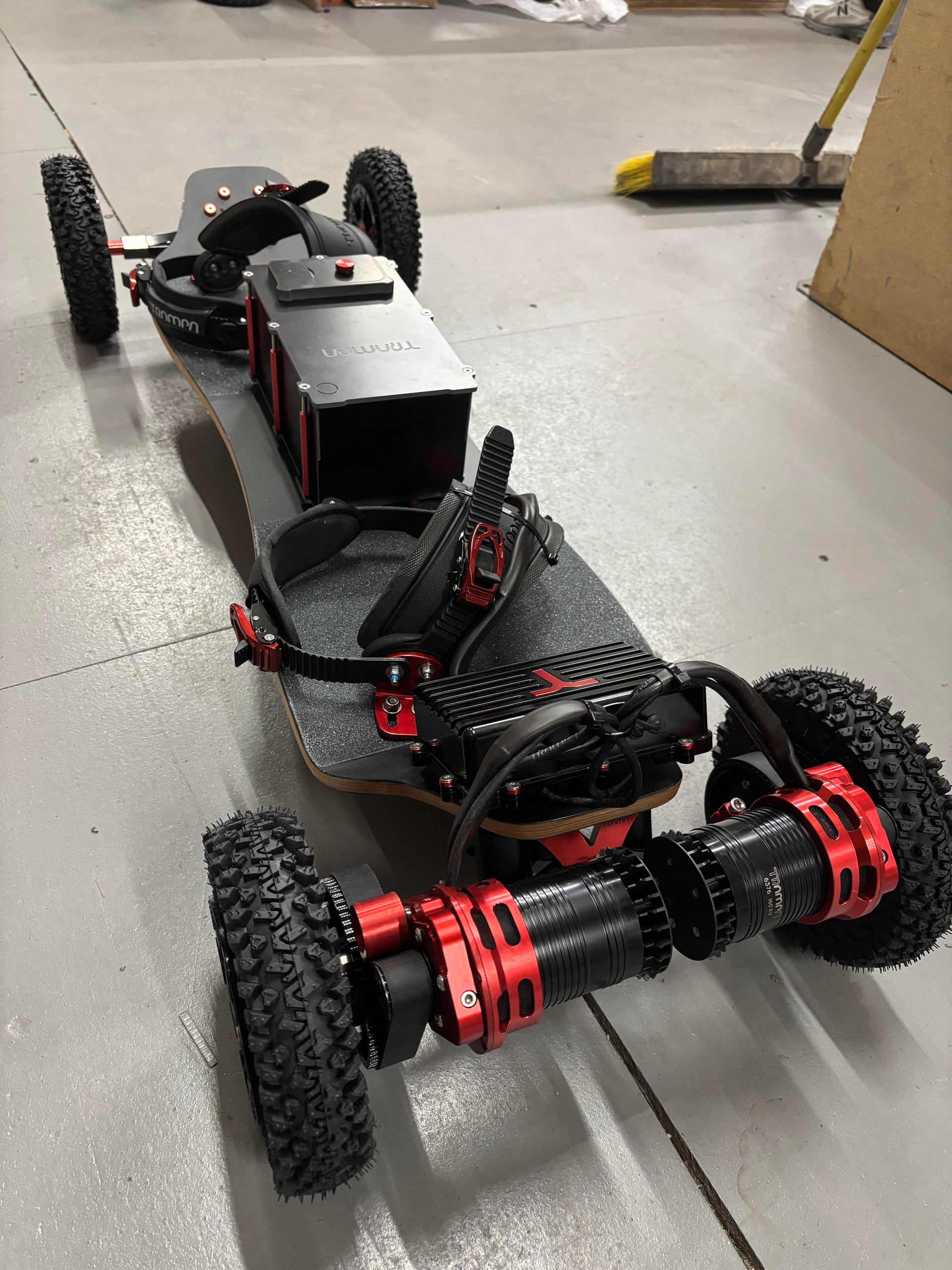

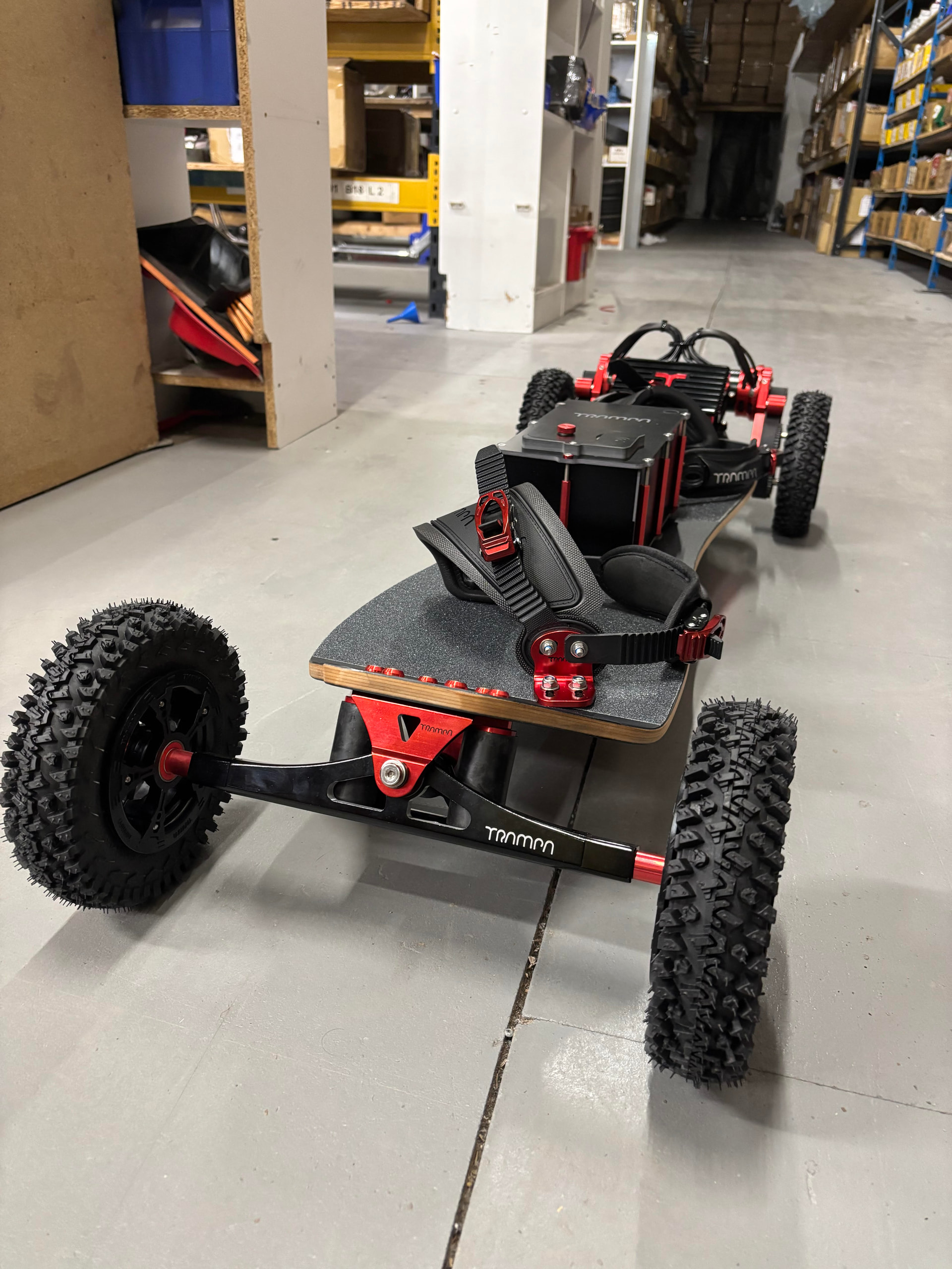

Not completely DIY as its all built from Trampa parts but I put this together using all the lightest parts! Comes in at just under 14kg, haven’t had a chance to test it yet as it hasn’t stopped raining for a month.
The new LTD deck

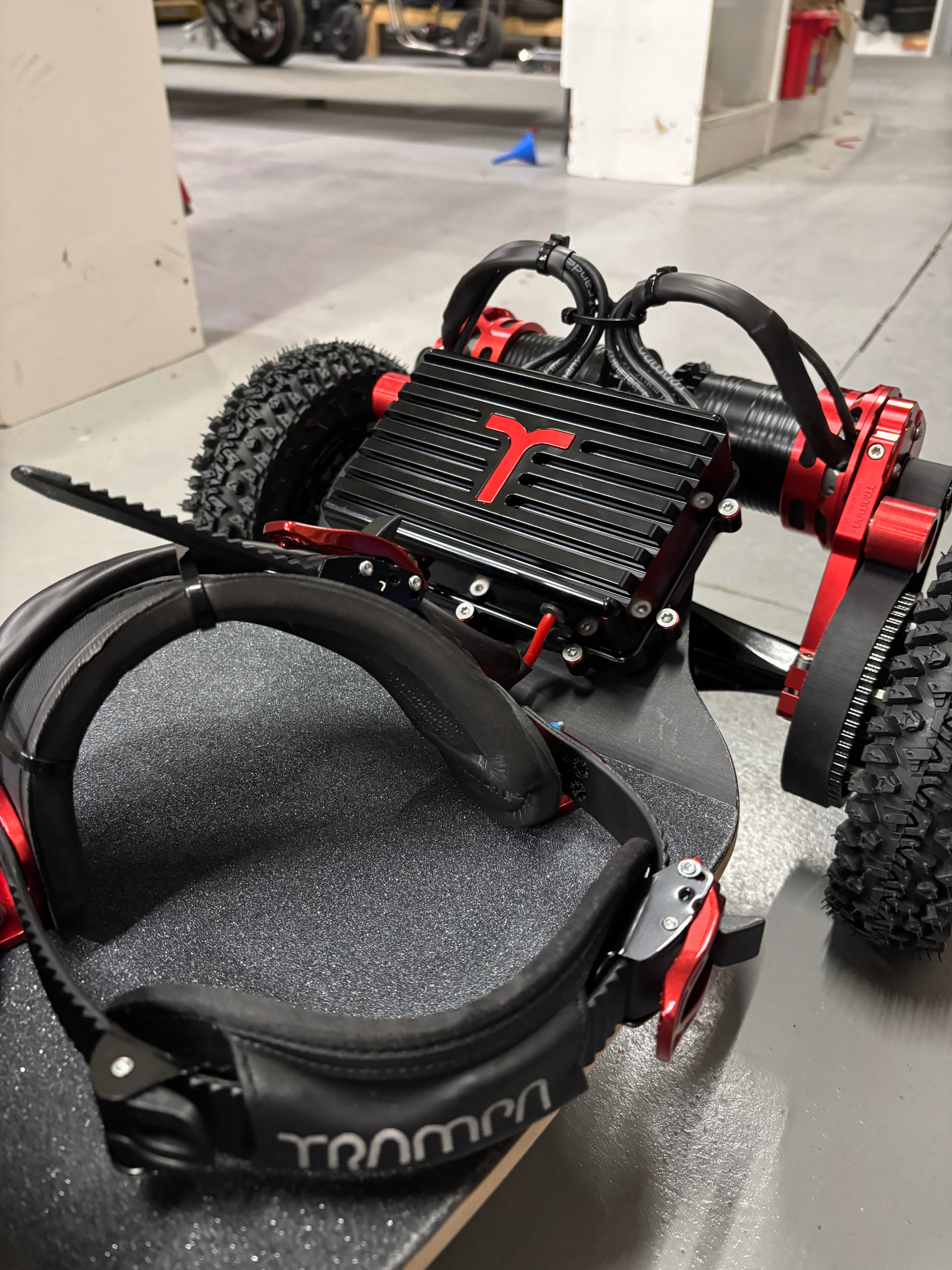

Open Belt Drive
Aluminum Vesc Enclosure
6376 160kv Motors
Vesc HP (for maximum ampage)
Beast box in the middle with two 10,000mah lipos, not all the range but this board is built for jumping so that’s not what I’m after

This is without the two 10,000mah lipos?
With the batteries!
