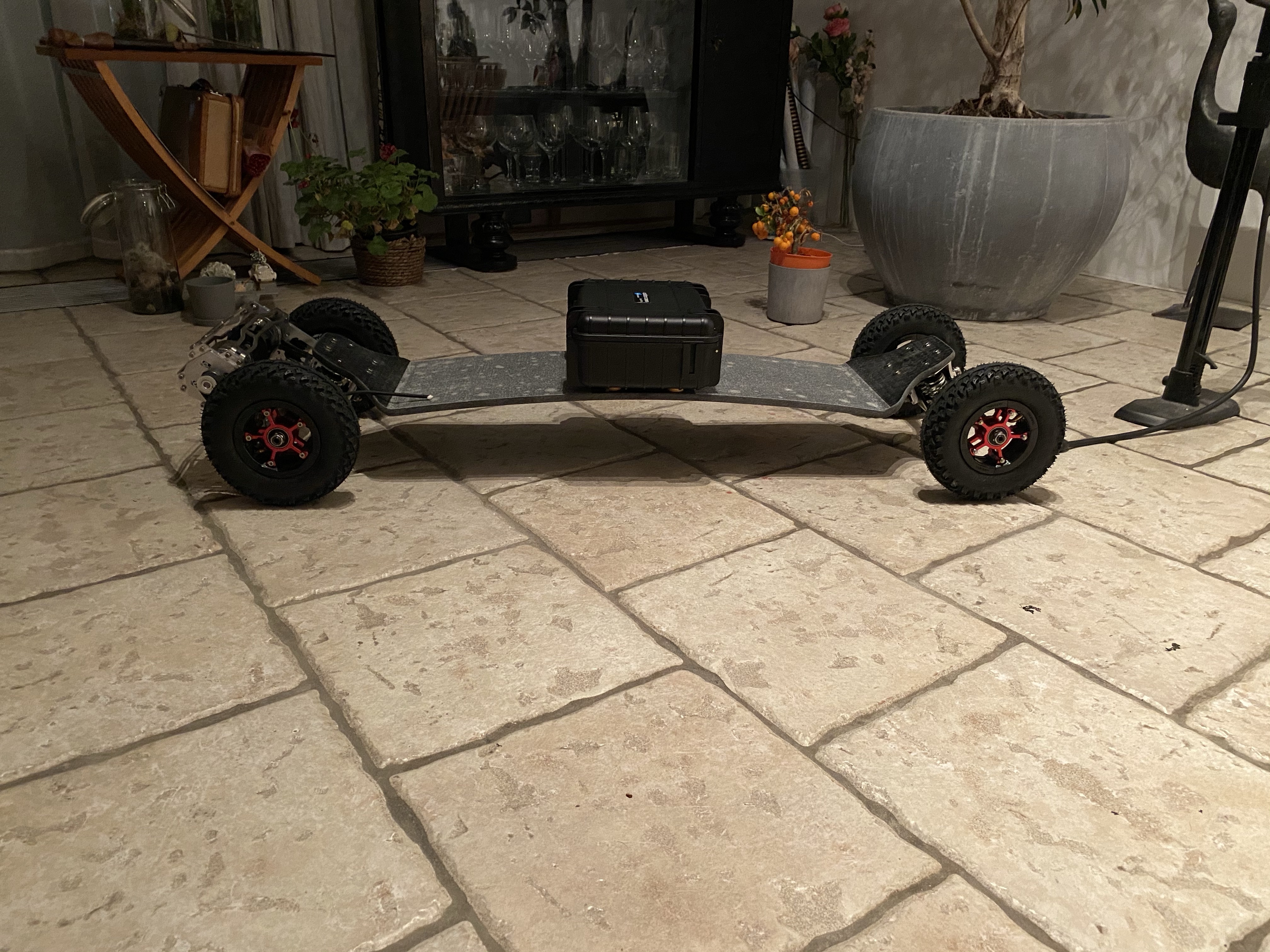

As I have gathered most parts, Just waiting on the mount/pully’s and wheels.
I was wondering if you could help me with what type of cables/nickel I need to use for the battery pack. The pack constant discharge should be 120amps acording to the esk8calculator so i would need to use 12awh wire at least right? I’m planning on using this diagram i found on this forum with eboardsperu 12s8p battery layout.
Decided to go with a top mounted B&W Type 1000 case. Would somone be as kind to see if this diagram makes sense ?

Some updates
Build the trucks/mounts/battery box
Build the battery but I managed the wire the bms wrong and it went op in smoke as soon as I put the charger in…
Pretty sure i messed the balance wires up… I did not use the B- wire and I am pretty sure I did the wires the wrong way around :poop:
The battery still works as i did manage to run the focbox setup…
Update?
I actually did completed the board+… But since I live in holland this board was just to big and drew too much attention in the end and I couldn’t enjoy it as much as a normal eboard.
