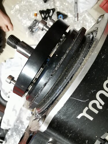

THE MADMAX UPGRADE
With TRAMPA DIRT-E-KART, this part appeared :
It was so beautiful and I had to try.
Little problem when assembling this new part on my 2019 gear drive : the screws that were sold with the gear drive at the time are too long…
At first, I wanted to buy shorter screws, but then I decided to shorten the screws by myself :
Those are pretty big 5 mm screws, so it was not easy, and I was close to strip my thumb with the lower part of the plier.
I’ll use gloves next time…
Then I could assemble the whole thing.
Then again, Trampa delivers too long socket cap screws there. They are 16 mm. I’ve used 12 mm ones.
