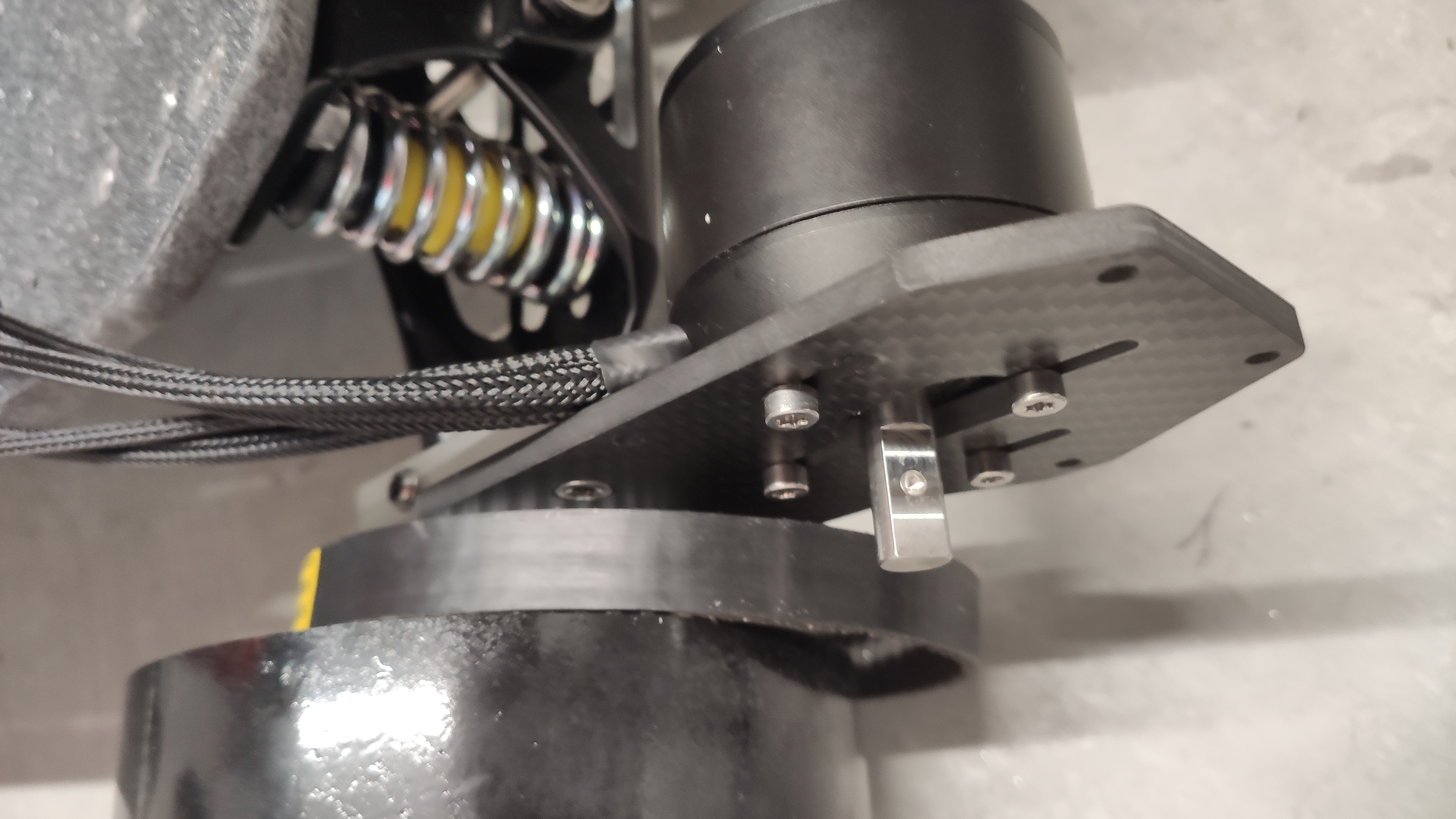

So i thought about disassemble the Flipsky motor.
Stupid idea. I damaged the screws, then the motor.
Again waiting for a replacment… God damn it…

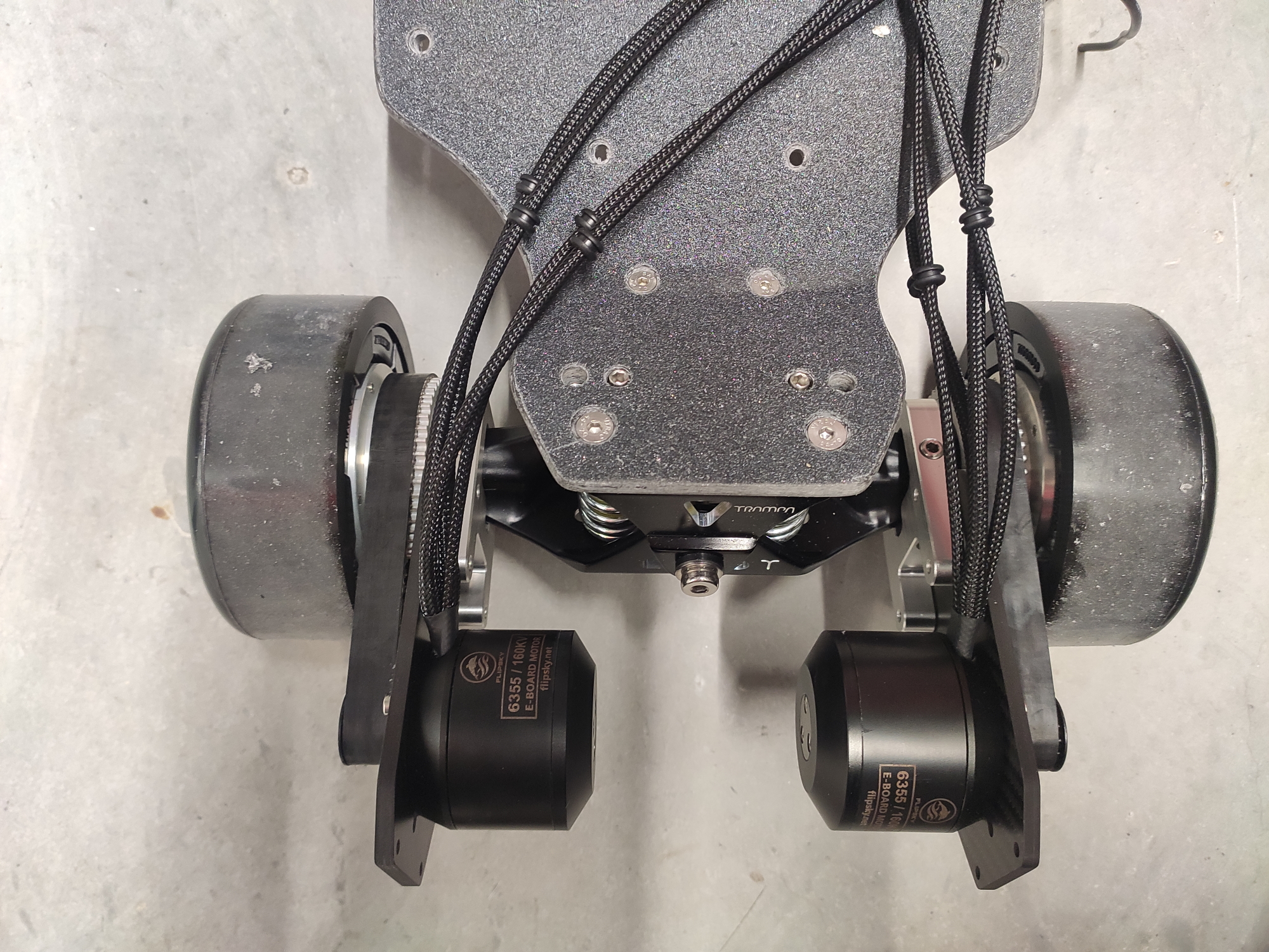

Asembling board and mounting the motor.
Then this happend…
It was not possible to tighten the belt.
After a conversation with Dave from Trampa, he send me two new belts (Thx Dave!).
The delay was not mentionable. The support was excellent.

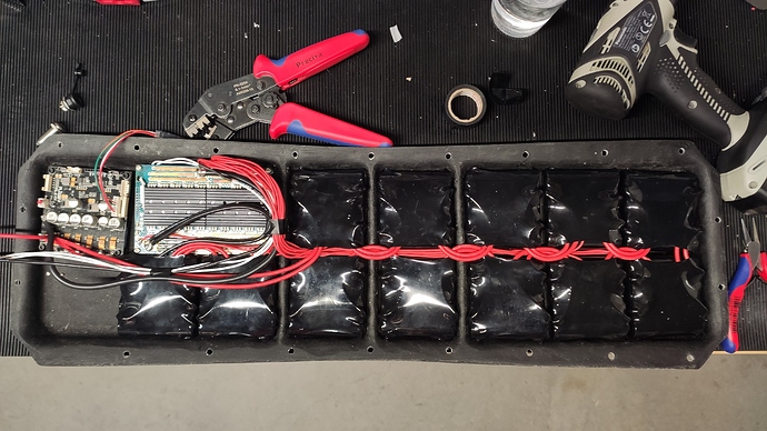

Starting building the battery and electronics.
As welder i used the DIY from malectrics.
I used black silicon to seal everything.

I destroyed several of my DC-DC converter.
At some point i finally got some information about my problem.
Adjustable DC-DC converter have problems with high voltage difference and high ampere output.
So i changed it to an DC-DC Constant Current Step-Down LED driver.

I use the Trampa Mini Vertigo Trucks.
The Trucks are mounted in Urban Position.
Removed the Dumpas, moved the springs to outside position an tighted the springs.
I cant get faster then 30km/h because of speed wobbles.
When i move my body weight to the front position, it is getting better but still far from stable.
Next i will try to get some video feed if necessary.
Any idea to fix this issue?
The reason:
Springs only lead to wobbles :man_shrugging:
What’s your weight and which ply is the deck? I’m curious why the inner spring position with yellow dampas is not carvy enough for you.
