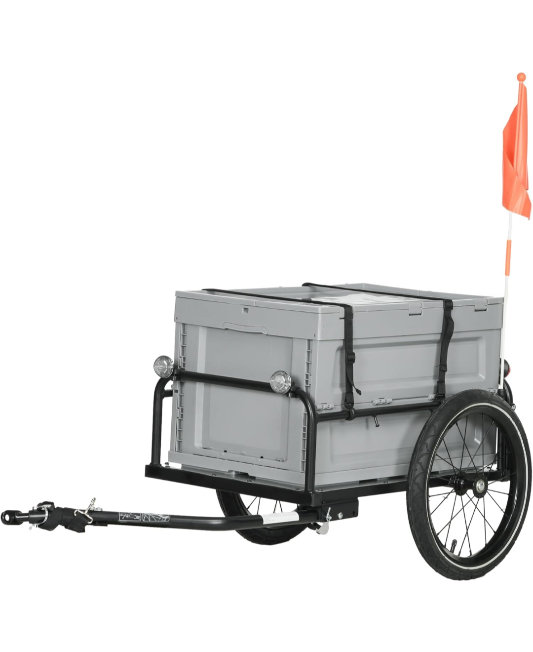

I’m looking for something that will hold toolboxes and work stuff and that will be able to tow behind the esk8 without worrying about it tipping or breaking.
This is what I’ve considered so far:
https://a.co/d/6NNnm23
Tl;Dr: post your trailer experiences and recommendations. Also powertrain choices for hauling.

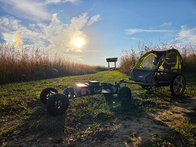

Also Been a couple others around here who hauled kids in trailers

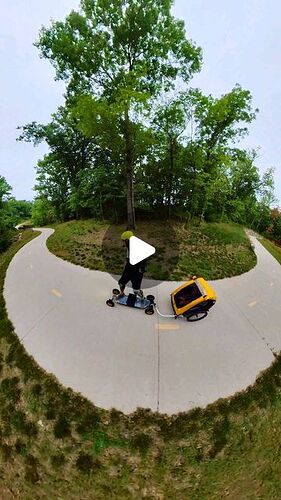

Towed my kids and beer around (separately) and it went fine. Standard bike trailer with a mechanism just like that to attach. Used an esk8 baseplate mounted upside down on top of my rear truck to mount it. Stole that idea from @rafaelinmissouri I’m pretty sure.
Trailer and esk8 is a good combo.
I put mine on a high torque Mountain Board.
If you carve hard you can tip it over.
I have tipped all 3 kids over… Each at a separate time…
But around 20 or below it’s fine.

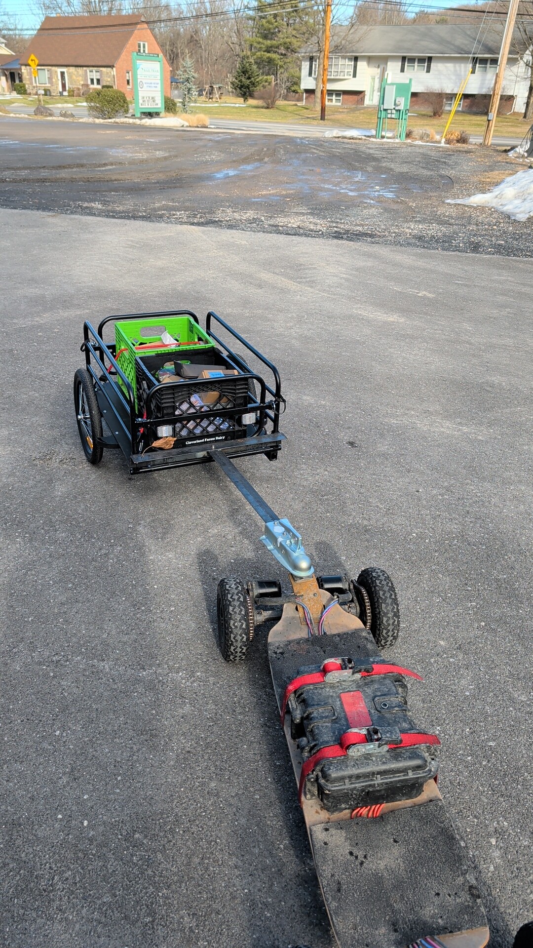

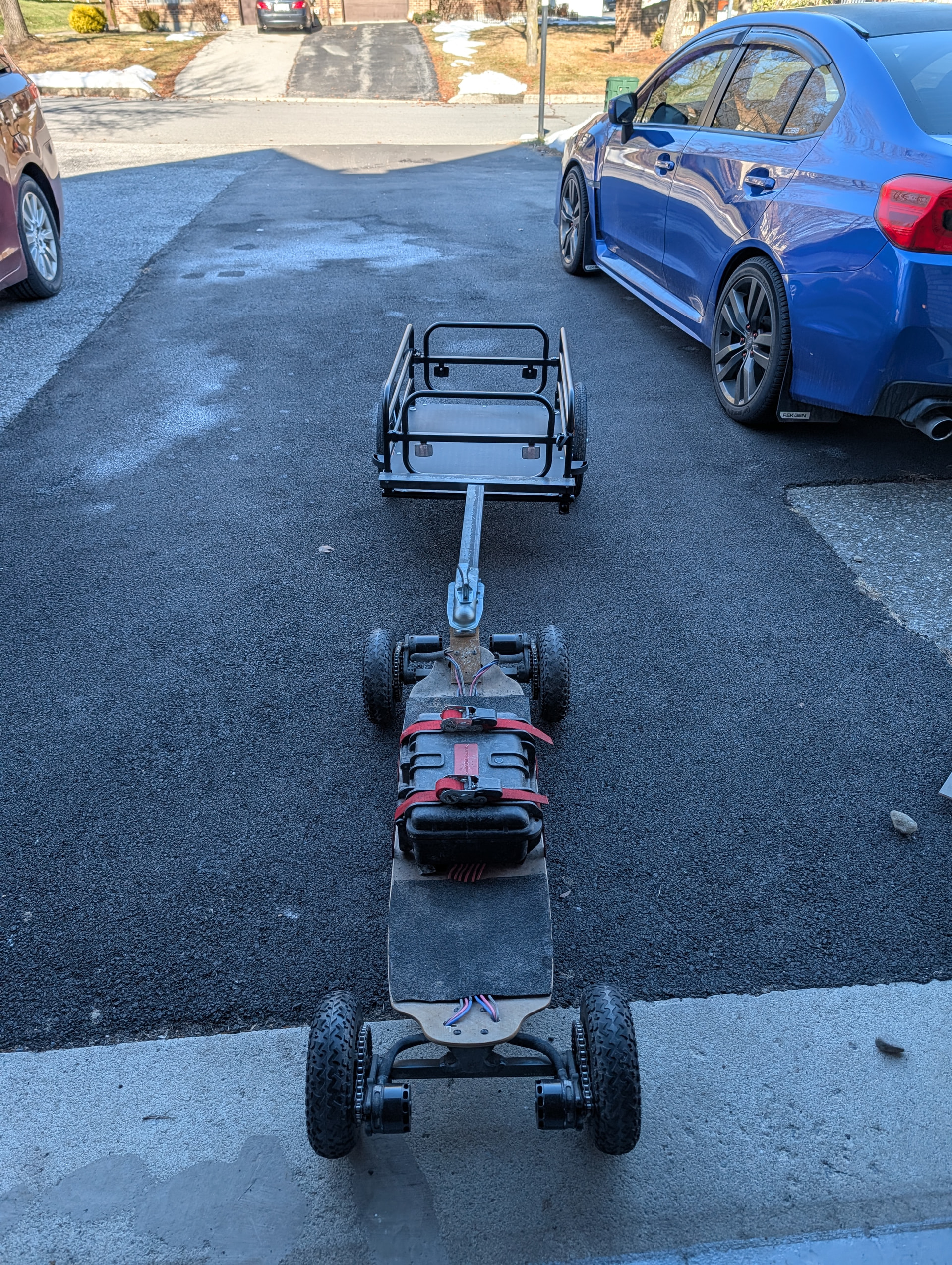

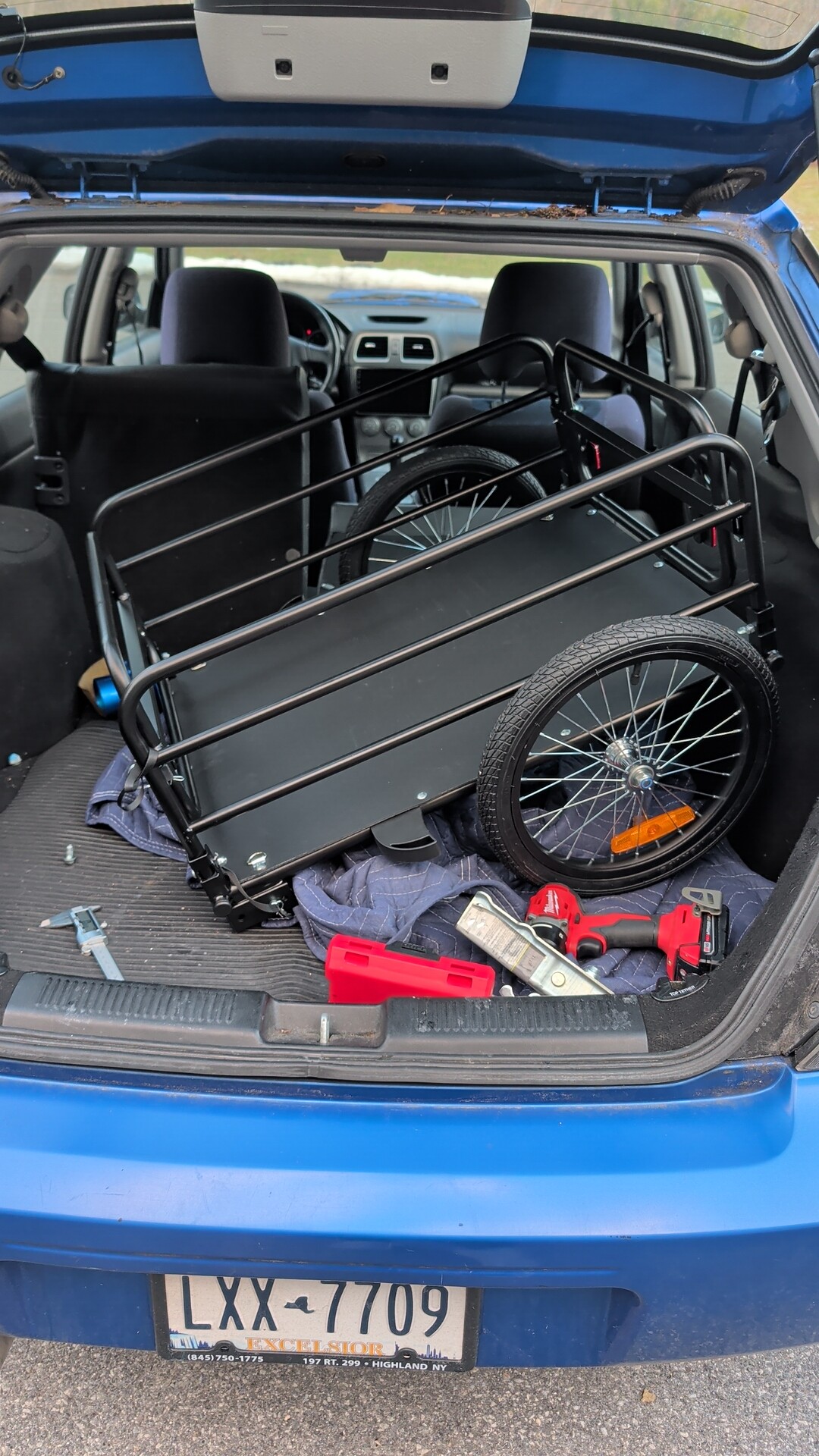

Vevor bicycle trailer, I threw a 1⅞ ball hitch on there and it’s been fantastic thus far. 20mph and it feels good, I can def go faster. The entire arm has more flex than I’d like, so it’ll likely need to be updated. The entire thing kinda oscillates while riding but you don’t feel it. Just see it.
I was worried that the ball hitch setup would have too much friction, but it works like a dream. Didn’t even grease it.

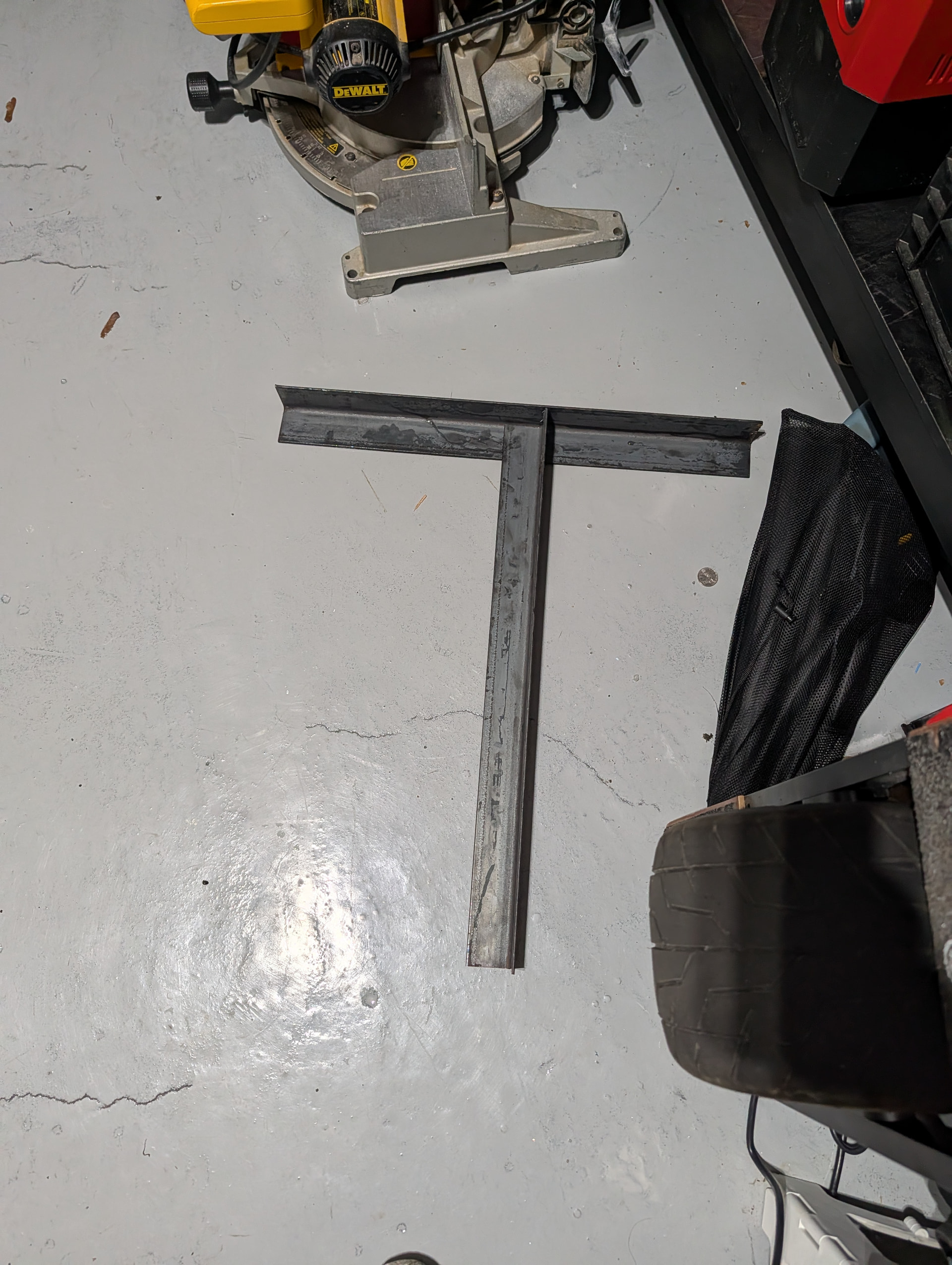

Made of 2x⅛” angle iron.
Emotional support euc (load test)
Wayyyyy too much flex for a 110lb load (50kg). The angle iron is twisting hard. I think I gotta replace with square tube. It was getting really bouncy around 18mph (30km/h)

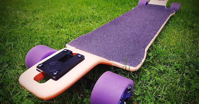

I stumbled across this thread and did some searching for hitches off the trucks. I found this old blog post about the Longboard Larry hitch mounts, which I can’t find for sale but these look decently good, plus using a rear truck only longboard for the trailer.
