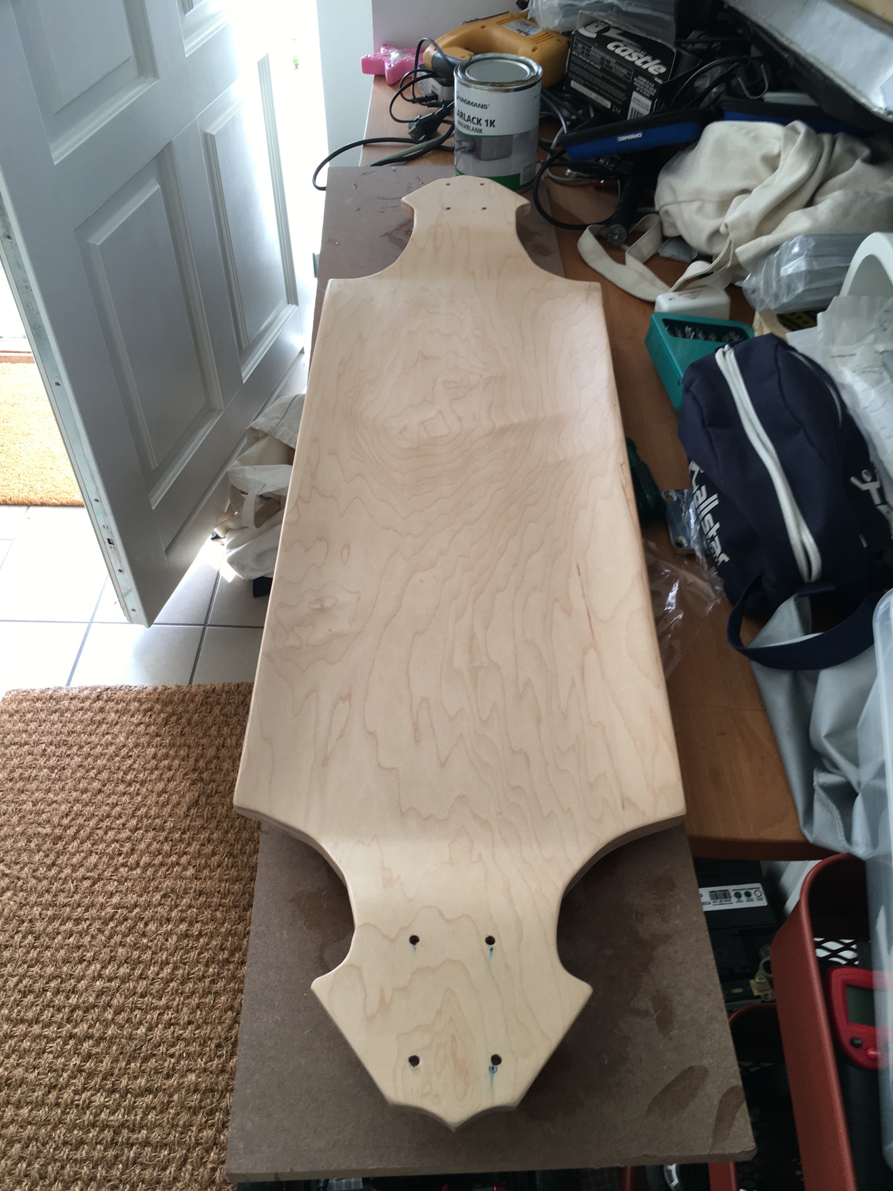

Today I finally had a new deck ready. I have had Redembers Obeah6 and the Xapham on the track. The Obeah6 wheelbase is 10 cm. (3.9inch) shoter than the Xapham. When on the Obeah I felt I could use a lager deck to be more stable and when on the Xapham it felt to long, making it harder to make the the turns.
So I made a new deck with a wheelbase in-between the two. I cut the deck as wide as possible as I want to try a really wide deck. Will properly cut it very narrow later to try that and see what feels best.
Over the last year I have adjusted my setup to get the right “feeling” on the track. Every time I was left unsatisfied. It has mostly been the turning that didn’t feel right. But with this new deck I am really close. This wheelbase seem to be perfect for this track and the 3-link trucks.
For the first time I didn’t feel that the setup was the limiting factor. The board did what I wanted it to do and I felt that it was only my skills finding the right speed and line that was the limiting factor. That felt awesome. Now I can concentrate way more on my riding skills without getting irritated at the setup.
The wide deck (30cm/11.8inch) felt good. Even though it is wider than I have tried before I didn’t have to move I front foot as much. This would be from the better turning I have now. It felt really stable and good to grab.

The new deck - roughly cut:
Complete board
IMG_0216
So how how did u just make that deck?
Ha… its been a long proces. First I learned how draw in fusion, to make the drawings of the mold. Then learning how to use a cnc to cut the mold. Then all the other stuff. I am far from where I want to be, but this is a good start and it works pretty good. Fortunately we have good people here to torture with questions.
I dont want to derail your thread, maybe start another one on the deck lol? That is crazy, looks like its a drop down too. That blows my mind, id love to see how you did that. I think your really onto something with the wide deck too. Let me know if you want to get rid of that one for another build Id love to give it a tilt!

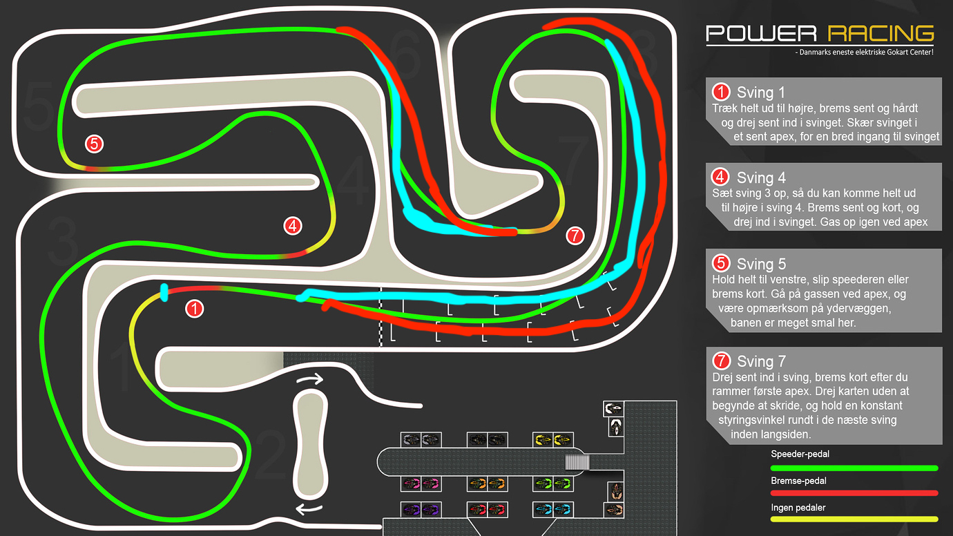

I put the advice I got last time into action today. Mainly concentrating on cutting two lines on the track. First one being the one where I am closest to the camera where I need to be close the the barrier the camera stands on. Second one the straight soft curve where I need to be close to the barrier closest to the camera as well. And then starting the hairpin after the straight later. (Not on the video).
And then concentrating on being smooth.
I had a lap that felt really good, so when I came to the straight I gave it a little more than usually. That lap I cut 0,68 sec. of the previous bet lap. Wow. But I must say that I couldn’t continue. My front of of totally off and wouldn’t have made the next hairpin. But it was a new best lap. The next couple of weeks I will work on consistency. Doing fast laps again and again and…
My focus was to follow the blue / green line where I before have done the red / green line.
That means that I before turn 7 have a better angel to do turn 7.
I sjould start the turn at the blue dot at turn 1. I have initiated earlier. Turn one is one they “sacrifice” in order to get quicker out of turn 2 where turn 3 and 4 are not hair pins and the speed can be greater.
EDIT: I think the main reason that I improved that much today, was that I also was more on the throttle sooner out of the turns, But that is possible only with the line is correct.

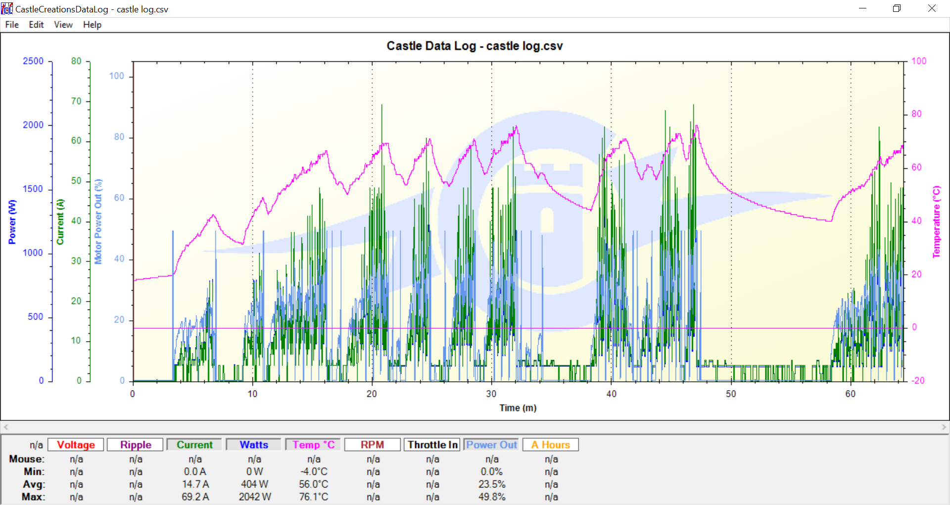

@RyEnd here are the log from this week. The spikes just befor the 50min. mark were the fastest lap. As you can see track doesn’t require that much power.

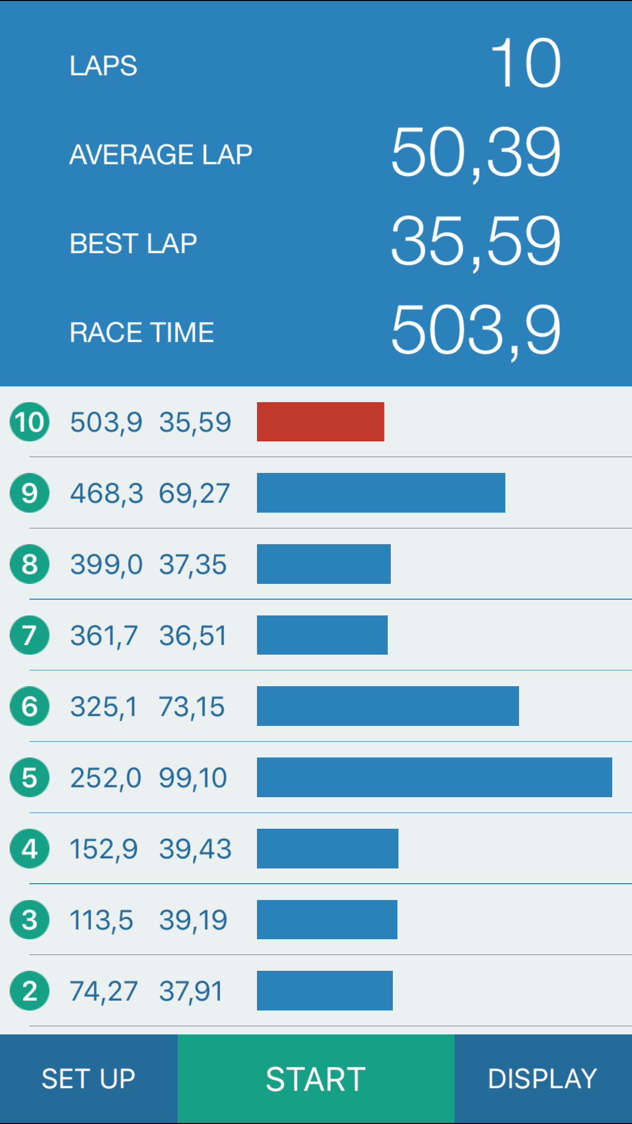

I see lots of areas where I can improve in style and line. Next goal is to get below 35sec. I got a new fastest time today with 35.43. I think below 35 in within reach.
