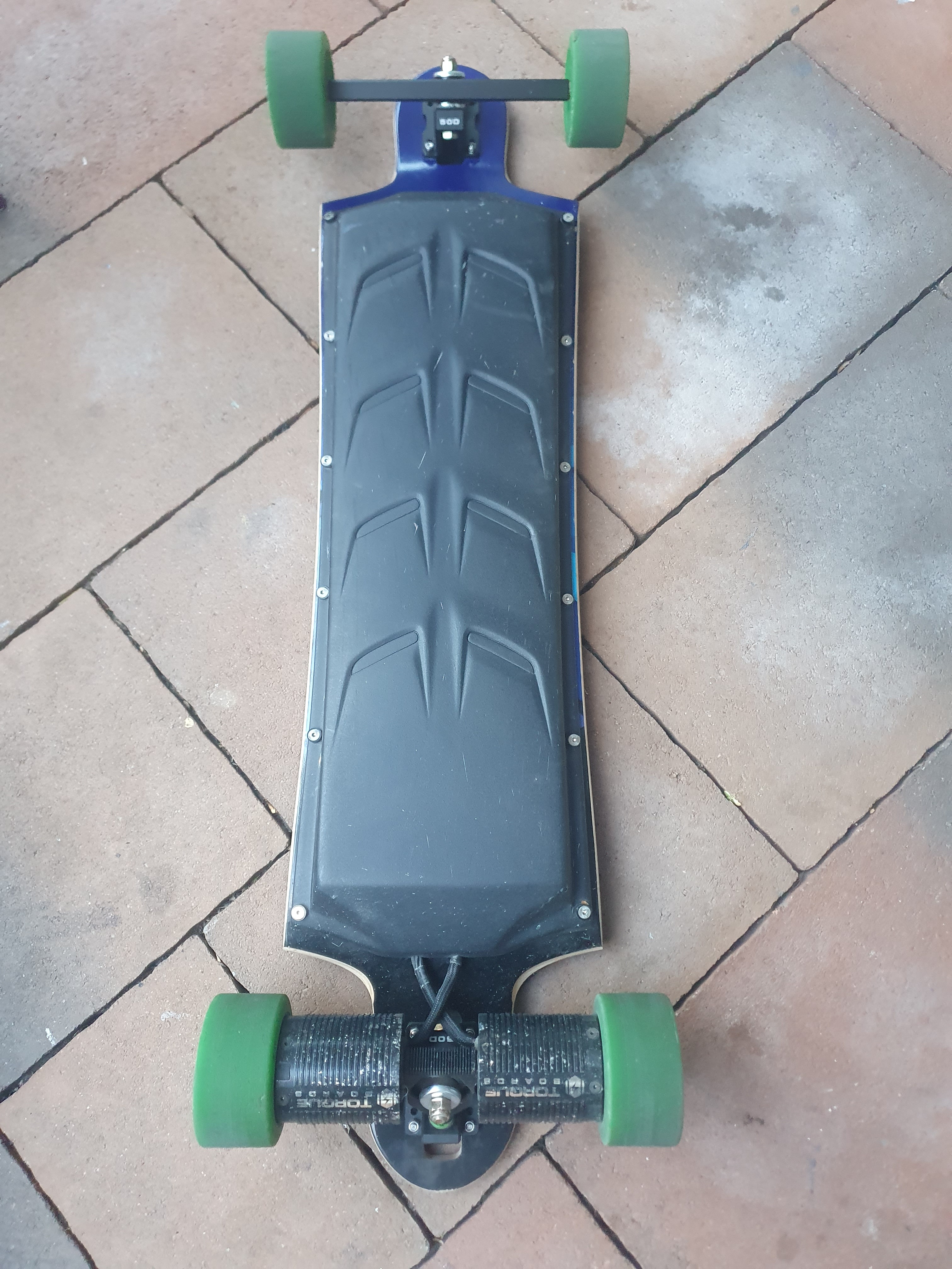

All parts have now arrived and I did an almost not incompetent job at putting it together.
No clue how to properly solder these : https://www.amazon.de/DeLock-Steckverbinder-5mm-Buchse-Einbaubuchse/dp/B00FWP5EYK/ref=sr_1_3?dchild=1&keywords=5.5+2.1+buchse&qid=1597395440&sr=8-3 so I did a pretty bad job and will have to get a new one for permanent install and get somebody who is competent to solder it for me/get one that is easier to solder. Until then I use WAGO clamps to mount the port when I want to charge and keep an eye on it at all times while charging.
I’ll also have to move the unity a bit further away from the motors to not bunch up the wires - somehow the double sided tape I used to mount it and the battery work about a dozen times better on the unity than the battery so that will be fun to do… At least the enclosure is big enough that I have absolutely no issues with space.
I’ll also have to fine tune the other four enclosure mounting holes and then epoxy the threaded inserts into place, but that shouldn’t be a massive hassle. Now I just hope that the blue TB110 come into stock soon - or I get the black ones to get the package from dexter sooner since that will also have a replacement axle for the one that is slightly bent…
Oh and i need to install my rear cross plate, but then I’m all done.

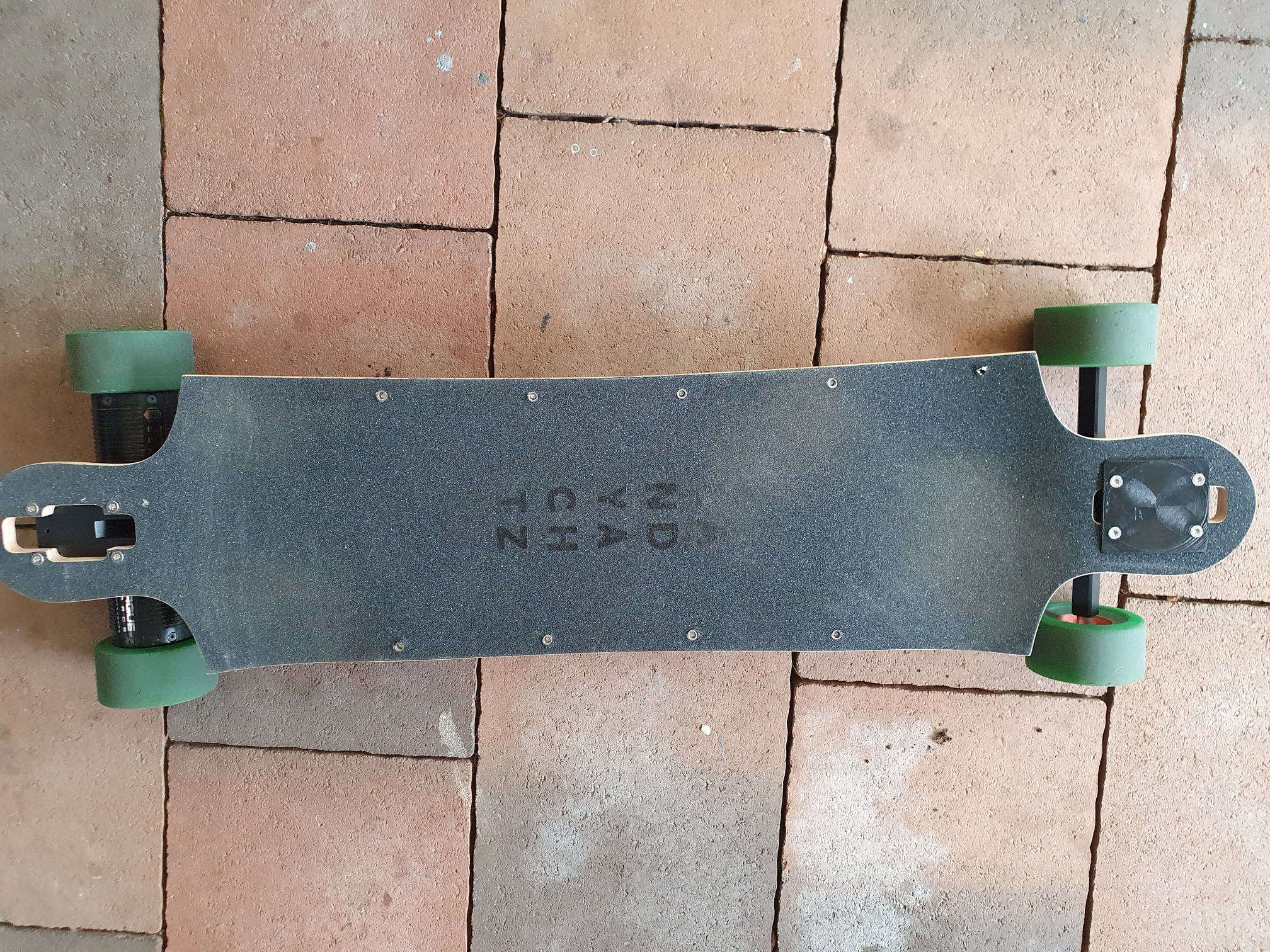

First ride today was beautiful, once I went down to 20A battery discharge. 44kph max, the acceleration curve is awesome.
Tb110 in black are ordered
And i need to install the dope grip

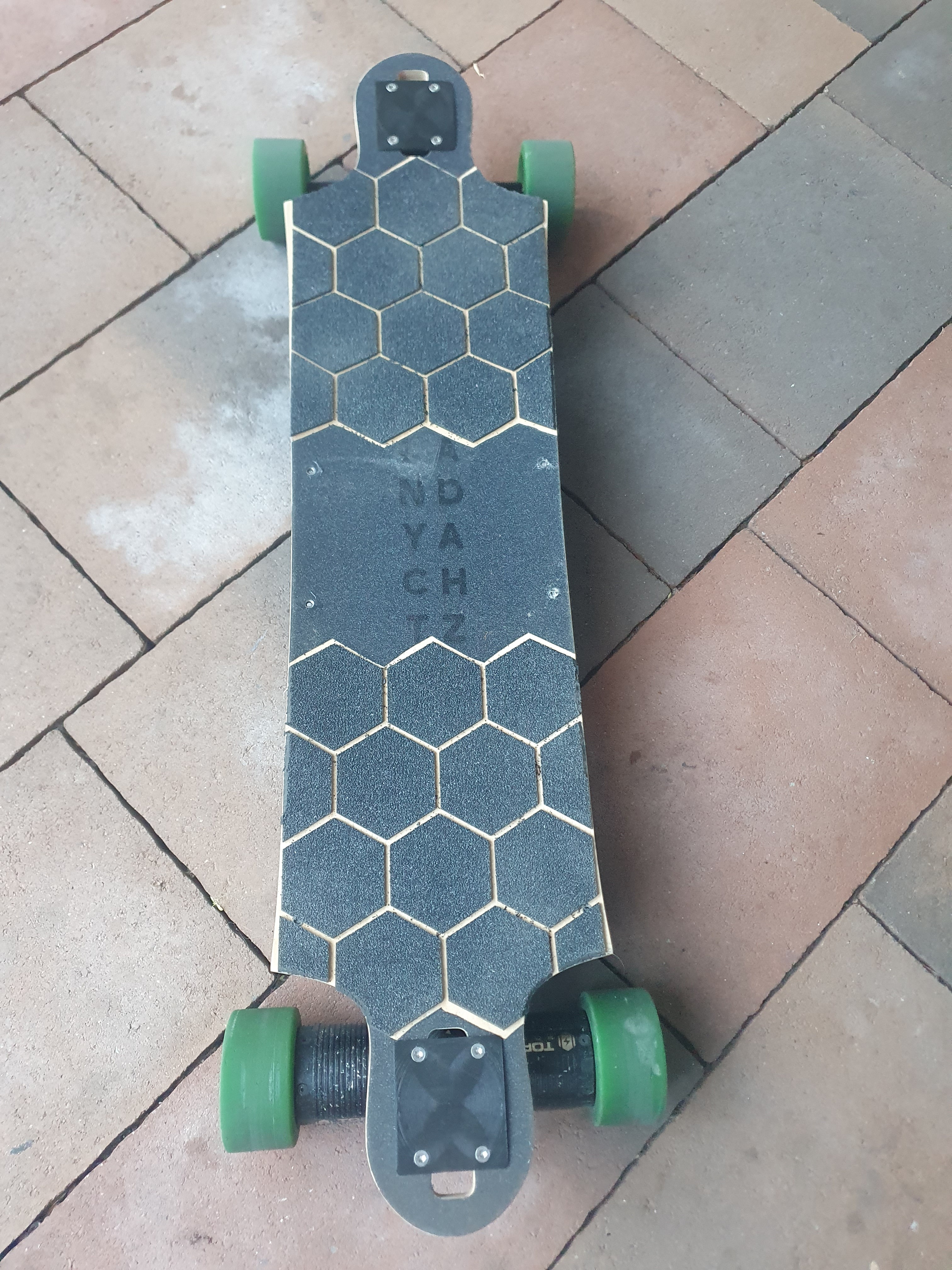

May I present, the almost final form of my board. Please note the lack of power button and the crappy job I did of cutting hexagons in my griptape. Surprisingly, the overall look is great though.
Only missing wheels now. Oh and I’m paying a 200 dollar idiot tax because I didn’t order them with the motors, need to get one new axle and Dexter doesn’t offer free shipping on international orders anymore…
Oh and I designed and printed the cross plates myself. Nothing fancy but looks better than a hole and is a nice starting point for light mounts etc
