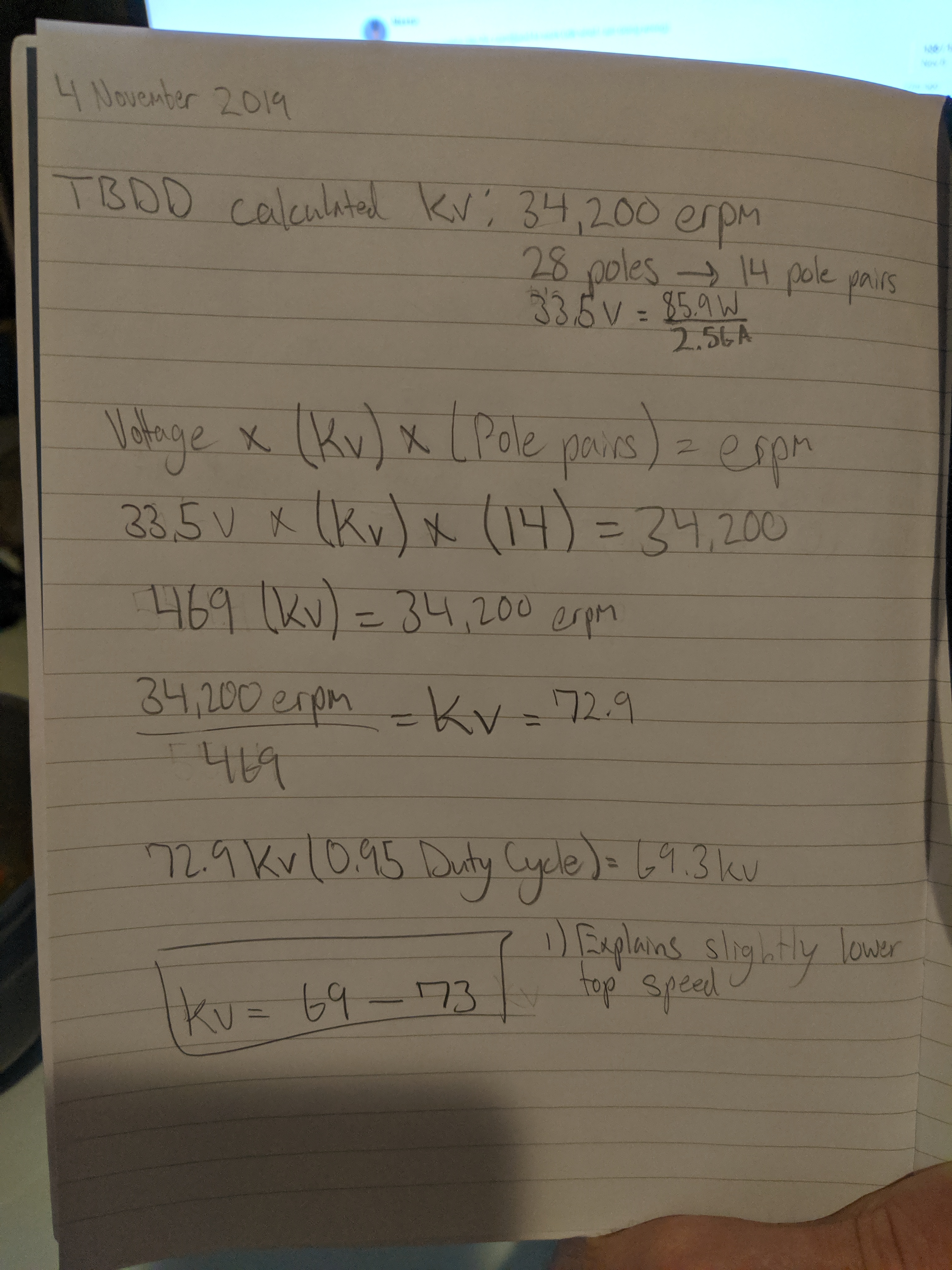

I calculated the Kv of my 75Kv set yesterday and it comes out to 69Kv (Nice). 10s, 110mm wheels gets me up to 28mph per the Unity app. I wish I could break 30mph on flats but I can always up the voltage later. I understand motor winding is never exact so I’m not complaining.

How did you calculate that?
With VESC detect?
I have never gotten the Kv command to work (idk what I am doing wrong).
I bookmarked this a while ago.
and here’s my math
This is great, thanks! I tried doing this to my VESC data logs… but since it doesn’t include ERPM, I had to add in some math to convert speed to RPM.
If you log data to MPH or speed_unit=1 then feel free to try this:
  1. In order from the first empty cell on the far right
  • M3/C3
  • (F3 * 0.44704)/(53.5 * 0.00010472) replace 53.5 - make it your wheel radius or diameter/2 | replace 0.44704 with 0.277778 if you log in kmph
  • (U3/T3)
  • (V3/E3) * 100
  1. Drag all these formula boxes to the bottom of the document to calculate all values
  2. Autofilter column M and hide all less than however many watts of power so you don’t get divide by 0 errors. I hid anything less than ~2000W.
  3. If using excel, use SUBTOTAL(101,range) to average your KV calculation ignoring hidden rows. If using Libreoffice, SUBTOTAL(1,range) works. In an empty cell:
  • =SUBTOTAL(101,W:W)
That should basically be your average Kv, calculated from your VESC logs.
