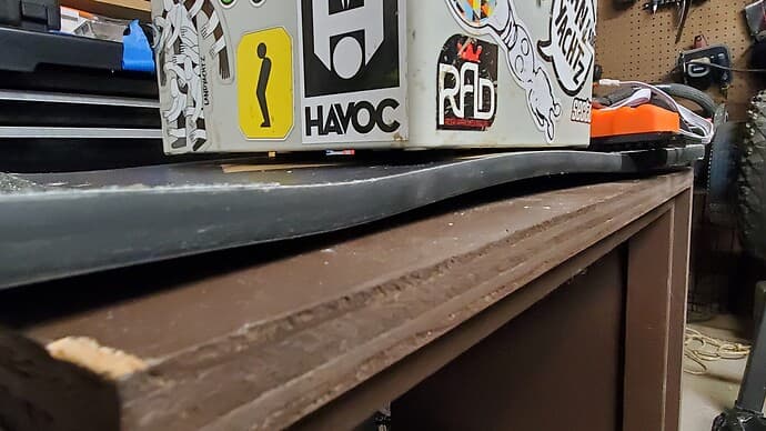

ATM I have a dw2 deck with a similar 12x8 inch “ish “ carbon fibre box. I’ve have 2 6mm bolts with locking nuts and washers on the centre line (slightly off set so didn’t create a weak spot between the two holes.)
Again some foam (yoga mat ) between the deck and battery box.
It’s sold I’ve flipped my board multiple times at speed and it’s lived and not set of fire (always a bonus). Forgive the background me and my grubby projects are relegated to a storage cupboard.
