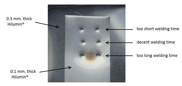

The main thing I want a community review of is the spot welds. I think there’s a few that may need a do over. In the photos I’m putting in I pulled back the fish paper to get a look. The p groups have 3 different welds. We’ll call it 1 2 and 3 based on what looks like 1 acceptable to 3 Im not too sure the top layer is good enough.

Type one looks a bit too hot but I wouldn’t redo it, type two doesn’t look bad at all to me, maybe slightly too hot but good enough, type three looks like it’s not sticking well enough, those I would preferably redo.
Can you get a finger or a plastic tool in there to try and pry up the nickel strips at all? That is how I would test the strength of the spot welds since if it is welded on properly it won’t really budge but a bad weld would easily break off. Don’t put too much force though as you could end up ripping the nickel strip itself if the weld is good.
Found these nice visual guides from a published article that should help for a non destructive test:
Thats a nice summary in photos. Thank you for that! I tried to wedge a credit card under those weak looking ones and put some leverage to them no movement.
I think there is some serious nitpicking going on here in terms of welds, all of these look passable to me. It is odd how the type 3 shows stacked nickel strips tho
Welds look pretty good. All that matters is that they hold, give the battery a good cycle or two and see if it charges to full
