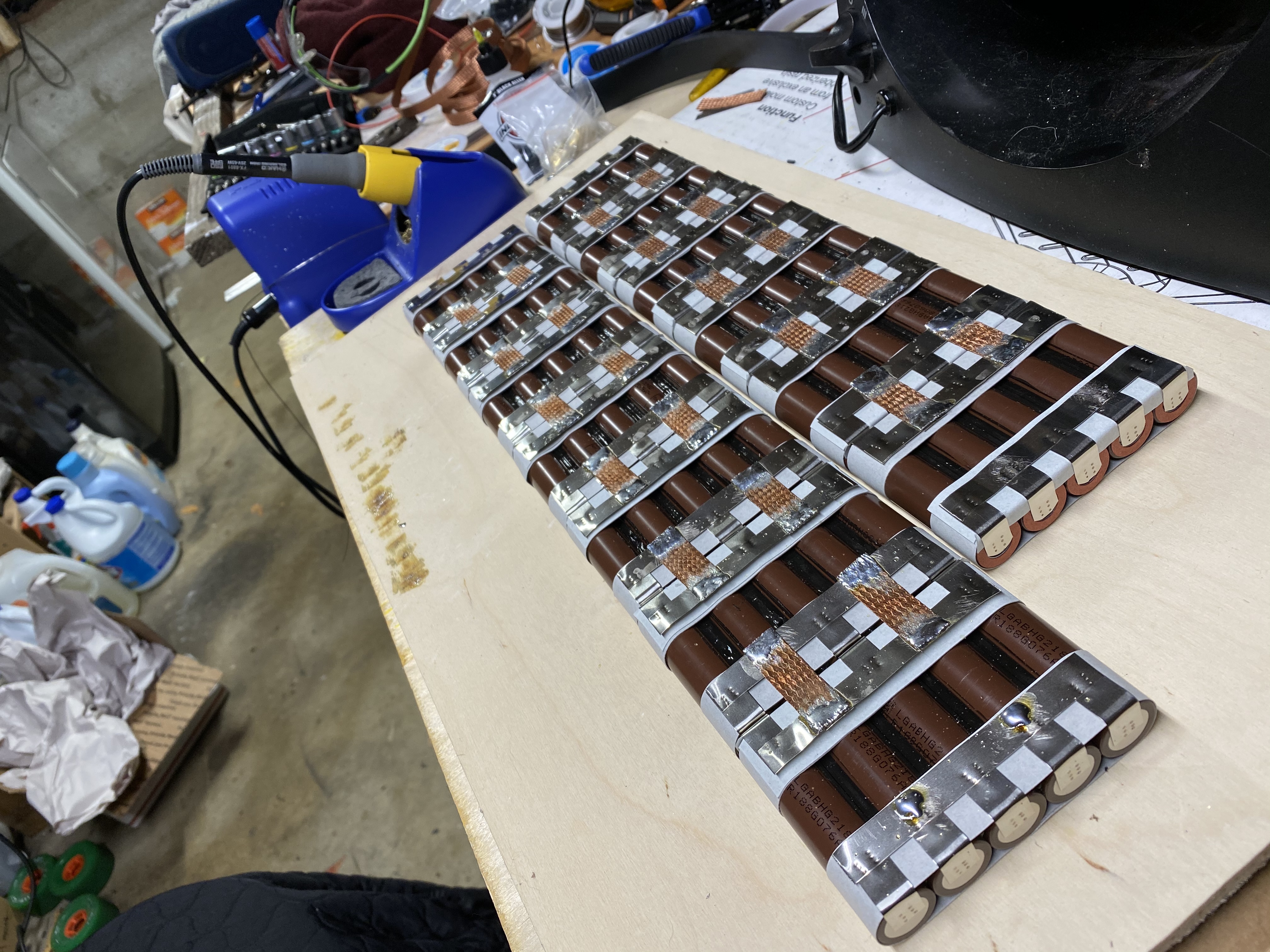

Takes a little more time but this is how I’ve wrapped my past couple sets. Trying to figure out a way to get a wireless temp sensor placed middle of battery in enclosure to actually do some real world comparison. Until then, it’s all conjecture
RIP this battery. Pull out your loopkeys, folks!!
Damn bro, that is looking goooood.
battery pr0n!!! sorry she had to go…bye-bye
