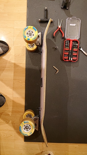

So another stuff I wanted to bring up, actually quick and simple idea. The fastest project I ever made :sweat_smile:
Would you guys be interested in alu or steel mounting plates to convert your street decks from tkp to Rkp? If I can get it cheap and solid. With custom shapes to match trucks hopefully.
Still needs work of course but overall it’s like that
Made it so you get the original wheelbase from tkp back. It sits lower than I expected too.
And it provides free bolt-ons for your enclosure too, so no extra holes needed basically.
On pic you have Paris V2 165mm shown (narrow truck looks better on slim decks.
(Edit : about the empty space between kick and the plate, it’s not supposed to be empty, still need work on that area)
Let me know your thoughts :kiss:

Yea but it would look sick (like a hot rod) and bring the deck lower to ground ! Tho you lose the kick, bit of a trade off.
looks like you can still use kick, no?
This is a cool idea but I’m not sure–what’s the utility in switching from TKP to RKP on a street deck?
Sorry edited my post, I was taklking about Gbomb mounts.
Yes you’re right, the kick is still usable with my plate lol
Well simply put you can put a Longboard setup on your agile street deck :
  • Rkp stability for speed
  • more space for enclosure and elec than with the standard tkp mount
  • still the nimble short wheelbase from original
  • as you said, you keep both kicks usable
And there’s more available motor configs for Rkp I think.

For thickness and material I’m thinking circa 5mm to 10mm depending on material, alu heated or steel for better strength.

it has just steering and LESS turning!
Not that good idea, if you dont dewedge both of them trucks.
Otherwise its pretty much steering with no possibility to lean into turns, for that reason its not that good.
best stability is to wedge the front truck a bit and to dewedge the rear. For the rear you can dewedge to 0 degrees, and the front to whatever 43, 45, 50 degrees. depends on how you like it the most.
I got my rear something like 30 to 35 and the front 43 degrees. So i can do hard turns and its very stable at higher speeds but stability depends on the wheelbase, too. Shorter boards get into wobbles sooner than longboard decks, thats clear.
Thank you for the tips!! Ok I’ll look into how to add and decrease wedge on the plates :+1:t4:
i mean the wedges in your design just not to levitate half of the truck.
Not sure if im right but i think i have seen it this way, that your baseplate is not supported in total length to the deck. You know what i mean?
The second picture shows the space where the wedge has to be added to match everything fine. Then it should be more than great imo for street decks!
I know you want to use steel as a very stable material, but i would definitely suggest some wedges if possible.
