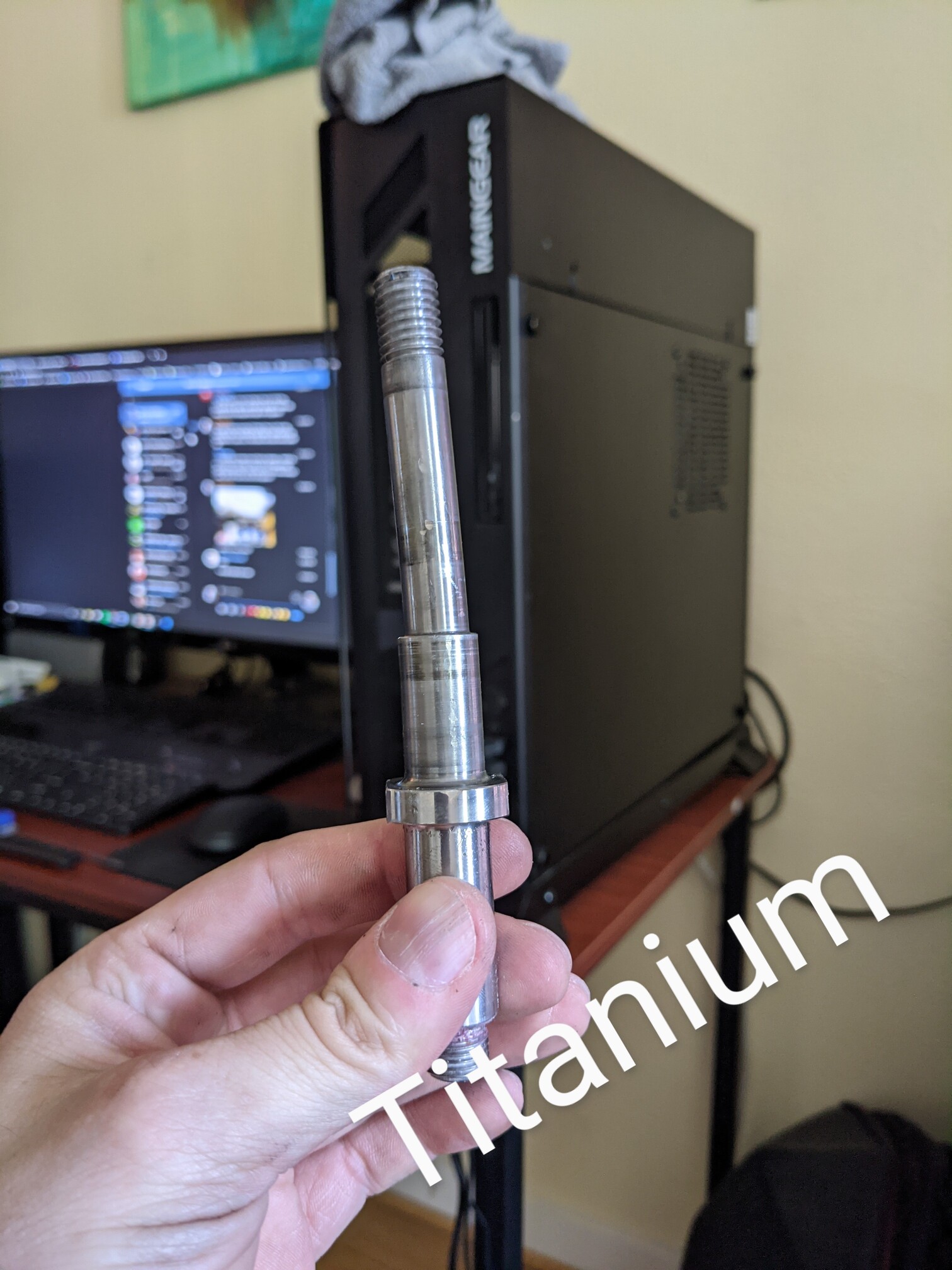

I know there are a lot of esk8 components made of 6061 grade aluminum. Wonder why there are not more components made out of titanium. Would love to see some trucks machined from Ti. I know Lacroix have some axles and bolts made of Ti.

Titanium is heavier than Aluminum and just not worth it.
Aluminium has an incredibly low specific gravity 2.7g/cm3. Titanium is 4.5 and mild steel ~ 7.8
So the benefit of Titanium is its roughly half the weight of steel but just as strong. This is why you see Titanium axels are hollow (cos heavier than alu but stronger and thus can be hollowed)

It’s all about strength/weight, and strength/cost.
Steel is very cheap, and can be very strong, but it’s also really heavy. Very good strength/cost, but medium strength/weight.
Aluminum is more expensive, and somewhat less strong, but is less than 1/2 the weight, so the strength/weight can be better, while the strength/cost gets worse.
Titanium is very expensive, medium weight, and medium strength (stronger than Al, but some steels are even stronger than Ti). Very poor strength/cost, and better strength/weight than steel, but not as good as high-strength aluminum, like 7075.

Actually, gears would be the worst use of titanium in esk8. Titanium has very poor wear resistance, and will gall easy. As Lee said, “its just board bling”. Titanium screws are cool and don’t rust, but still not as strong as steel.
