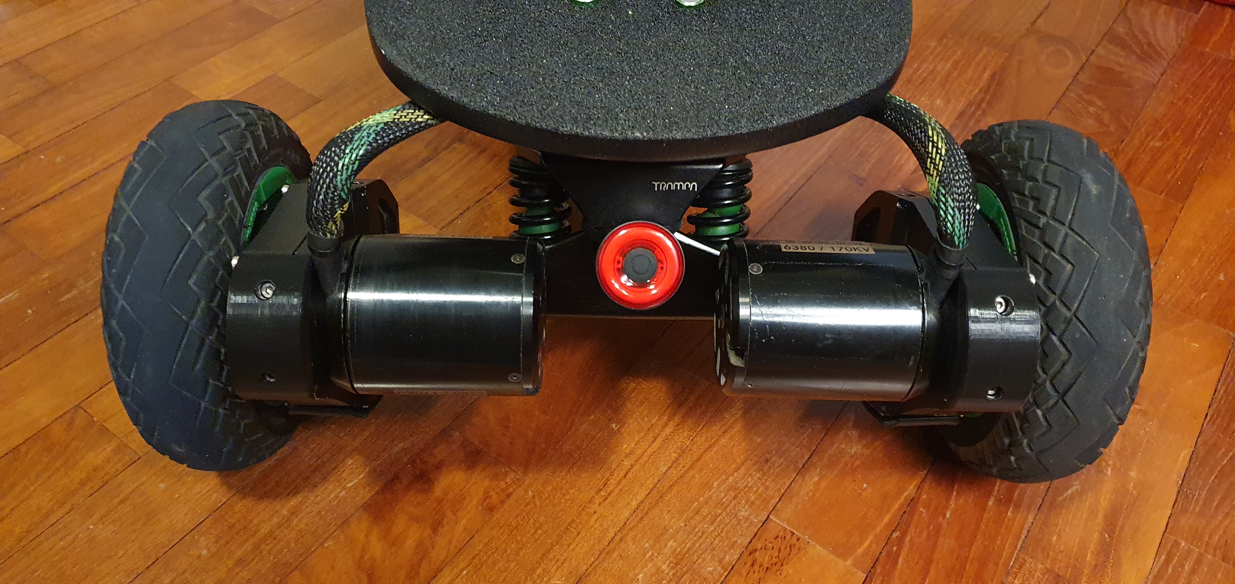

Trying to retro fit the herringbone gear drives made by @avX. This one is based off the MK1. The mount is meant for Kahua trucks, and the diameter is 25mm. The Trampa truck is a bit larger than that, so I’ll have to cut the truck down a bit. Science time.
The truck is so long it’s barely able to fit on my 7x12 metal lathe.
And the gear…
And comes the adapter to fit the Superstars. Jeff helped model the adapter to fit and fits nicely. Printed in PLA+ at 100% infill.
Soft fitting everything on to check for any clearance issues, all good.
And it’s time to set it up
Mounts go on and torque in place
Gears.
Figuring out mount angle
And on goes the mayonnaise
And here it is
Free roll is better, and motor clearance is better. Love it. I took some shots when I was testing it at the carpark nearby.
