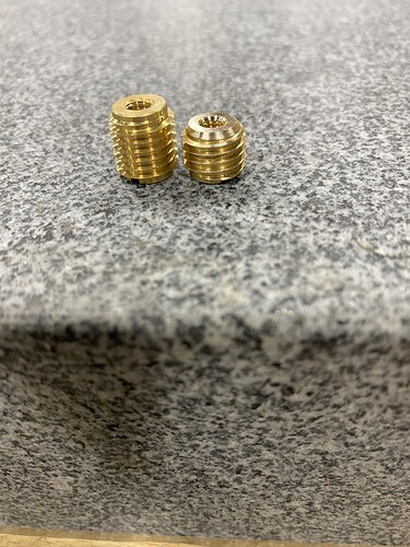

I personally think that the EZ LOC knife edge brass inserts are the best.(m5 internal thread)
Problem is that the length is 12.7mm overall. That makes it very hard to drill a normal deck to depth without breaking though the other side, as you need to account for the drill tip.

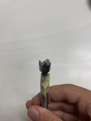

I did run into this issue with the EZ LOK inserts. I solved it with a Forstner bit that I ground the point off of. I used a normal drill bit to start the hole and make sure it stayed centered, then used the Forstner bit to finish it and I end up with a full width hole all the way down.

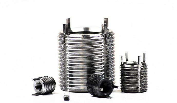

I was introduced to a new type of insert today called a Keensert.
Locking prongs get hammered in after it screws in to prevent backing out.

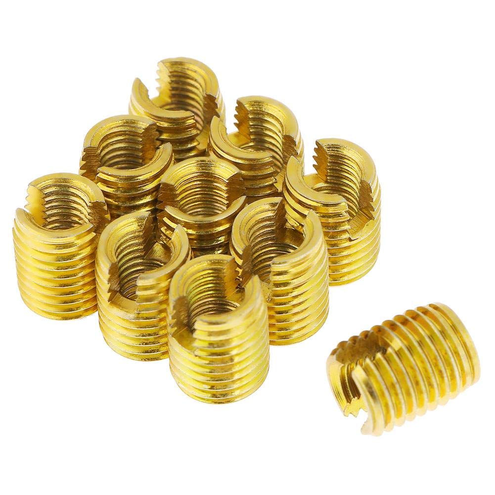

I use these for repairing badly damaged threads in soft metals like aluminum, copper and cast iron, when a helicoil won’t work. They also work fine in some plastics (delrin, UHMW). To use these, you need to pre tap the hole, but they are not for use in wood though :frowning_face: Otherwise, they are great!
Drats, they looked close enough but the threads are a bit fine. I appreciate the empirical data point!

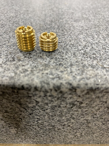

I haven’t used those specifically, but have used similar-sized Ez-Lok ones I’m linking below. Similar price. Same M8 outer thread & M5 inner thread, but I see slight differences in…
  • Length: Ez-Lok are 12.7mm [1/2"] long. vs your link are 10mm long. Could be better for a thin deck
  • Method for driving them in: Ez-Lok has a shallow slot you drive with their special tool. Your link appears like the style that should be driven in slotted-end first. Believe me I’ve tried to install this style the opposite way and it doesn’t turn out well… the slotted end easily splits apart.
BTW, this M8/M5 size is heavy. I put ~20 in a board and felt like I added half a pound of metal. :rofl: Worth considering if M4 size is better for you. M4 Ez-Loks (you can find them at this same amazon link) were more appropriate for my last esk8 application.
