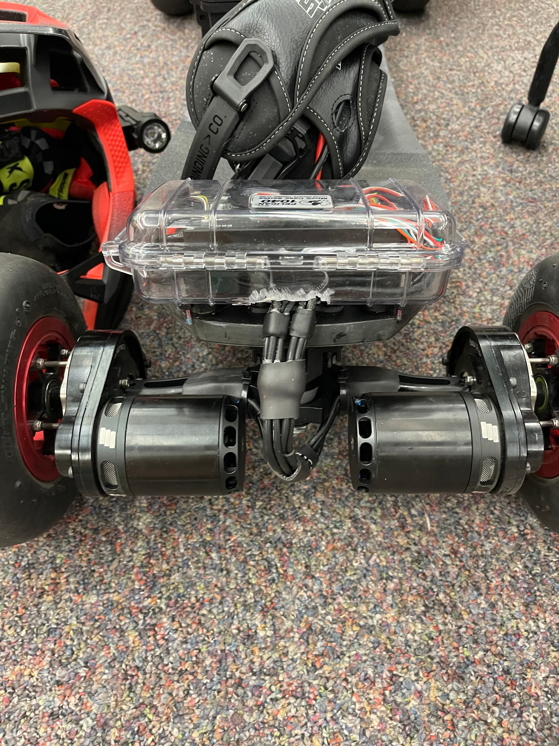

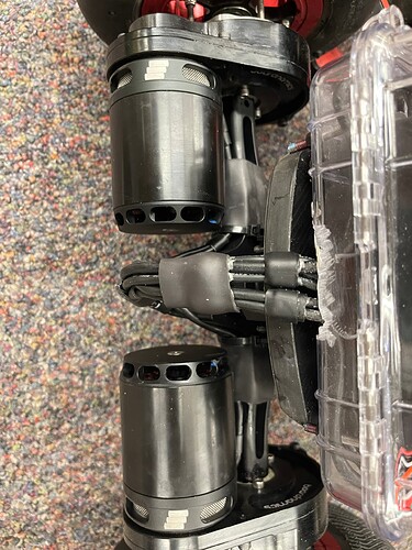

The board is running nice at higher speed but I’m experiencing cut outs at lower speeds. I’m wondering if anyone has a magical answer for me. The hardware I’m running is a dual Ubox 100v 100a, 20s3p with p42a, and Skyart 6485 125kv modors.
Here are all my settings per side
Battery: 45 amp per
Motor: 95 amp per
Braking: -85 amp per
Abs max: 135 amp per
Ramp up time: .15 sec pos and neg
I haven’t touched any of the other settings and I’m running current for the VESC remote. Thank you all in advance.
Edit: ended up being to much motor current for the ol’ spiny. I have it set to 90 and -80 and seems to be fine now.

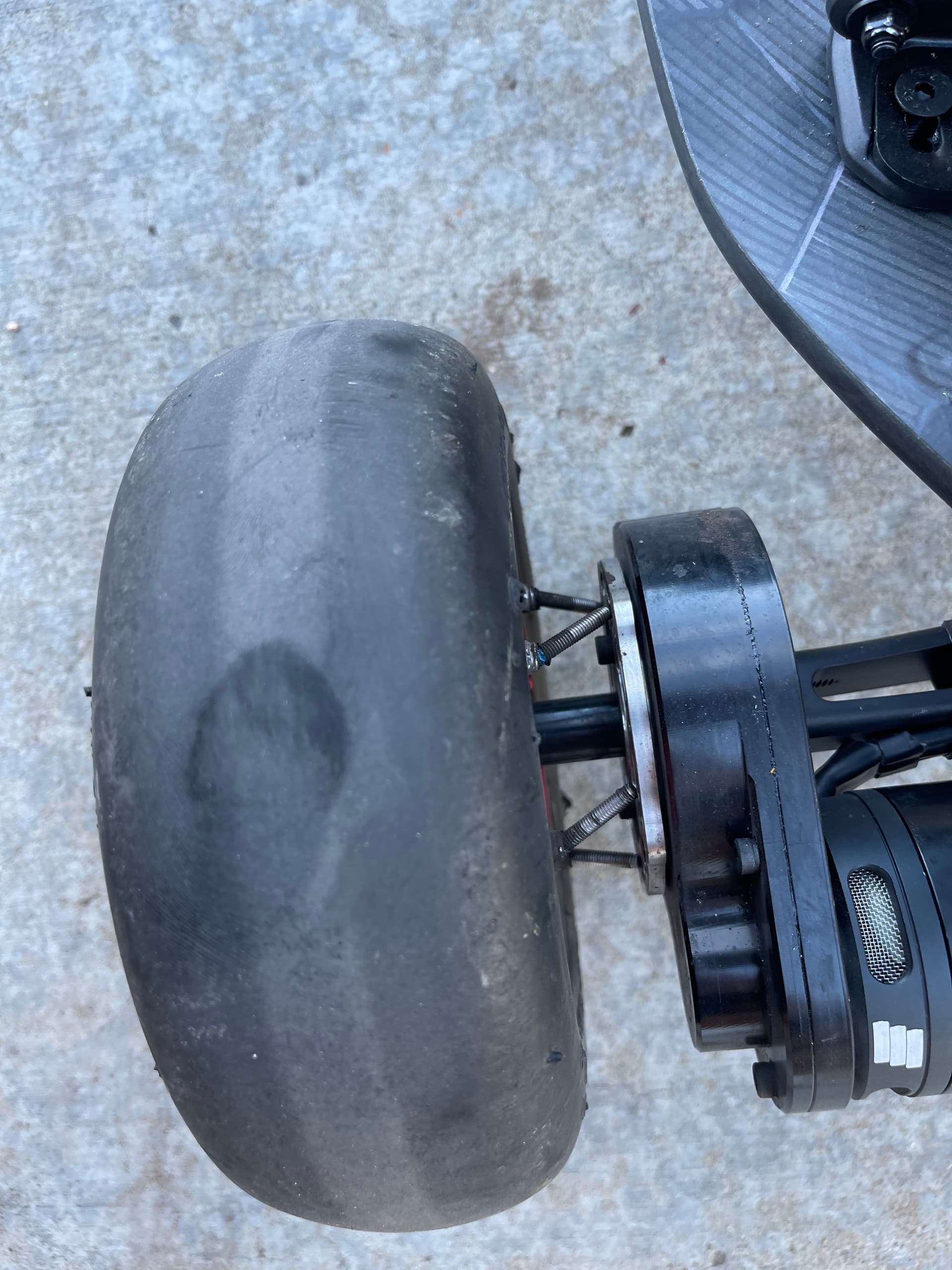

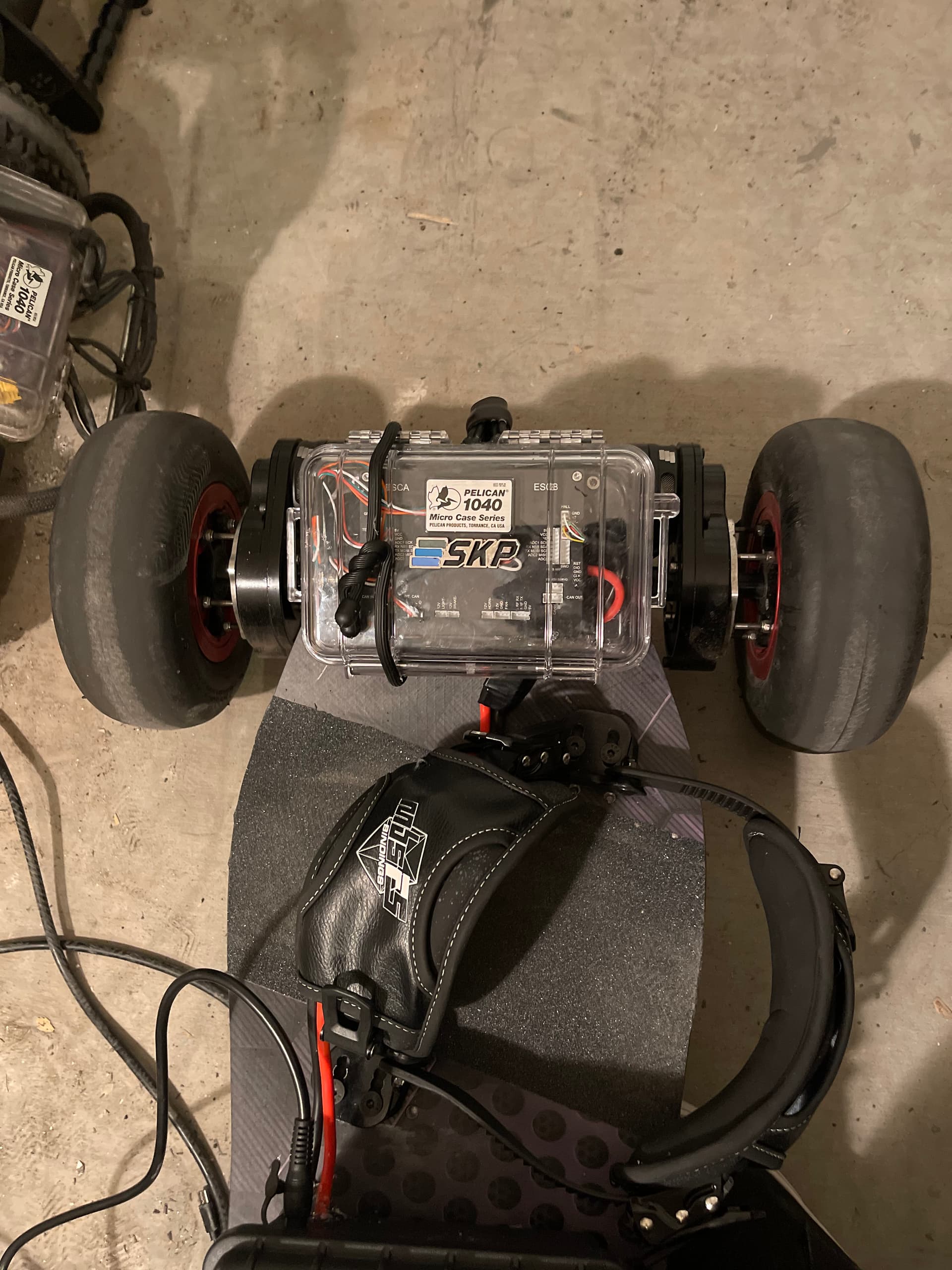

The screws should be way way shorter, ideally the back of the wheel should be nearly against the disk.
Those tires are wild.
I know… I just wanted to utilize the wider trucks. I feel way more stable at speed. I might end up trying it with some stronger bolts and if that doesn’t work… we’ll I’m SOL I guess.
They’re comfy🔥
I wouldn’t bother, it will definitely fail regardless of the material.
What you need is a custom thiicccc adapter plate
Mmmmmmmm you know where I would acquire such a thing?
Um. From someone who can make it?
Mate with a shop, sendcutsend, or trade for pizza and moneys with @Boardnamics
@Boardnamics would you be interested in making such a part?
It is not the issue here. Just put a spacer before putting on the drive to push everything further out if you wish to have the widest wheelbase possible.
How is that possible with the push fit adapter that the drive attaches to?
Spacers before the push adapter and then slide the push adapter on?
