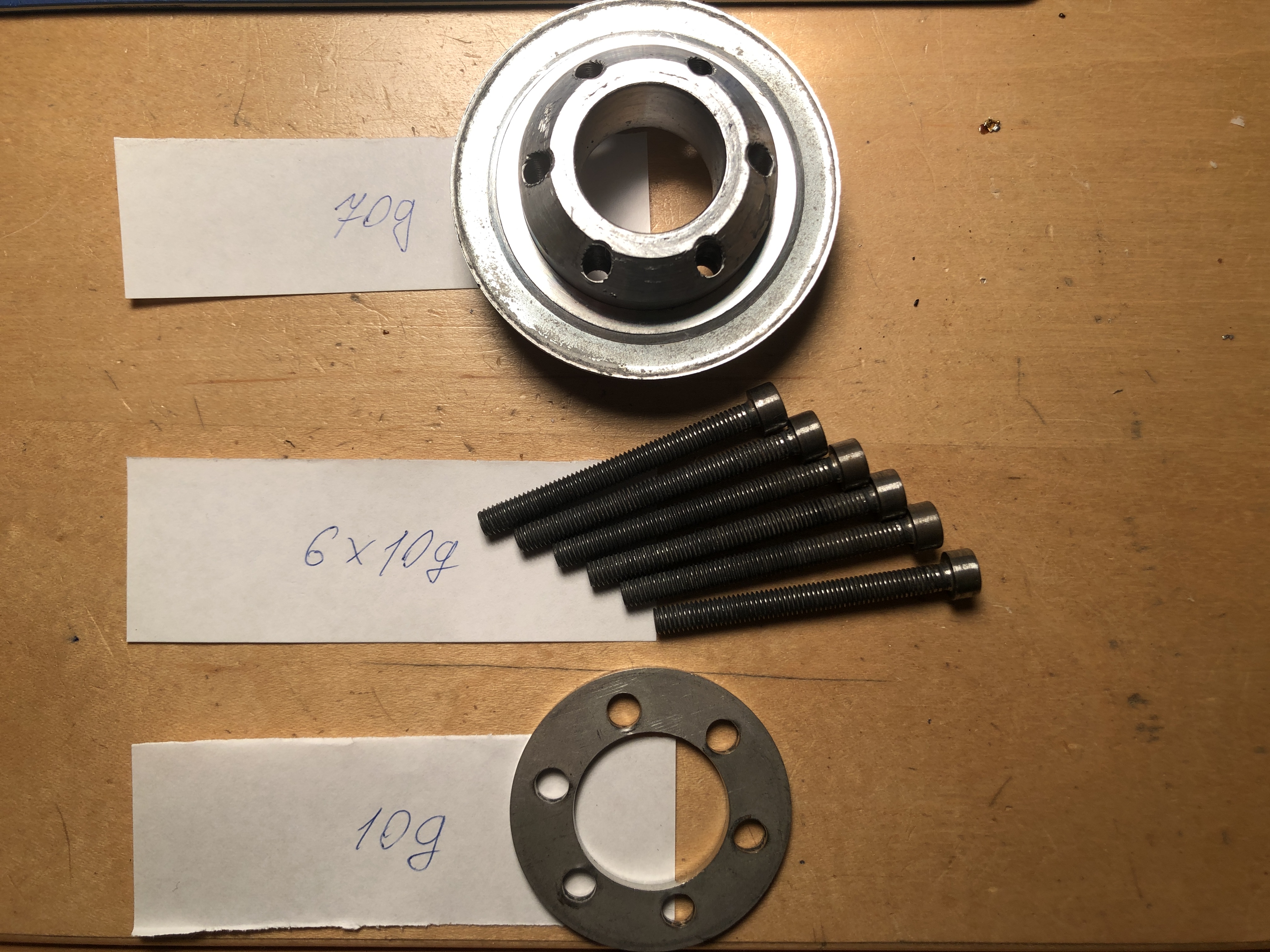

  2. Measured the weight of the wheel pulley and it’s hardware:
    Total is 140g, with 4 excessive bolts.
    Maybe, i will make new disk with 2 holes just for esthetics.
    Now it will weight only 100g. Reduced weight by almost 30%.
In total, that is not much, but these little reductions will cost a lot later.

I wouldn’t do that, you want at least 3 points of contact to prevent rocking of the pulley which creates a lot of extra wear on the core, I know the head of the bolts technically count as a 2D contact surface but its so much less strength than having 3 bolts in a triangle, you’re gonna survive the extra 10g. I would definitely print a pulley though, you’ll save far more weight that way

So, I think that a compromise would be an aluminum pulley with 3 bolts & 3 holes enlarged. Result is the same, longevity is higher.
Edit: calculated curvature of the bolts on the max motor torque, not taking into account friction forces with 2, 3 & 6 of them.
2.56 cm, 3.84 cm and 7.69 cm correspondingly.
Seems too much, but in reality friction of the disk and pulley with the wheel is way higher than curving forces, especially if pulley is mounted as tight as possible. So, bolt’s strain is enough, even at 2 bolts.
What makes worries is the ring, that holds everything in place. 2-bolt mounting will bend it really hard over the axis between them, so friction that revolute the wheel will take place only near their heads. That is why 3 bolts is the way to go. But more - is exactly optional, not essential
