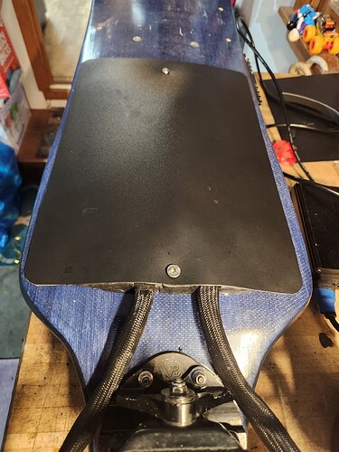

I got my sink-plate/battery-bucket cover done.

In every top-mount build you reach a point where you have to decide what you’re going to do with the wires that run from the ESC or battery to the motors. How you go about it depends on how you’re going to use the deck. If you’re going to be sliding on the bottom of the deck, you’re best to run the wires on top, but if you’re making a trail-runner like this one, you can run them along the bottom. That’s what I decided to do. Next, I just needed to find a way of doing it in a durable and tidy manner.
I found this cord-cover stuff and it seemed like a good material for making a “conduit” of sorts. It’s super rugged and inexpensive. I affixed it with heavy-duty mounting tape and then gave it the ol’ glue and screw. Hopefully it will stay if place. It covers the cords nicely and keeps things neat and out of the way,
