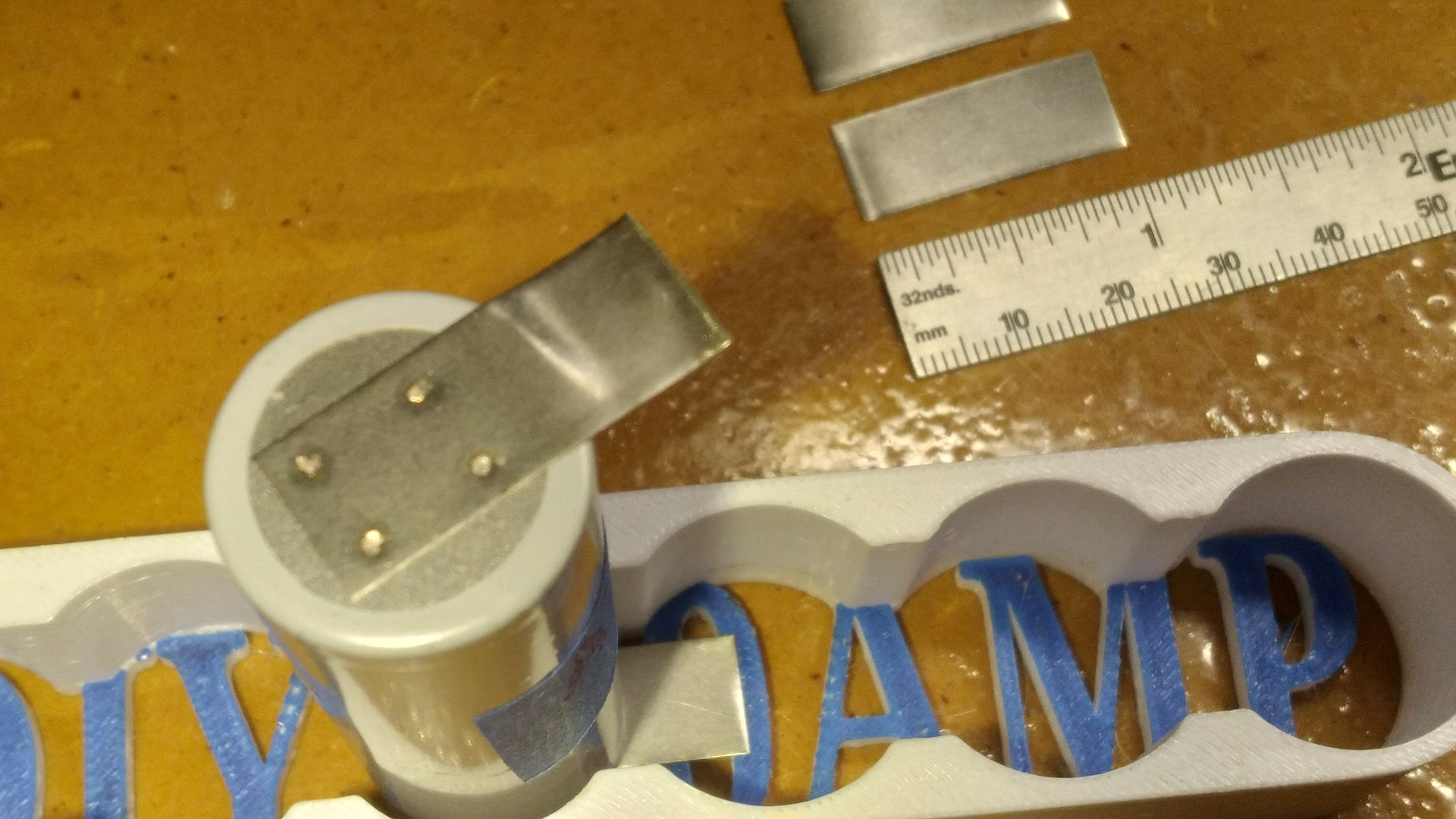

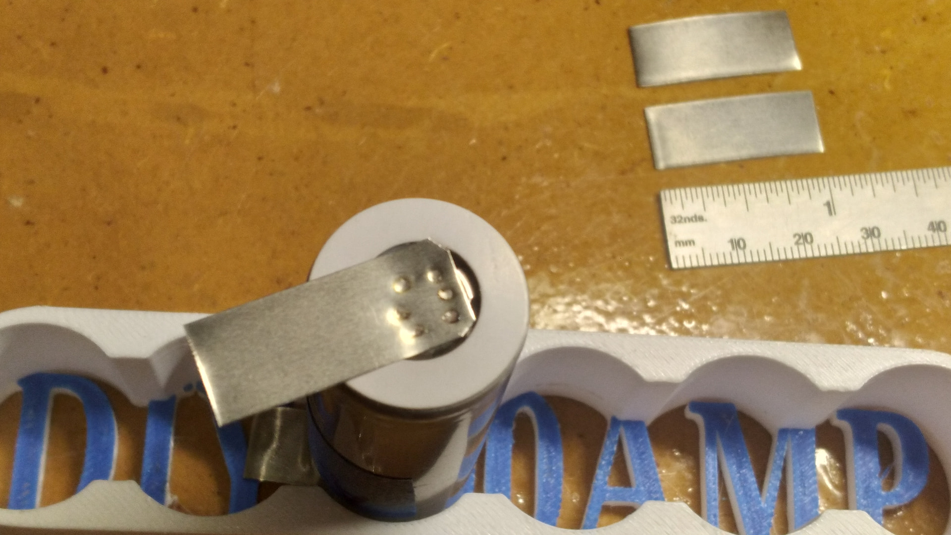

Nelvick @DIY500AMP.COM has donated 21700 cell samples and I am here, tools in hand, some time, and am ready to weld some strips to some cells Would like to visit the post office By Saturday.
I am contemplating the best methods to minimize the variables, and allow for comparable consistency in the future, as I am not going to be able to cover every base.

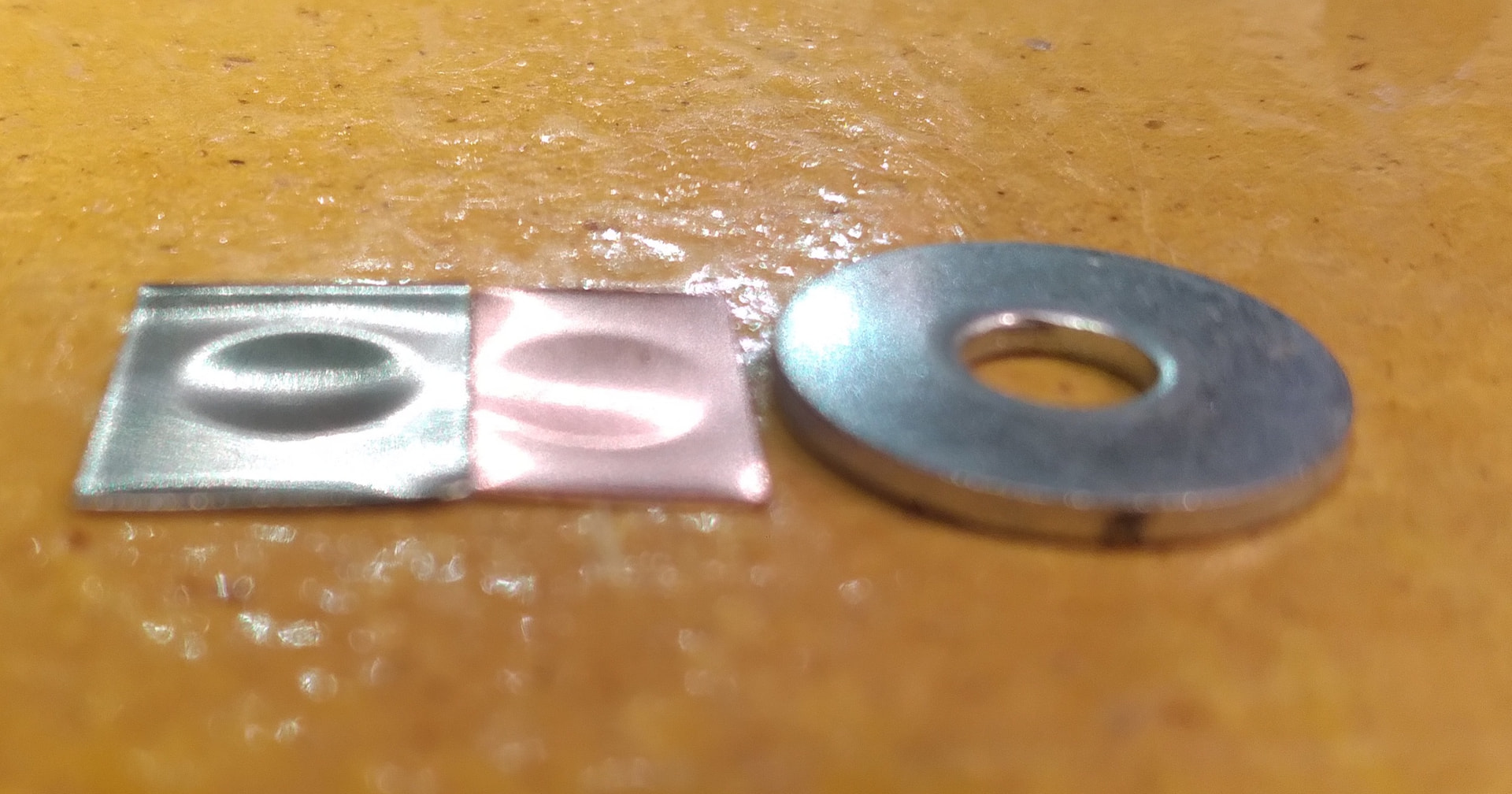

I have an AwithZ P20B 14.6 KW spot welder, that has proven capable of welding 0.3mm copper under 0.2mm nickel plated steel, using Nelvick’s welding flux at near its full available power. I have solidly welded as much as 0.2mm+0.15mm copper under 0.1mm stainless using flux, but my machine was incapable of 0.2+0.2 under 0.1mm stainless using flux at max power. it was close, but not quite enough. 0.07mm stainless atop 2 layers of 0.2mm copper made no discernable difference.
In general I Use 0.2mm copper under 0.1mm stainless steel using flux below the copper, using gear 385 to achieve very solid welds.
Without the flux I need to use about gear 550
Without Flux or Stainless on top, to weld 0.2mm copper I need about gear 840.
Weld consistency fluctuates with no sandwich or Flux.
The amount of pressure, tip shape and cleanliness, and temperature of welder and Leads playing a much larger role when there is no sandwich and no flux, at least on my P20B welder.
I cannot ‘raw dog copper’ thicker than 0.2mm(0.25mm maybe?) and personally do not mind having to use stainless or the Flux.

I have 0.1, 0.15, 0.2mm thick, 10mm wide copper strips
I have 0.15mm thick 10mm wide pure nickel
I have 0.07mm thick 304 Stainless
I have 0.10mm thick 304 stainless
I have 0.5mm thick 16mm wide Stainless, some 400 magnetic series.
I have 0.2mm Nickel plated copper, which behaved exactly like Non plated copper in my experiments
I have plenty of Nelvick’s welding Flux and extra welding tips, and about 15 21700 cells. Some tabless and some not. Mostly virgin cells but a few that have little nubs of welded strips I will need to remove.
I know some have no interest in using either flux or Sandwich, and have machines powerful enough to be able too without, whereas my P20B can only raw dog 0.2mm copper at high power levels.
I think any thinner than 0.2mm copper by self, is just too weak on the tear off tests, that it greatly benefits strength wise from 0.1mm stainless on top.
I have welded sandwich using pure nickel, and nickel plated steel, but both of these require the use of lot more power than using stainless steel.
If going for copper sandwich I personally see no point in using Pure nickel or Nickel plated steel on top. They require significantly more power. I use neither as conductors, only welding aids.
I would like to find out the difference between 2 pairs of welds, and 3 pairs, and 4 as well.
I would like to find out the difference between welds with flux, and without flux.
Copper sandwich welds, and non sandwich raw dog copper only welds, both with and without flux.(0.2mm limited)
I’d also not like to overload Mooch with a giant box of samples to test, if consistency is poor and results conflict.
I am really pretty dialed in with 0.2mm copper on my machine and I know that’s where I will be able to deliver the most consistently prepared samples.
