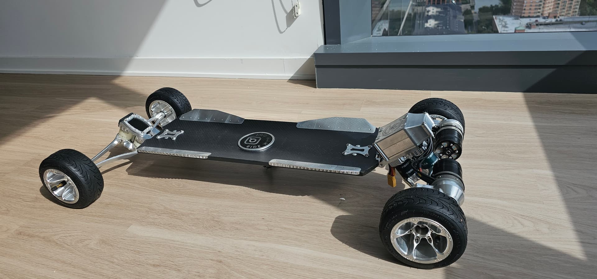

The first build that I’m going to share is the E-Toxx setup. to make it happen, I asked for Idea prototype 35 degrees brackets. it wasn’t a big deal for him :slight_smile:

First test:
I bought the E-Toxx set from Jens almost 2 years ago. I havn’t use it too much, it looks too good to scratch. :joy:
Electrical setup chosen for it is Trampa 160kv 6374 motors and Vesc 6 esc. my remote is the VX4 that I really really like.
After I put it on the new deck:
I also added some printed parts and carbon plates between the brackets and Etoxx parts to make it look better, I will add it on the next progress with the encloser making.

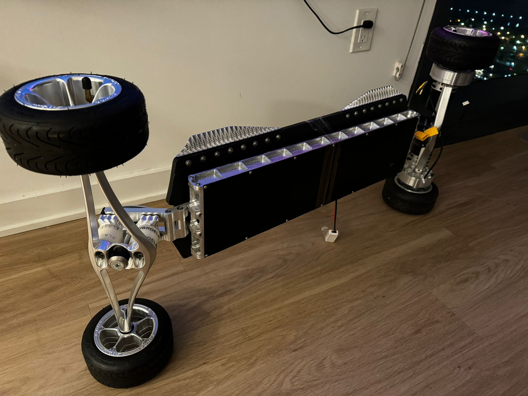

The battery also changed to 16S3P instead the 12S4P on @DuckBatterySystems PCB.
The old battery cover was temporary solution (and really ugly) Aluminum sheet metal. I didn’t share it with you until I can present the new modular battery.
The Idea was to make modular boards with easy assembly so the battery is also modular. made also configuration for the duck battery but I think I will stay with 16S for all boards in the end.
it’s going to have internal isolation from FR4 and padding if you are worried :slight_smile:
for motors I’m still considering two options for now:
  1. 2X AXI 5345/16 (equal to 6384 by size) on 1:5 reduction .
  2. second stage gear from E-toxx with 800kv 5694 800kv SSS motor on 1:15.25 reduction
parts for today, Monday the rest
That enclosure design looks great!!!
Cutting update, everything seems to fit great, continue to internal and external plate installation
