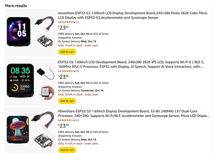

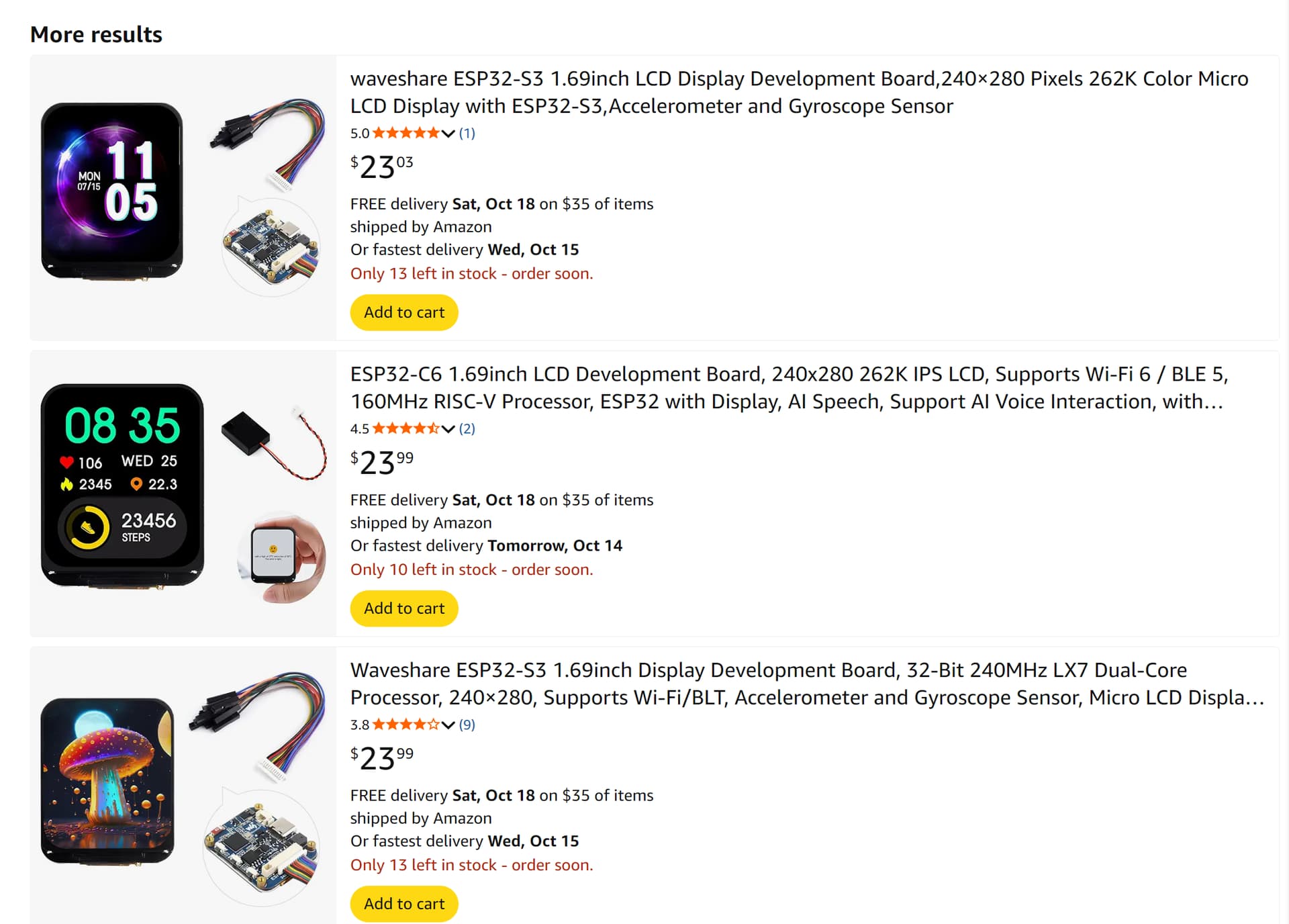

Sooooooo, in my infinite wisdom, I decided not to follow the BOM to try and streamline some of the remote build! This was a mistake. I wanted to minimize the number of parts I had to order to get this working. I went to amazon and searched for the project’s ST7789 LCD and found a cool dev board with it integrated.

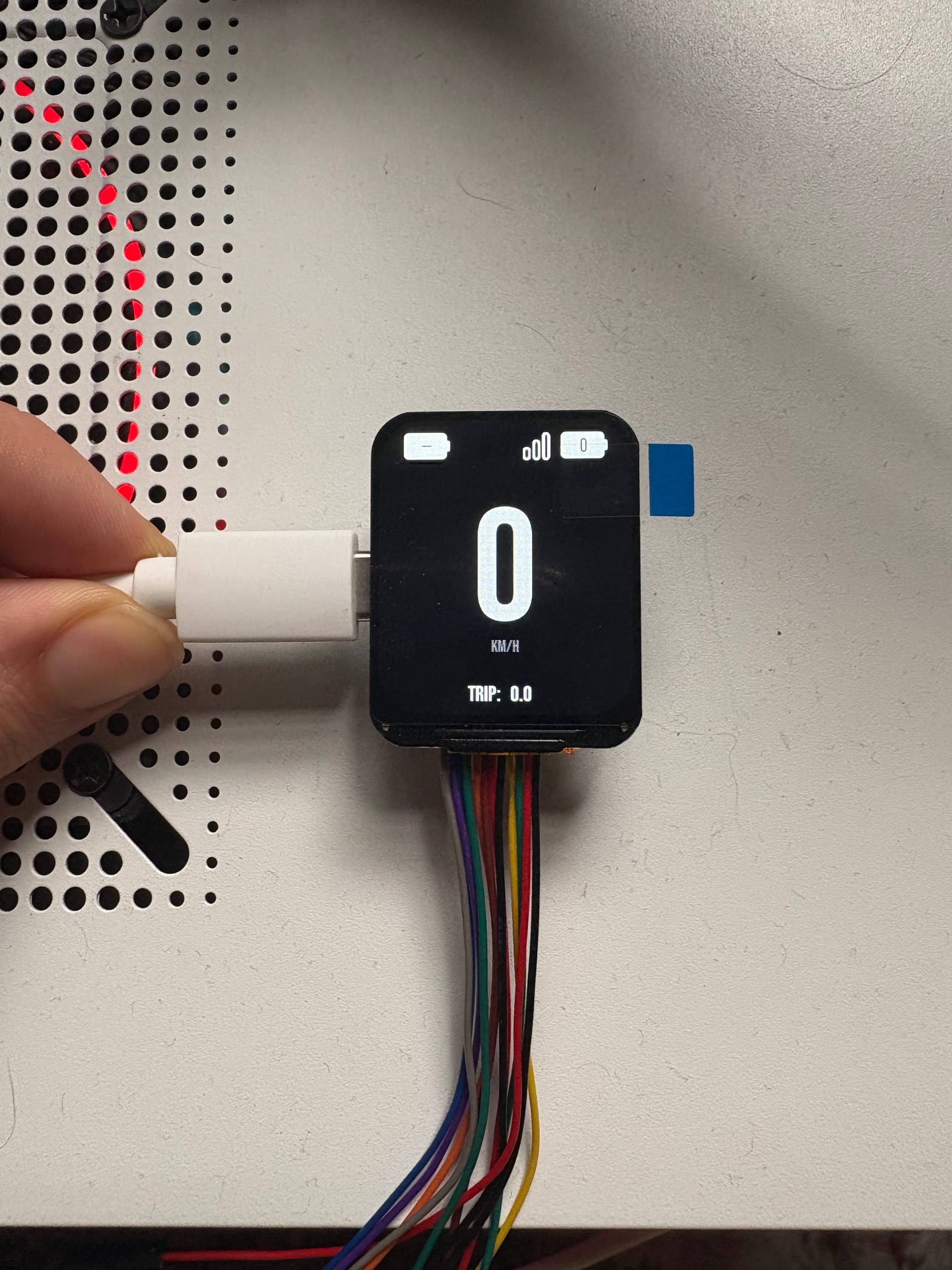

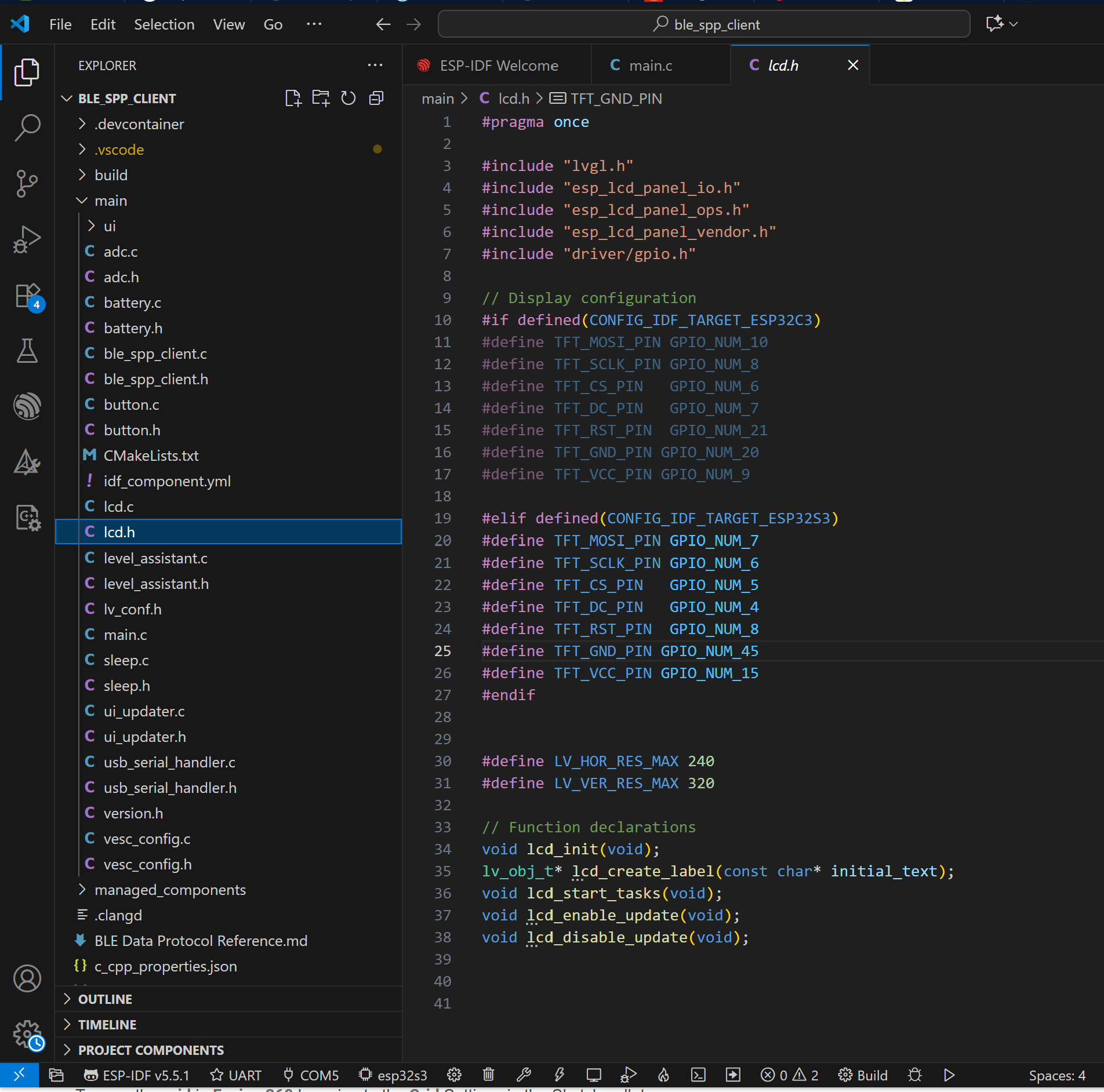

I knew enough about the source code that the ESP32 S3 WAS mentioned. I didn’t expect some of the consequences of going with it though. So there’s snag 1. I had to alter the code base not super significantly, but George didn’t have a pinout schematic anywhere, so I was flying blind initially. This touches on point 2. It’s my first time in VS, and it was a bit of a pain to setup. I got there though, and have successfully ran the GB Lite firmware on my dev kit!
I’ll skip over most of the changes I had to make, but the big ones included:
  • LCD Pin assignments
  • Remote battery sense pin
  • Hall sensor pin
  • Power button
  • The entire Sleep/Power off function :melting_face:
I will eventually publish my code as a fork for others if they WANT to suffer through this build, but only after I get George’s okay upon finishing. I learned a TON getting it this far, and it’s inspired me to make several more changes at a later date. George’s GB Pro has some REALLY sick features that I wanna implement in my fork like: variable display brightness, accelerometer support, and maybe substitute haptic feedback for auditory feedback.
This dev kit also has a built in Accelerometer/gyro, configured for adjustable backlight, and a piezo beeper. That’s a big part of why I picked it. Not to mention an integrated battery charger IC, integrated button, and USB C.

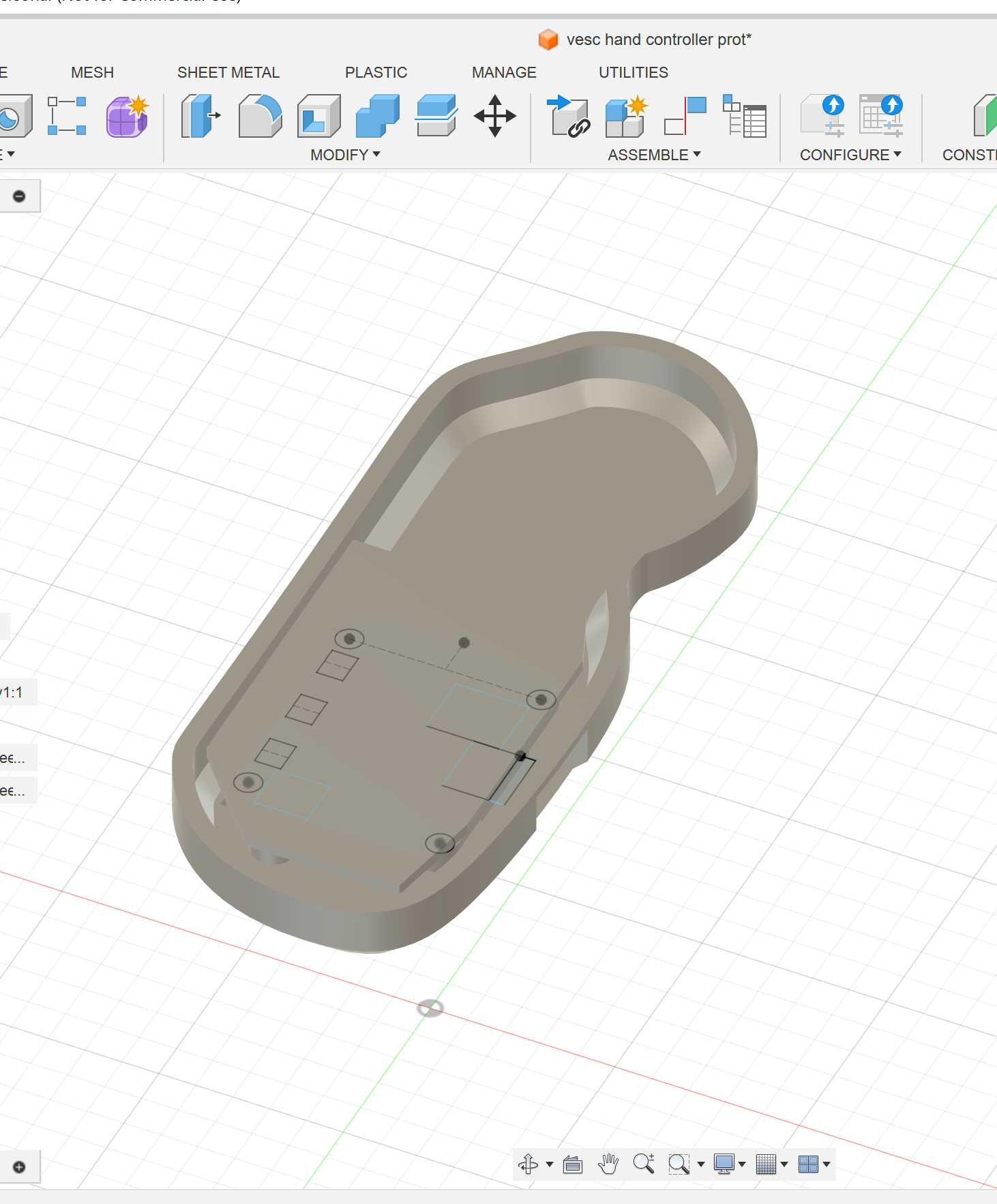

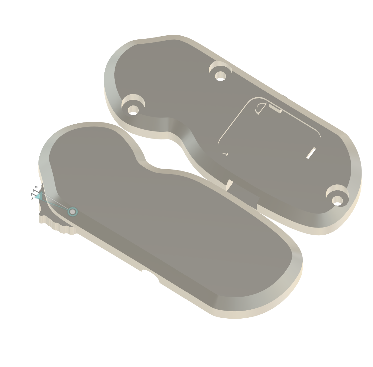

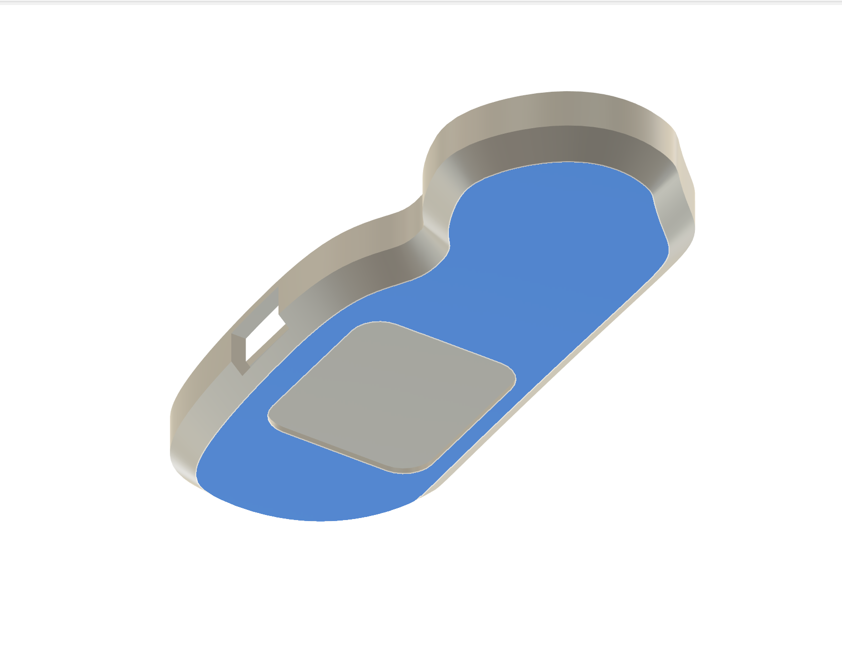

Nowwwww, the biggest feature creep: Redesigning the remote housing. Obviously, I can’t just use the provided STLs. I have to move the USB C Cutout, Adjust the display mounting location, and change the configurable button design.

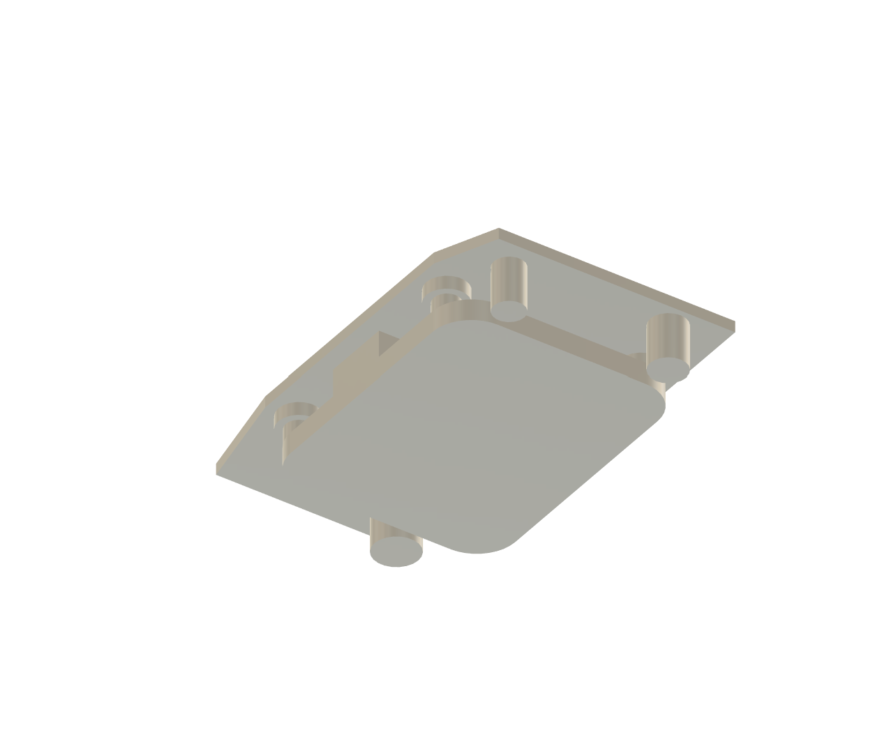

What I didn’t also bargain for, was needing to redo the throttle control. I don’t wanna buy bearings and increase the design cost any more than I have, so that’s gonna take me a bit longer. Same goes for the mounting hardware. I don’t wanna buy heat inserts.
My little internal board caddy/holder is pretty rough too. I’ve only managed to get the top half of the shell completed in the few days I’ve had to work on it, but I’m gonna see about banging out the lower half of the shell over the next few days.

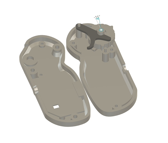

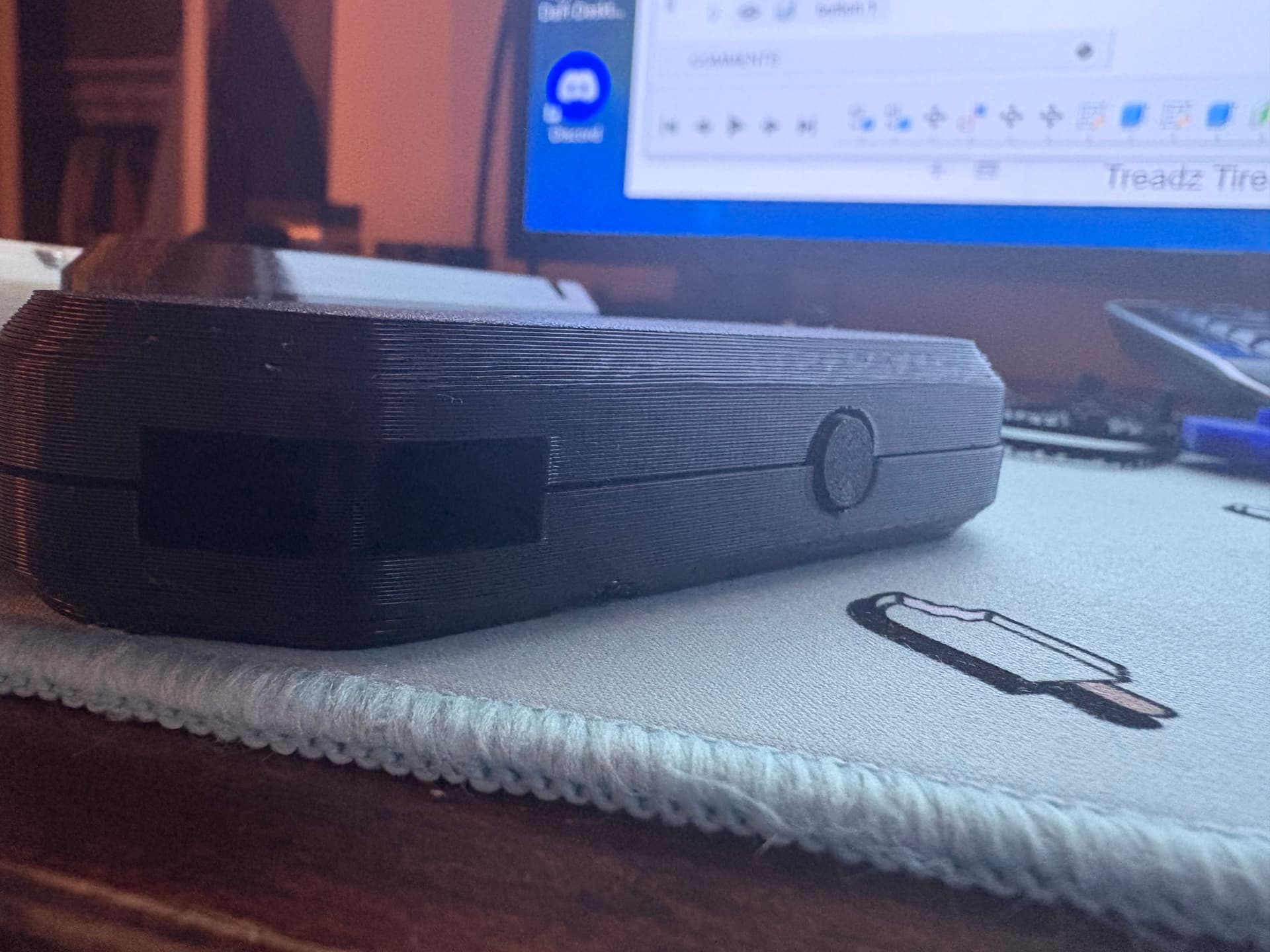

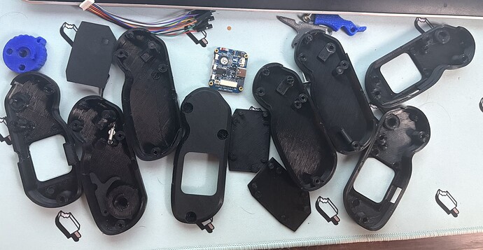

Two more weeks down, lets check back in on my progress! This GB Lite project has completely stalled out my board progress, so I’m really hoping I like the final outcome. Butttttt, I think it’s almost done! The amount of prints I’ve done adjusting for small inaccuracies in my initial measurements has been quite a pain.
BUT IM GETTING SO CLOSE. My design is significantly less complex for assembly pieces. No bearings, no heat inserts. Very much taking my experience from Firefly remote assemblies. I will say, one of the biggest pains compared to a firefly, has been the push button. I’ve never done one like this, and I probably should’ve came up with something more elegant. It works fine on my test prints so far, so I’m not gonna overly iterate given how far this timeline has already slipped.
Obligatory Instagram mention: https://www.instagram.com/reel/DQV4gNjDqnO/
But long story short, getting very close to the finish line! Once I’ve got this design finalized, I can move back to the firmware. I wanna add a little startup animation with my own branding touch, maybe a throttle bar with a splash of color, and a shutdown tone/beep. So I’ve definitely got my work cutout for me.
I’ll be releasing the print files and a barebones firmware port as soon as it’s all ready. I’ve also got a bunch of magnets, hall sensors, and 7 pin JST connectors that I’m not gonna need. If anyone’s looking to build one of these, I’d be happy to part with sets for cheap.
Notable design changes:
  • Simpler electronics BOM: ESP32 S3 Devboard, JST plugs, and hall sensor are only parts required
  • Less mechanical hardware required: no bearings or heat inserts, just magnets
  • Custom fork of the GB Lite firmware WIP,
  • Slimmer design,
  • Aligned throttle wheel nub to be more centered :face_with_steam_from_nose: (This one really bothered me)

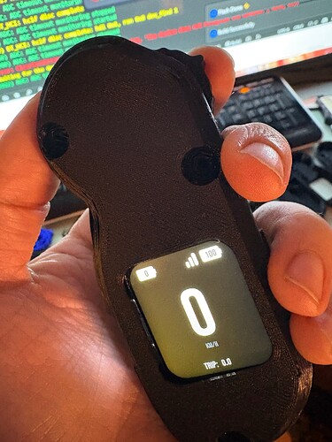

Anyway, despite the distractions, I did go ahead with some assembly. Gonna probably need 1 more shell revision since I’m having issues with the screen sinking in.

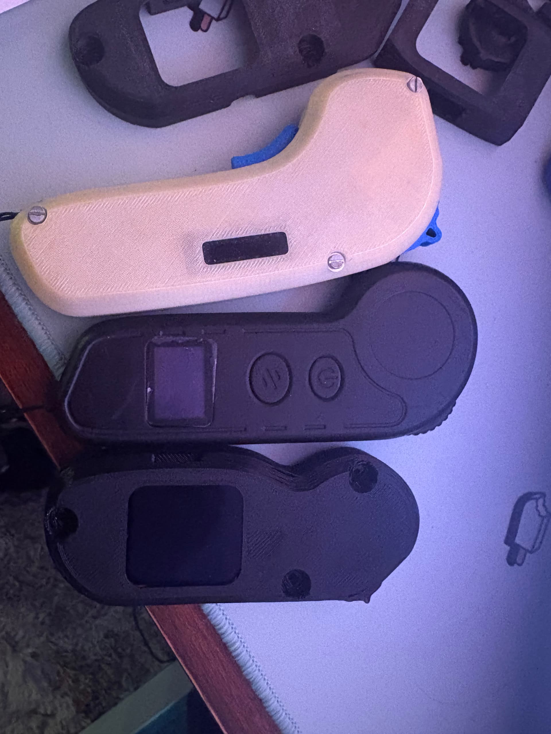

Little spoiler in that image, I also assembled my receiver! But I also took a quick size comparison next to my Firefly and Hobbywing remotes.
Spring tension feels great, but I will say the scroll feel leaves a bit to be desired. The bearings in the original design are probably a big help there. I’ll need to reprint my wheel anyway, since my magnets aren’t perfectly aligned yet. Initial test was successful though!
