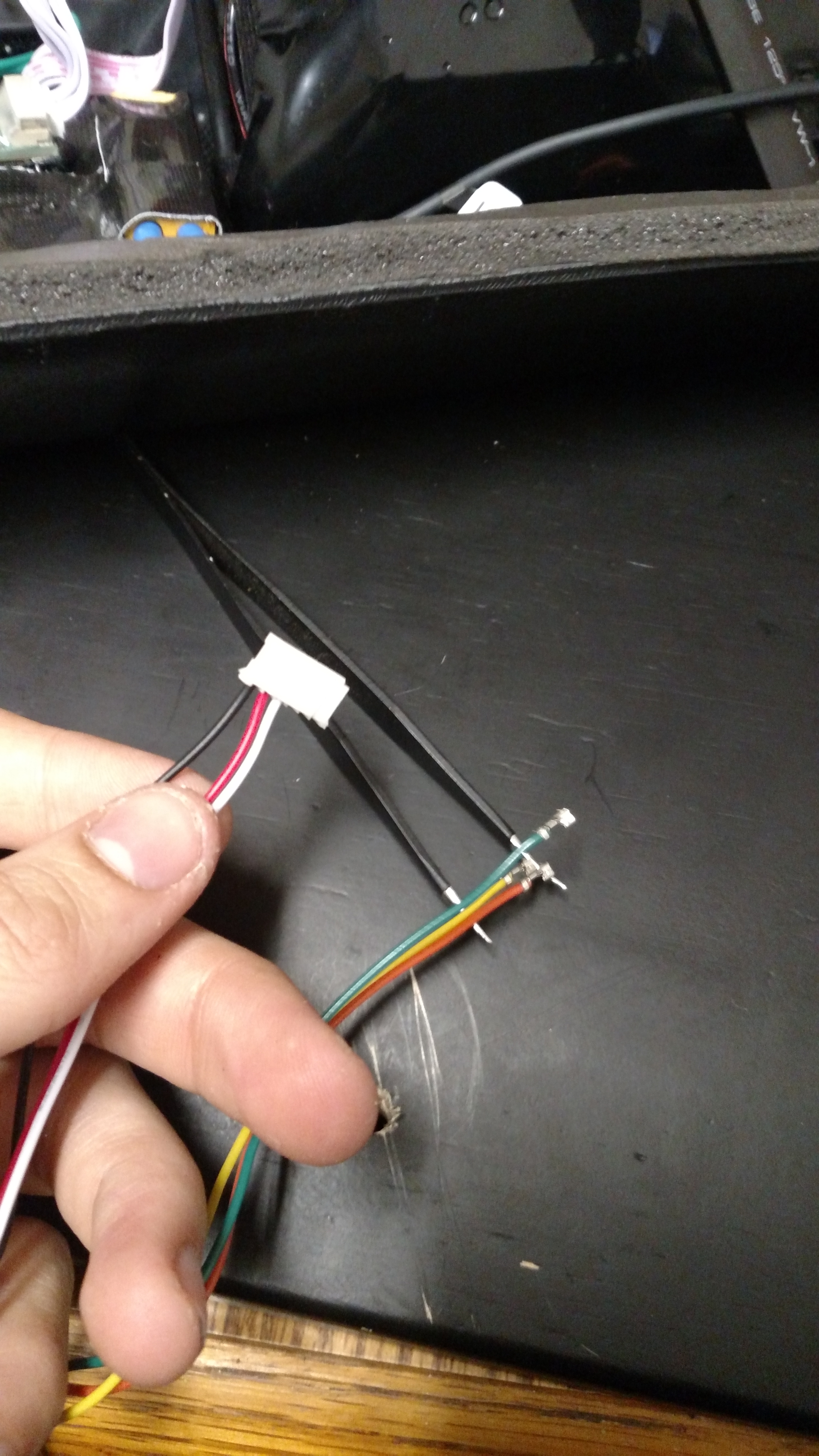

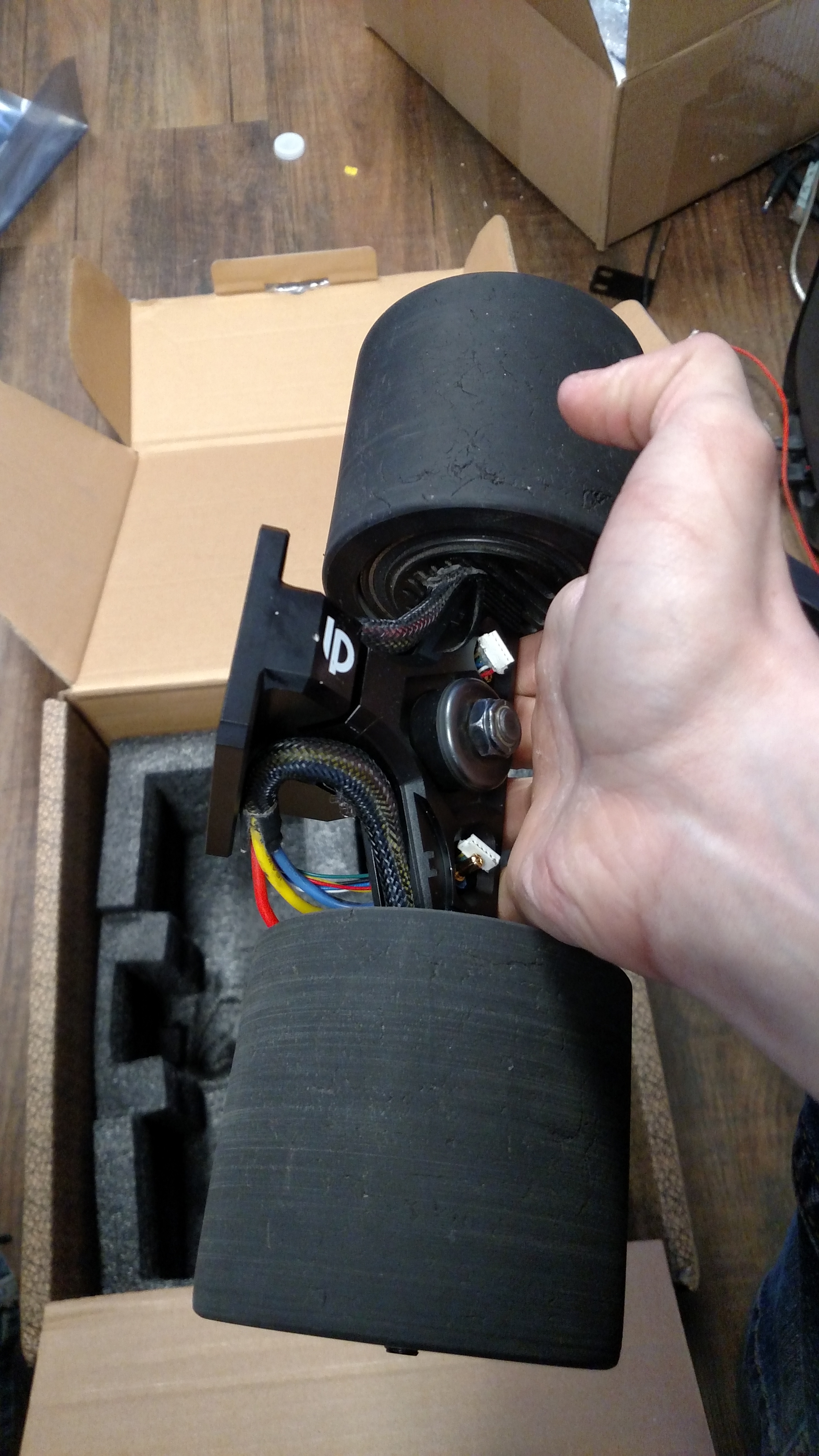

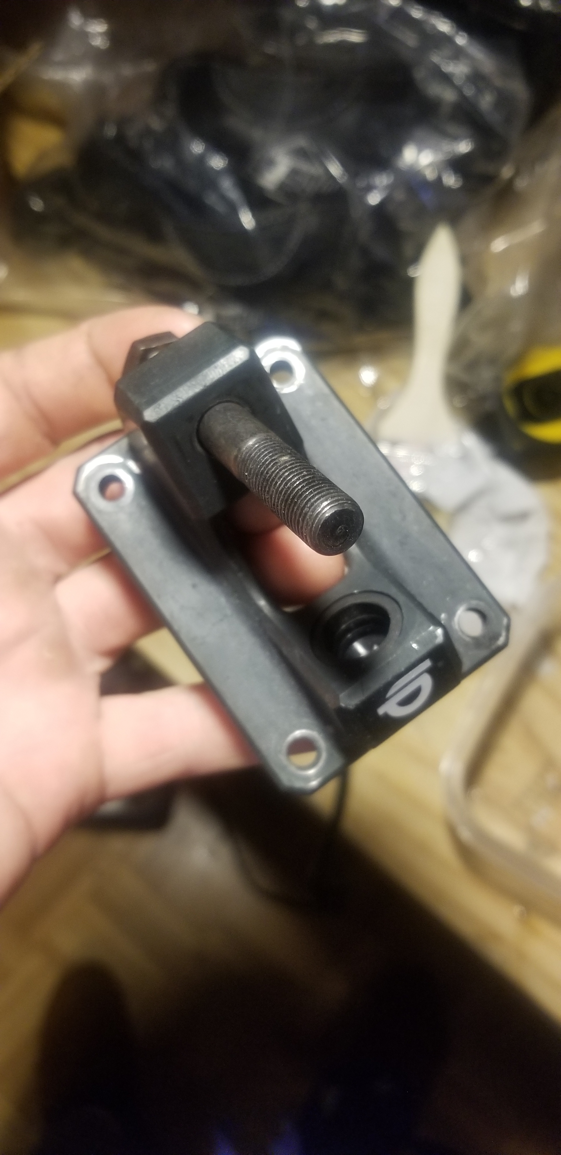

Well after I had all the parts I soon encountered quite a few issues with this setup. First, the Tayto deck has the new standard bolt pattern not the old school that enertion has on the raptor trucks. This was the first pain in the ass. I got my 3/16" bit screamed yolo and drilled it. Came out solid. Wish I would of know about this in the first place though. Second The Tiller Knuckles enclosure I used only fit in the last bolt pattern position. Normally not an issue but with the new standard pattern, if i were to of mounted the trucks in the last position it would leave me with out much leverage on the tail. So I filed down each part of the enclosure where the base plate touched and used the first ones. This was also a pain in the ass. The third pain in the ass was that the Raptor hubs use that tiny JST connector and the focbox’s use the full size ones. GG Jason. Luckily I bought a set of converters for my maytech 6374’s. I had to change the pin layout as it was completely different of the hubs and it was crossing wires.

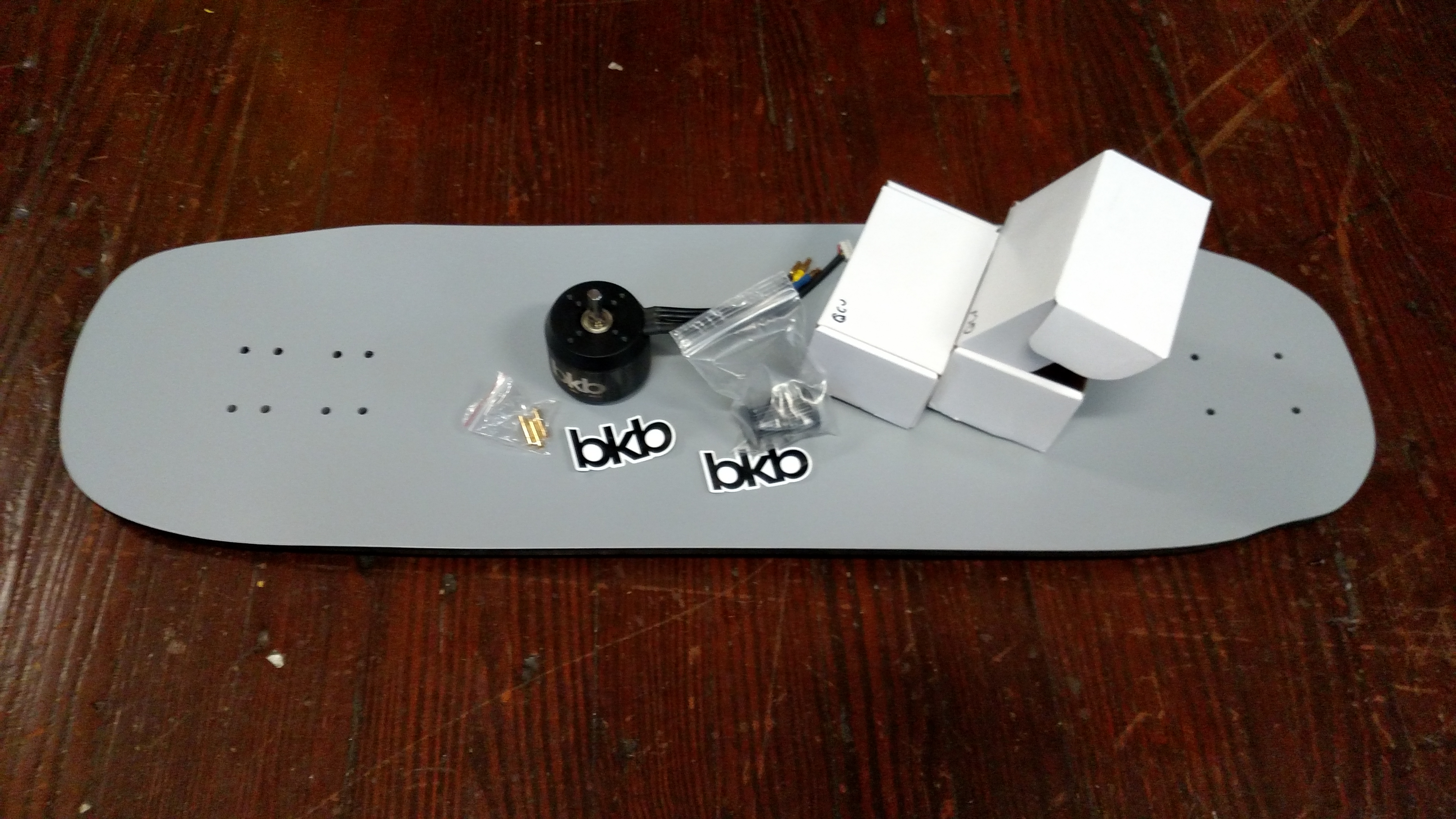

All in all, after I got the parts it didn’t take too long to assemble it. I got the deck from Jared back in December. It was pretty hard just staring at that deck for months without anything to put on it.

After that I got the raptor hubs.

Since the Tayto deck for some reason as I mentioned earlier has the new standard bolt patterns, I tightened down a caliber 2 baseplate and used that as hole references. It came out fine. I shaved down the enclosure to so it could fit perfectly. With no motor mounts to worry about getting in the way this came out sweet. The only issue was that I needed to use 1/2" risers to get it to not rub while leaning as these motors are thicc bois. It’s not too high off the ground and still feels safe so whatever.

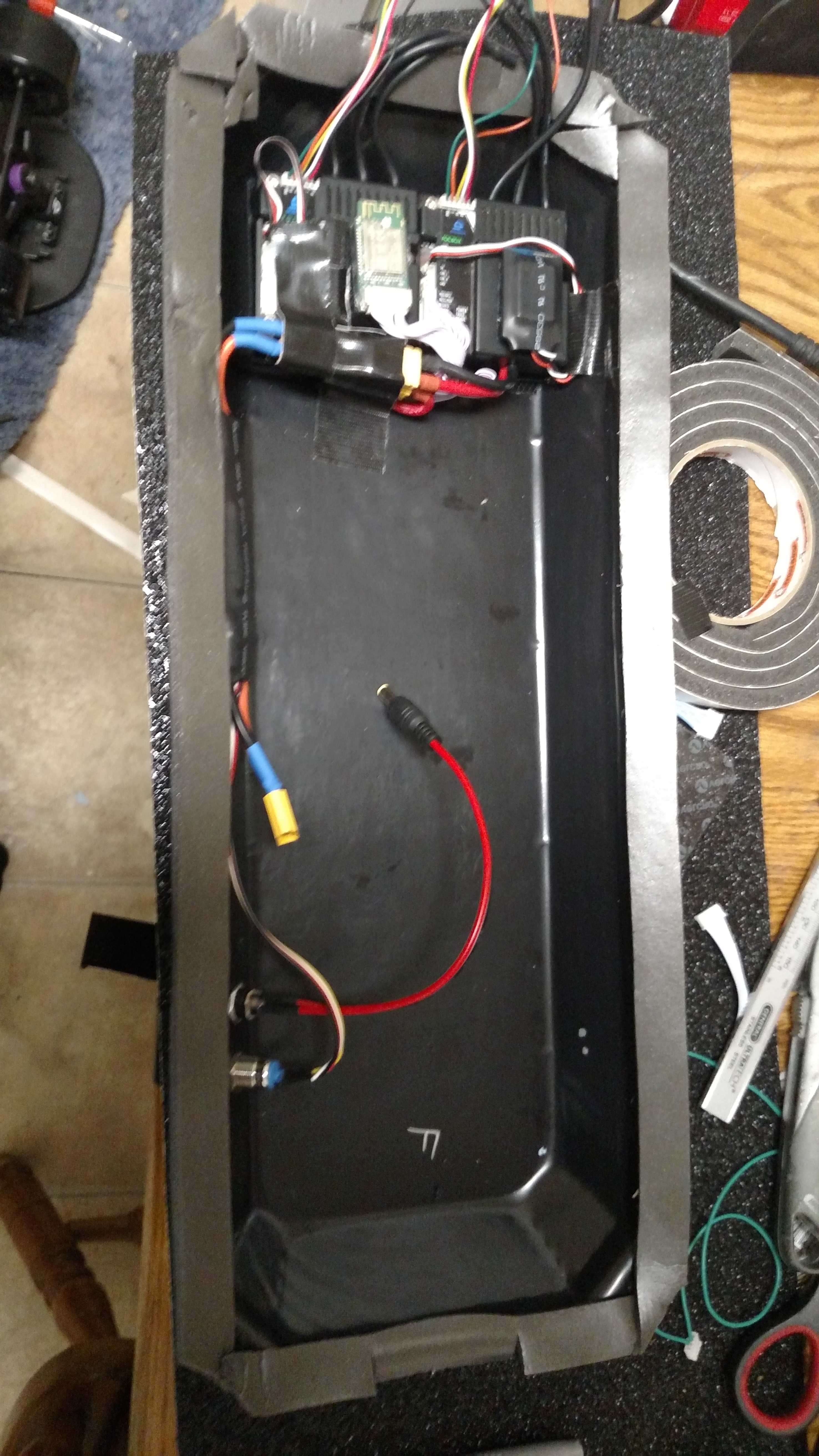

After that lined up the enclosure which was super easy as I filed down the top and bottom so that it fit perfectly within the raptor base plates. Drilled the holes and then started getting stuff in the enclosure. I decided to put everything in the enclosure itself. I know a lot of people are against it but w.e I like it that way and its bolted through the deck. It’s not going anywhere. Also I used industrial strength velco to hold everything inside. It can hold up to 15 pounds so I think a battery and 2 focboxs are within its abilities. I used some frost king window sealer foam to kinda weatherproof the enclosure. I’ll RTV it sooner or later.
Now I remember asking @Psychotiller if his 10S3P pack would fit with dual focboxs and he said “Plenty of room”. Man was he not kidding! It was super easy to get this all to fit nicely.

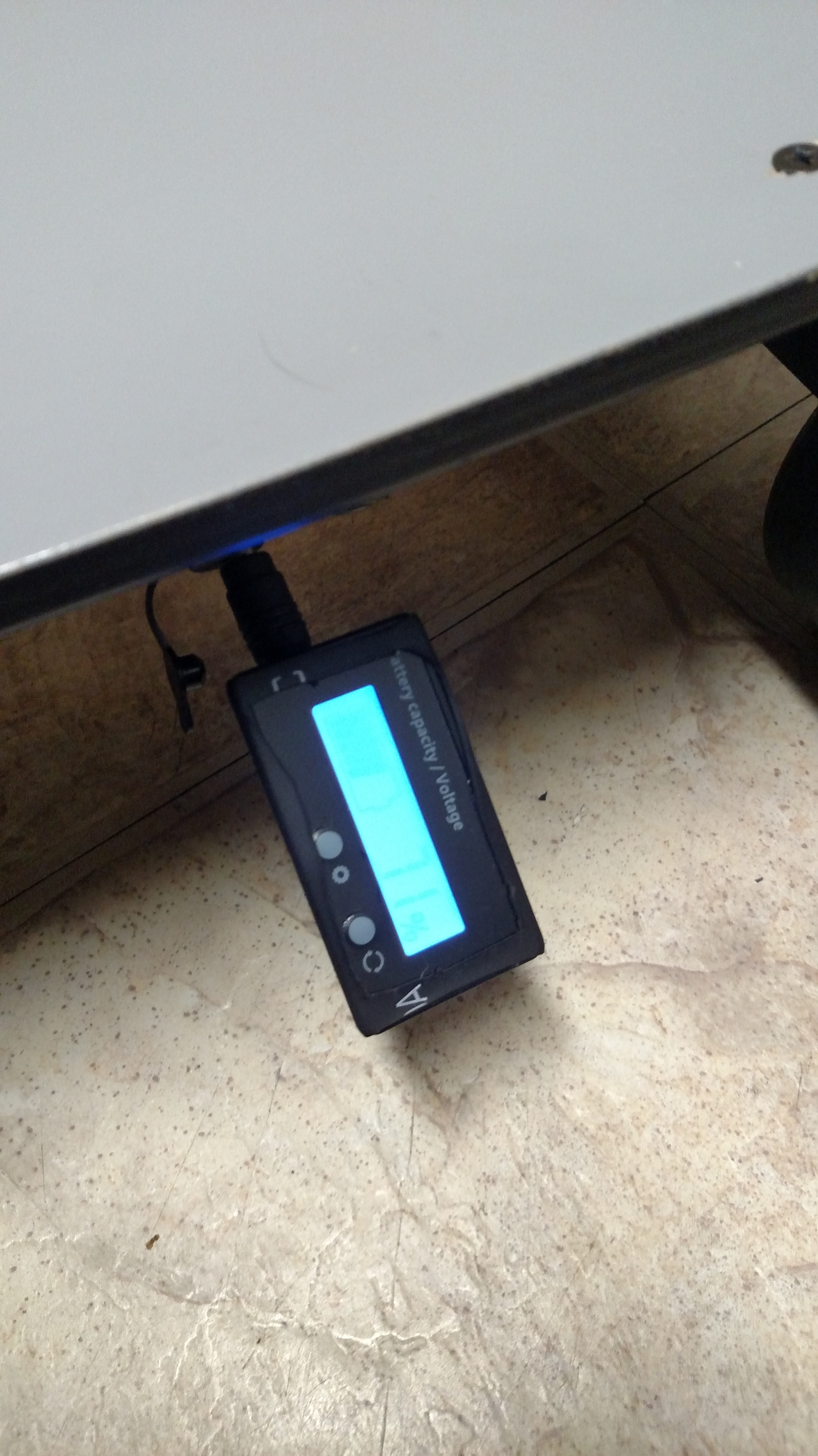

For this build I decided I didn’t want to drill the enclosure for a voltmeter and decided to do what @b264 does and made a portable one. It’s awesome and I loved not having to drill another hole in my enclosure too.

The next part was setting up the vesc’s. I ran into an issue half way through though running hall detection. Like the jack ass I am I wired the jst connector upside down. I had the pins reversed, so I had to redo those. Re-ran detection and BINGO! I was done or so I thought and went to bed. The next morning after I tightened up the enclosure the damn sensors were all fucky again so I hot glued them in place not a single issue since so far…

I prefer old school bolt pattern!
Well apparently Jason doesn’t as the raptor 2 trucks don’t have them haha.
Awesome build
They do have old school, they don’t have the smaller new school pattern
Hmm, Not sure, I guess I have it mixed up? Either way it it didn’t fit on the Tayto in any position. On my Landy evo I run the largest size with caliber base plates so I was pretty thrown off when I I tried mounting it on the Tayto as only the little holes lined up.
I’ll edit the post. thanks @Sender

Love the no voltage gauge. Less holes, less things to break, and as you learn your board you’ll find you rarely use it anyway. But having it in your pocket cures the range anxiety, even if you don’t use it.
Yeah I rarely do, generally only on group rides. This will be a whole new experience for me as my other battery is a 10S4P 30q. So I’m gonna need to get a feel for it’s range so I’ll probably use it a bunch at first.
I removed the meter from my board as I went with a new enclosure, and I can’t say I miss having one on there. Looks a lot cleaner without it.
You should do a write up of how to build one.
Yeah that’d be dope. @mmaner has a 3D printable enclosure for it too.
I think if @b264 does a write up tutorial. @mmaner may need to start taking orders for the enclosures.
Great build! Looks really stealthy.
I always have just used Bluetooth modules for voltage monitoring. Super simple, no additional pocket items.
See I’d love to do that, but the metr read my battery wrong all the time. I never knew how to set it right so I gave up using it for that.
I use this app instead with just a regular hm-10 module.
As long as the modules are legit this app works pretty damn good. :grinning:
That said, the @b264 pocket volt meter solution is a great way to go as well. :smiley:
It’s really easy. You need a barrel charge port and a pig tail, both 2.1 or 2.5 mm. Then you just wire them positive to positive and negative to negative with the volt meter wired in the middle.
