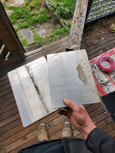

Because the esc is going through the bottom plate now, the original box/deck bolts were going to be in the way, so I needed to come up with a solution…
Using the original holes and the first part of the riser, i’ve housed some offset nuts and bolted down an aluminium plate. A new riser will sit on that and let me bolt my new plate down to the offset nuts.
Cutting these plates was ok the first time… kinda sucked the second time :rofl: the 3dp jig is awesome tho.
