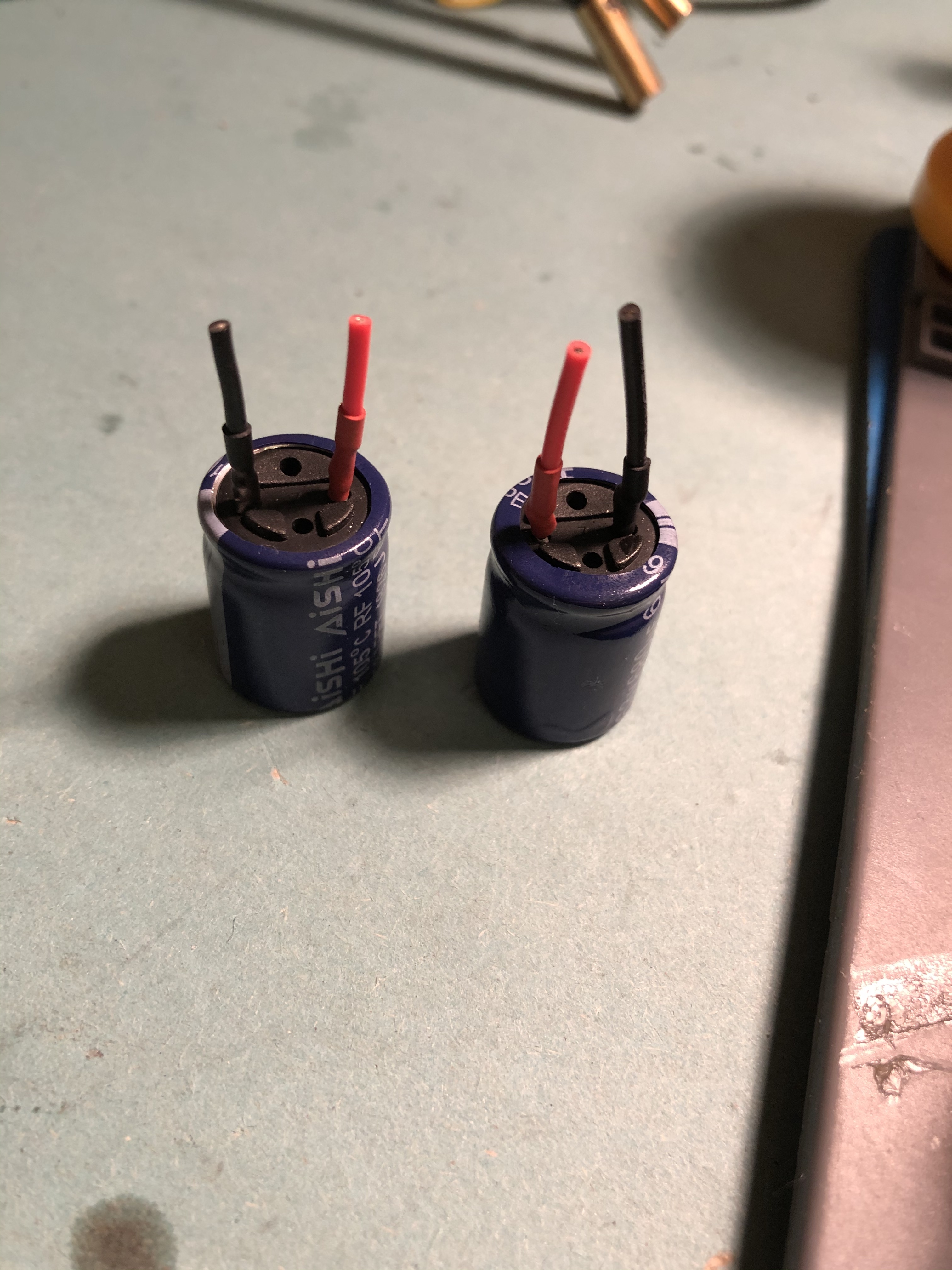

If anything, add caps on the powerleads, wont hurt :slight_smile:
I thought about that as well from the first time you mentioned it :sweat_smile::wink:
Still need to find out which ones I need exactly.
The higher voltage the better(and more expensive) 500-800uF should be enough.
If you parallell two 470uF that will equal 940uF f.e
And just cut the main power leads isolation a bit and solder them on?
Yeah that’ll do, try to isolate the solder spots afterwards tho, do it as close to the esc as you dare, you can bend the caps down to go along the powerleads afterwards.
Would seal the solder point up with some liquid tape after. Should be fine than.
Thx for the help. Will ask for some caps next time I’m in my electronics shop close by.

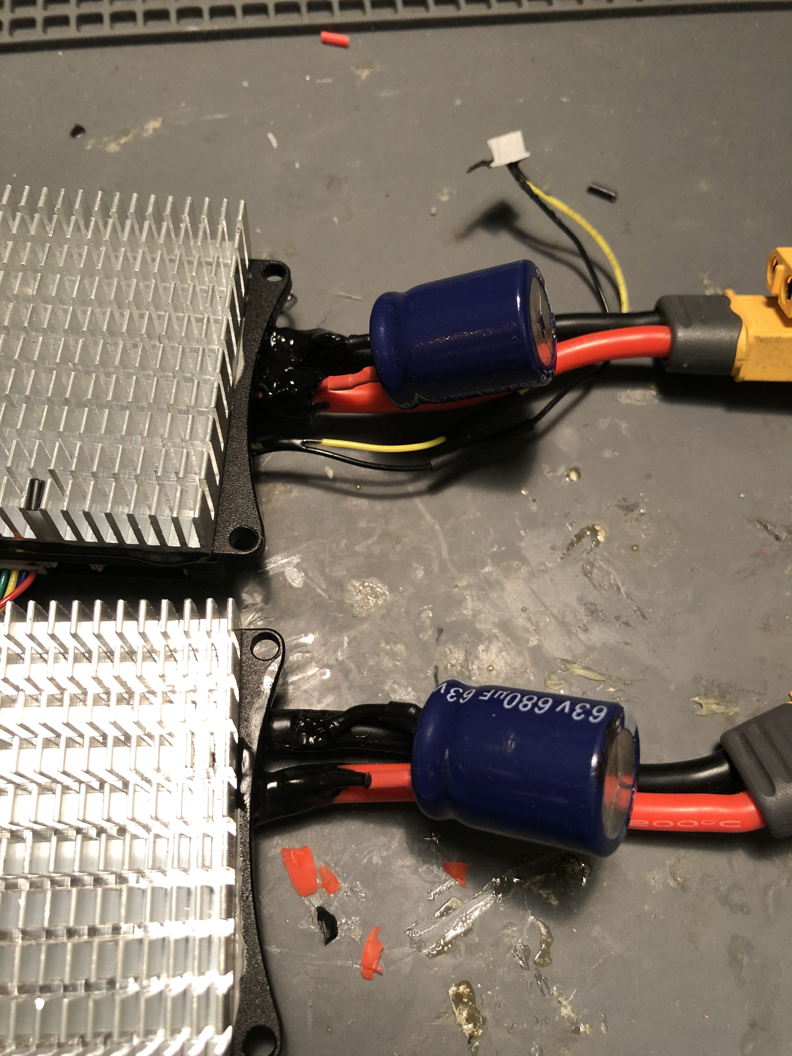

Reused some old caps I found on old escs.
@linsus any constructive feedback on that installation? I think better than nothing and as close as I could get them as I need to bend the main power leads later 90 degree.
Should do fine :slight_smile: Try make sure they dont vibrate too much once inside an enclosure, if something breaks on your escs, itsbound to be those caps. They dont last forever sadly
