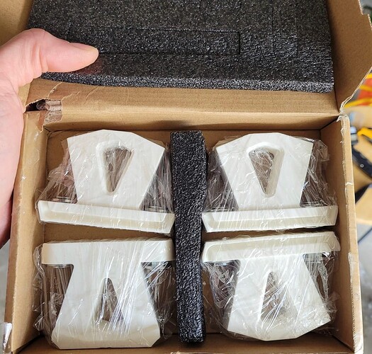

The Singularity™ bushing design for Channel trucks.

Propel endeavor one piece bushings:
So it’s like a hydraulic spring?
Fwiw Hunter board now has a one piece bushing and Mario told me it is much better control wise than the old standard style longboard bushings
That is one way to look at it. Urethane has tremendous load bearing capacity and if fully contained, a 10a material will support the same weight as a 95a material since like water, it does not compress. If it is given some place to go, the 10a will squirt out like a watermelon seed.

This Hunter Board?
Yeah that’s the old design, the new one is different
